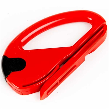

If you "have to" cut on a roller...
...use one of these!

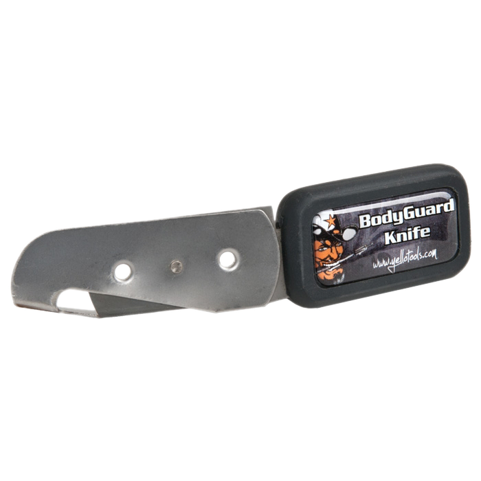

Actually, this may be the best tool I ever bought, you can either use
to cut the laminate and the backer paper... or just the backer paper
if you're starting a laminate job.
