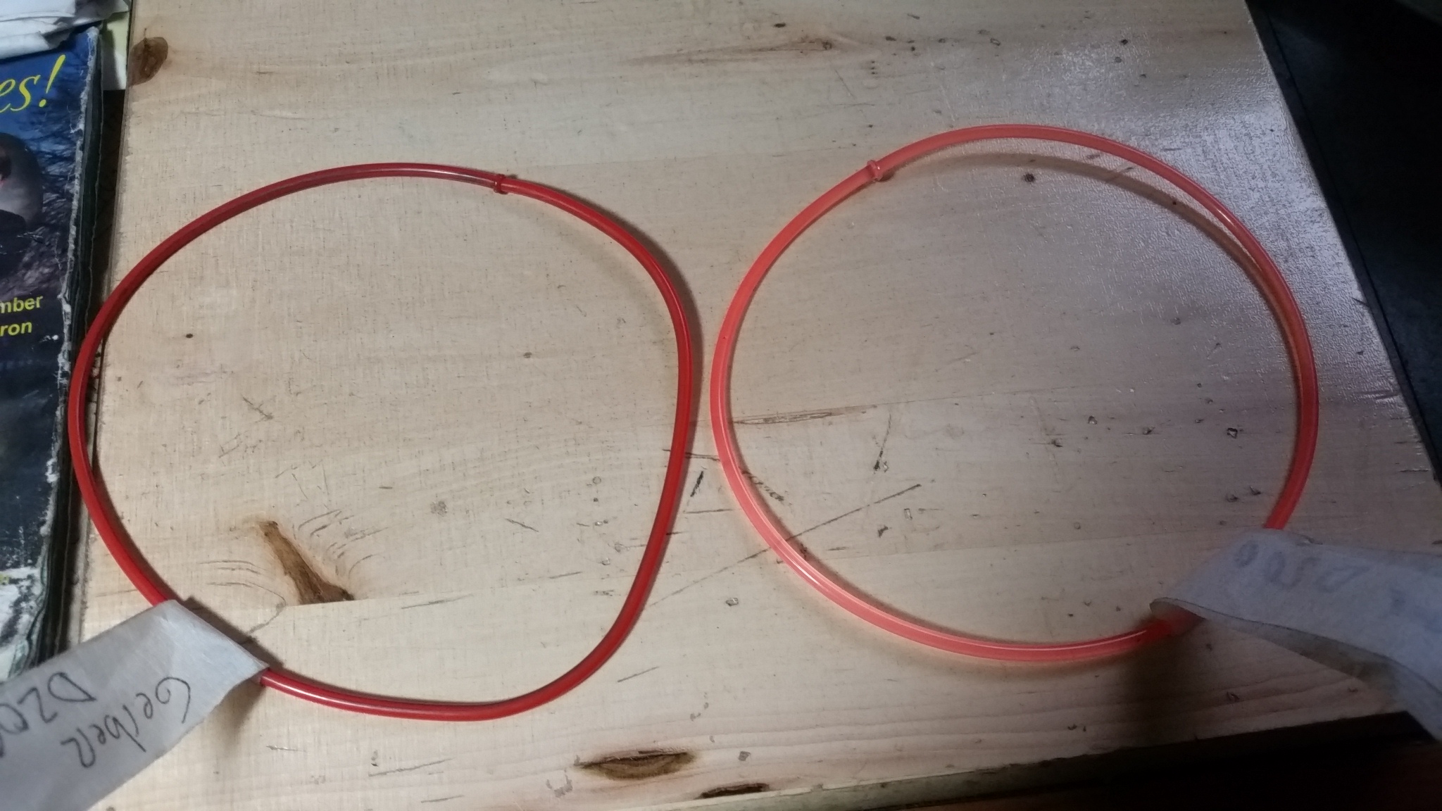

does anyone know the OEM length of the engraver head spindle belt..mine just broke..it measures 16in but could be stretched due to age.
5041shelby
Nevermind..i make my own belt and fix brokebroke belt
