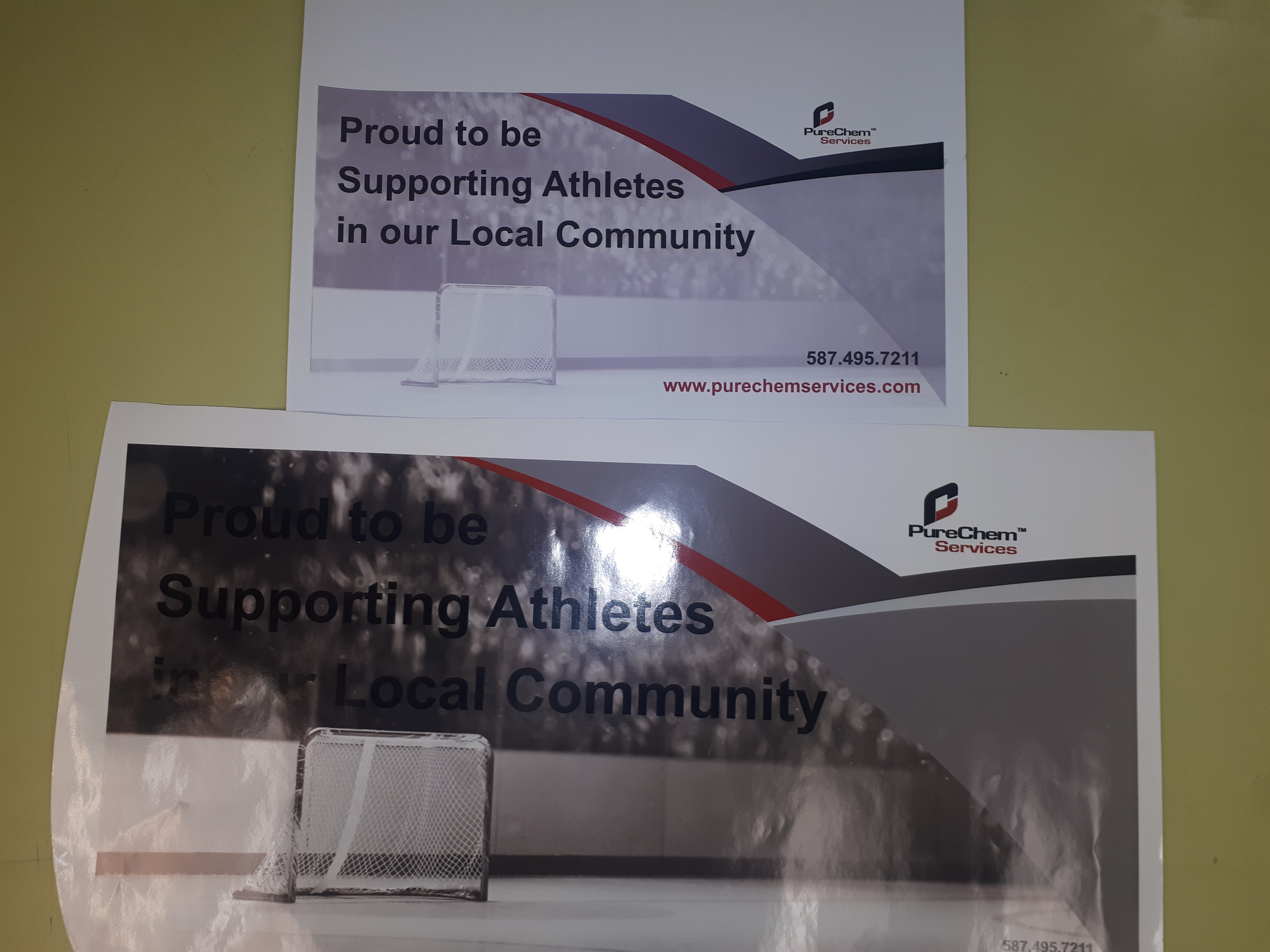

I have a Mimaki CJV 150-130 using SS21 with Rasterlink Pro 6. I cannot get my grey colors to print grey -- they come out brown. I had a 4 foot by 8 foot sign to make off a pdf, imported into Corel Draw X8. Everything looked good. When I went to output it, I could see the decal go darker and that's how it printed. Sent the file to another sign company close by and they used a Roland printer and it worked perfectly.
This is the only issue I have with this printer -- the greys just won't do grey!
I have seen other similar posts but and tried some recommendations but just not working

It's likely got some yellow and magenta in the CMYK mix that the profile is exaggerating. Also looks as if the transparent white overlay is not rendering properly. Saving as a tiff might be a quick fix for the last issue.

I had to change the printer profile in the Rasterlink program to
CJV1504CSS21_Ave-2000_F107361.cc
This solved the problem immediately -- if you go online to Mimaki color profile (can't remember exactly -- but google it -- it lets you download more profiles -- pick the one with the correct ink/printer SS21 CJV150 for me. If you have trouble with this contact the supplier who sold you the machine and they should also show you how to do it -- I can't remember exactly how I did it but it worked and I am sure this was the way to do it
