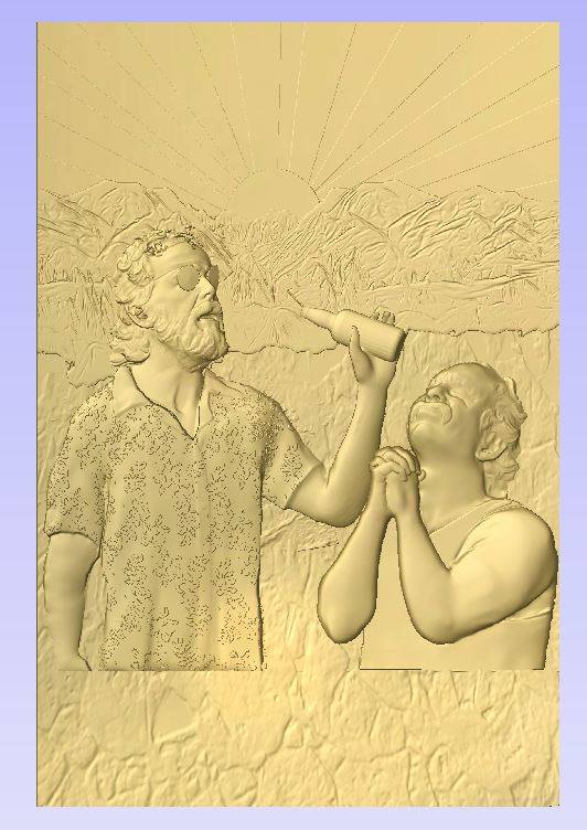

Made this for a new restaurant in Las Vegas..."Tacos and Beer"..
Below Cheech and Chong are the beer taps..
Made with Sculptris and Aspire.
4' x 6'
