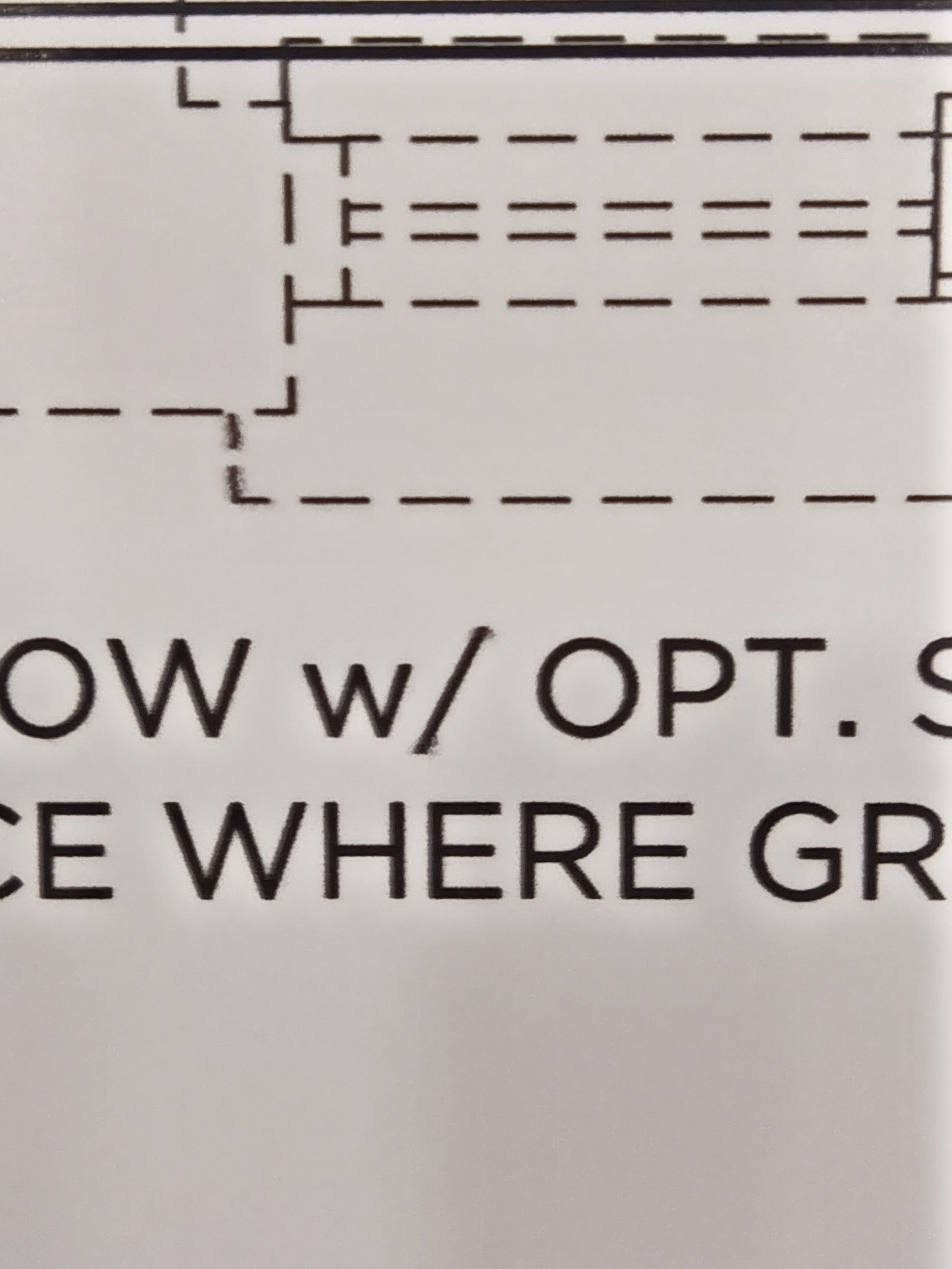

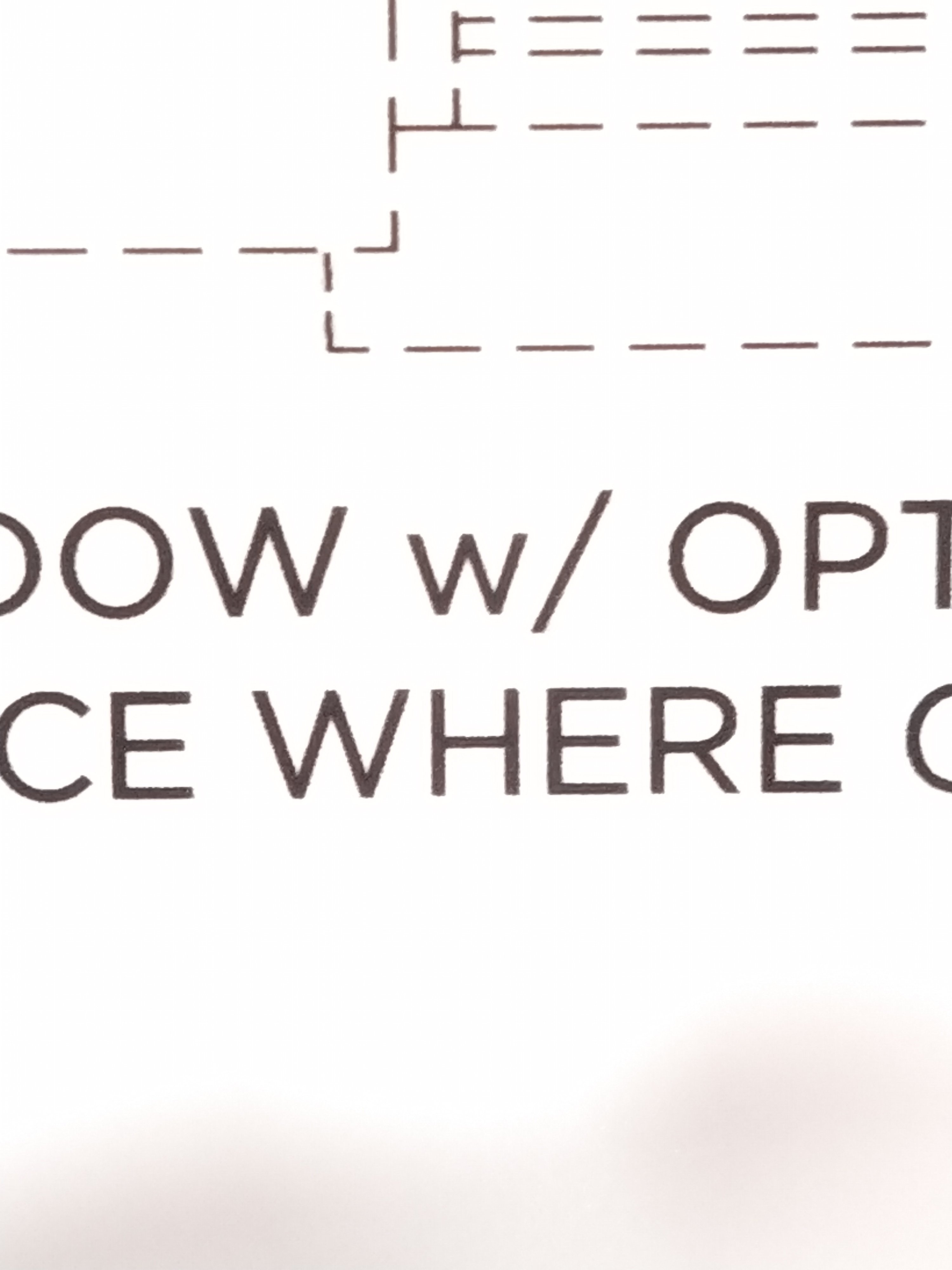

We have a hp 115 latex with a issue on print, I though it was a profile issue , but it seems to be related to size of media, we can print on 30 inch material no issue, but same file on 54 inch material there is a blur to prints, anyone with idea on what it might be? photo shows blur printed on 54 material and a print on 30 inch material , same profile etc on both, thanks for any input

I print this media on my 115 setup all the time. Cant say I've had this blurry looking issue. The grainy-ness I can see on the 30" print doesnt look right either in my opinion. I would replace the print heads. Every time I have ever replaced print heads the machine runs like new.
