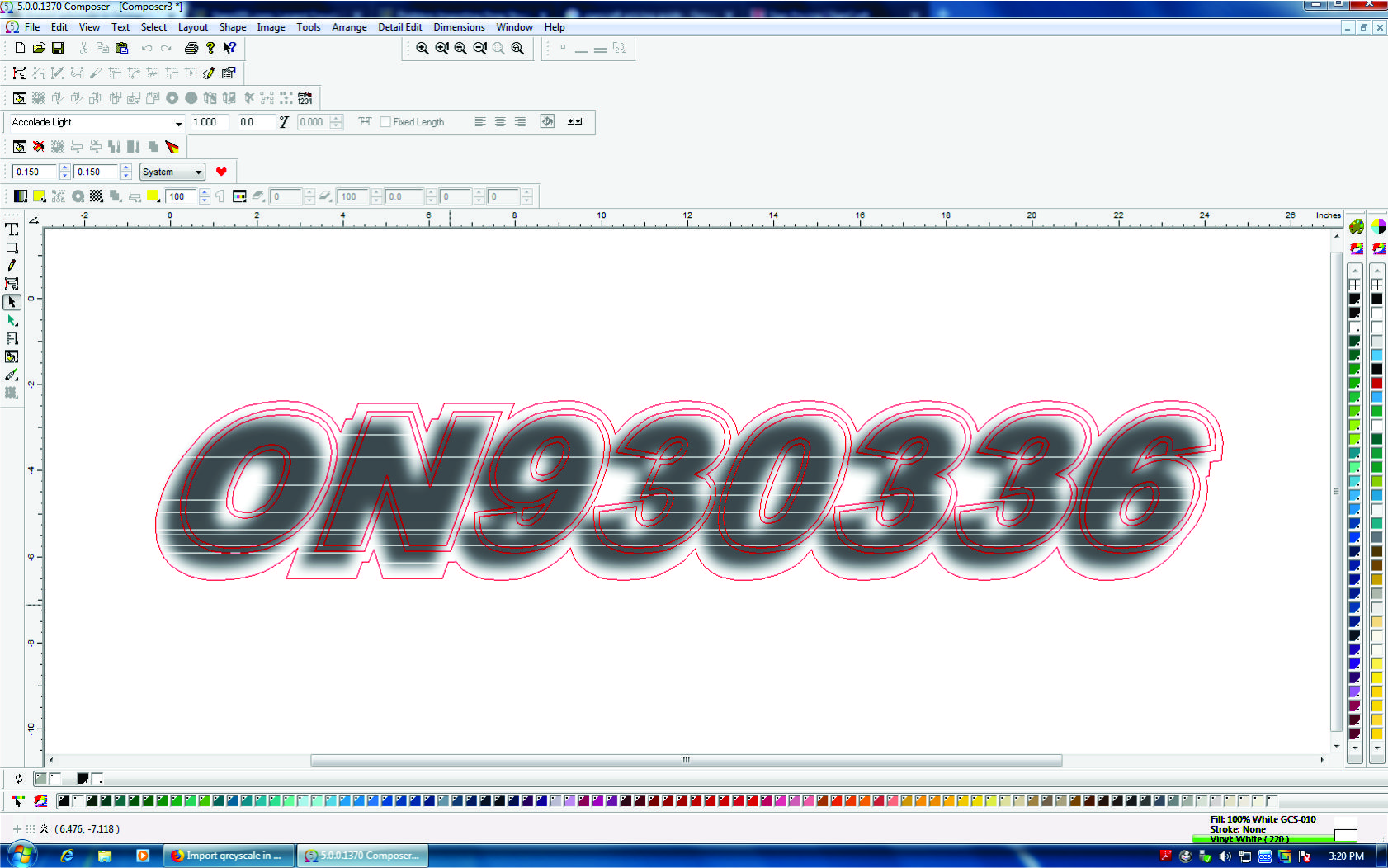

All of a sudden when i import my eps from CorelDraw x8 i get lines across my drop shadow
What am i doing wrong ?? I tried to redraw it a couple of time and still the same
Thanks
Yves

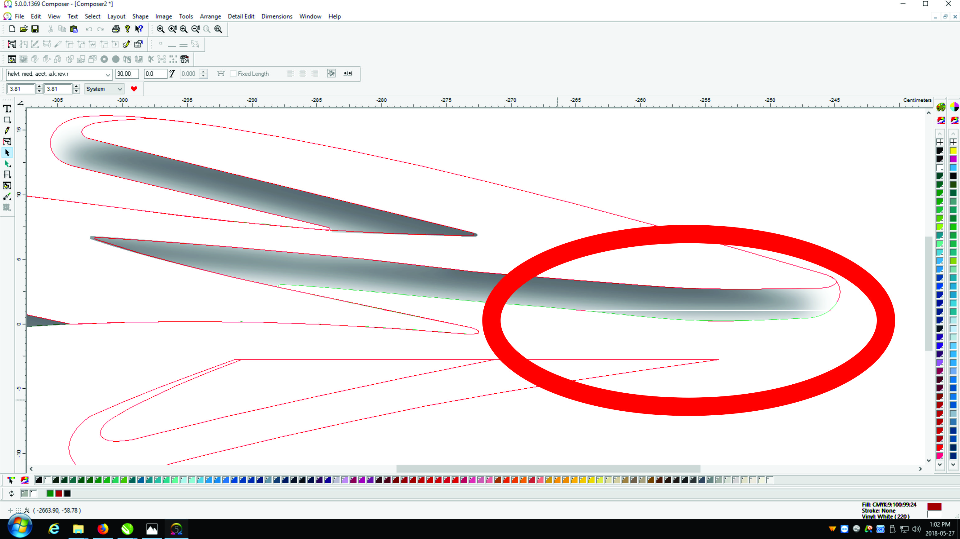

I also tried to convert drop shadow to BMP then export and i still get the same
