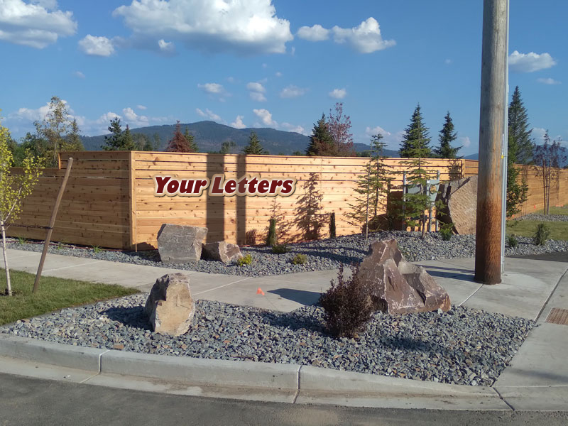

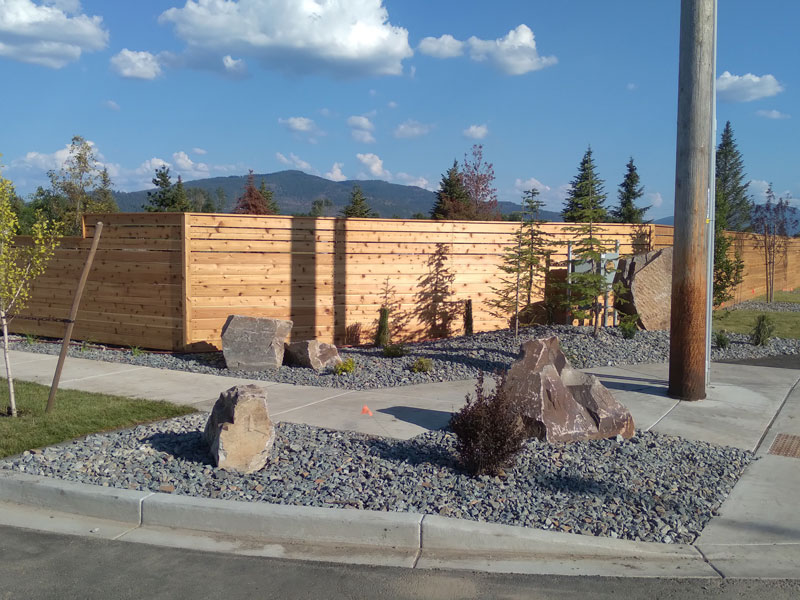

Hope I didn't already post this here, I couldn't find it if I did. I've been bouncing back and forth with a client for months on a residential entry sign project. What they're wanting is to install halo lit letters directly on a cedar plank fence. The back side of the fence will eventually be someone's private property, so having any wiring or hardware on the back could potentially be a problem along with access. My customer keeps referring to it as a "monument sign", which it isn't, and I've tried to steer them against installing the letters on the fence and produce an actual standalone monument sign, but they're all over this fence idea. I think it's a bad idea. Has anyone ever done anything like this? What would you propose to the client?
A couple pics attached, one showing an example of similar signage, though not on a private fence. The other is the actual fence.
(I'm laughing looking at this again...between the huge boulders and the growing trees the signs won't even be visible in a few years)
unclebun
Have them build a section of "fence" in front of the fence that is built tighter and stronger than the fence. More like your other photo. Put the letters on that. Wiring and ballasts are then hidden by the actual fence, and not subject to something down the line on the fence pulling it off plumb.

I wouldnt do it...fence will look like crap one day not to mention shrinking of wood and the view from other side. BUT customers know best so price that thing up
MikePro
i've put reverse channel letters everywhere. ...even on rooflines that have no backwall to shine light against (i know rite?)
there can be ways to cleanup/hide the power&mounts, aestetically, from the from & back, or even make a clever raceway that the letters mount-to that completely runs the power to the side of the fenceline.
if it were me, and they were hellbent on RevCL, I'd make a pan with a finish similiar or beautifully contrasting to the wood pattern of the fence, and just mount the whole thing with lettering already assembled&wired to the fence or onto legs set in concrete in front of it so it floats in front-of the fence without requiring to be supported by it.
this way, you won't have to tip-toe around fiddling with someone else's side of the fence, whilst also not turning the backside of your signage into a spotlight that shines into the neighboring property.

Besides fence boards not being very solid, looking at the gaps between the boards on the fence, the private lot behind it is gonna get a lot of streaks of light shining through using halo's. Don't know if that'll be an issue, but something else to consider. Putting another structure in front of it would be the best, and the least PITA. Since they already have those in charge of permitting against them, passing on it is a viable option. I would never mount halo's or channel letters straight to cedar fence boards, but I love a challenge.
One option is lettering on a raceway where attachment points would be at fence posts hidden behind the fence, would be better than straight to the fence boards and be subject to warping and several other problems.
Another option, a shaped aluminum support for the halo letters covered with faux wood vinyl, less liability since the fence probably isn't fire rated. Attach to fence posts hidden behind the fence for support with standoffs. That way it's not mounted to flimsy fence boards, the standoffs will give the space you need behind for conduit & wiring, and give an air gap to release moisture to prevent fence behind from rotting/ warping. You can make/ assemble it at the shop (or my first choice, design it & sub it out), run your conduit & wiring, and just hang it like any other sign. And everything is accessible from one side.
Brilliant. Plus, you won't have light leaks into the unfortunate yard with the letters mounted to it...
