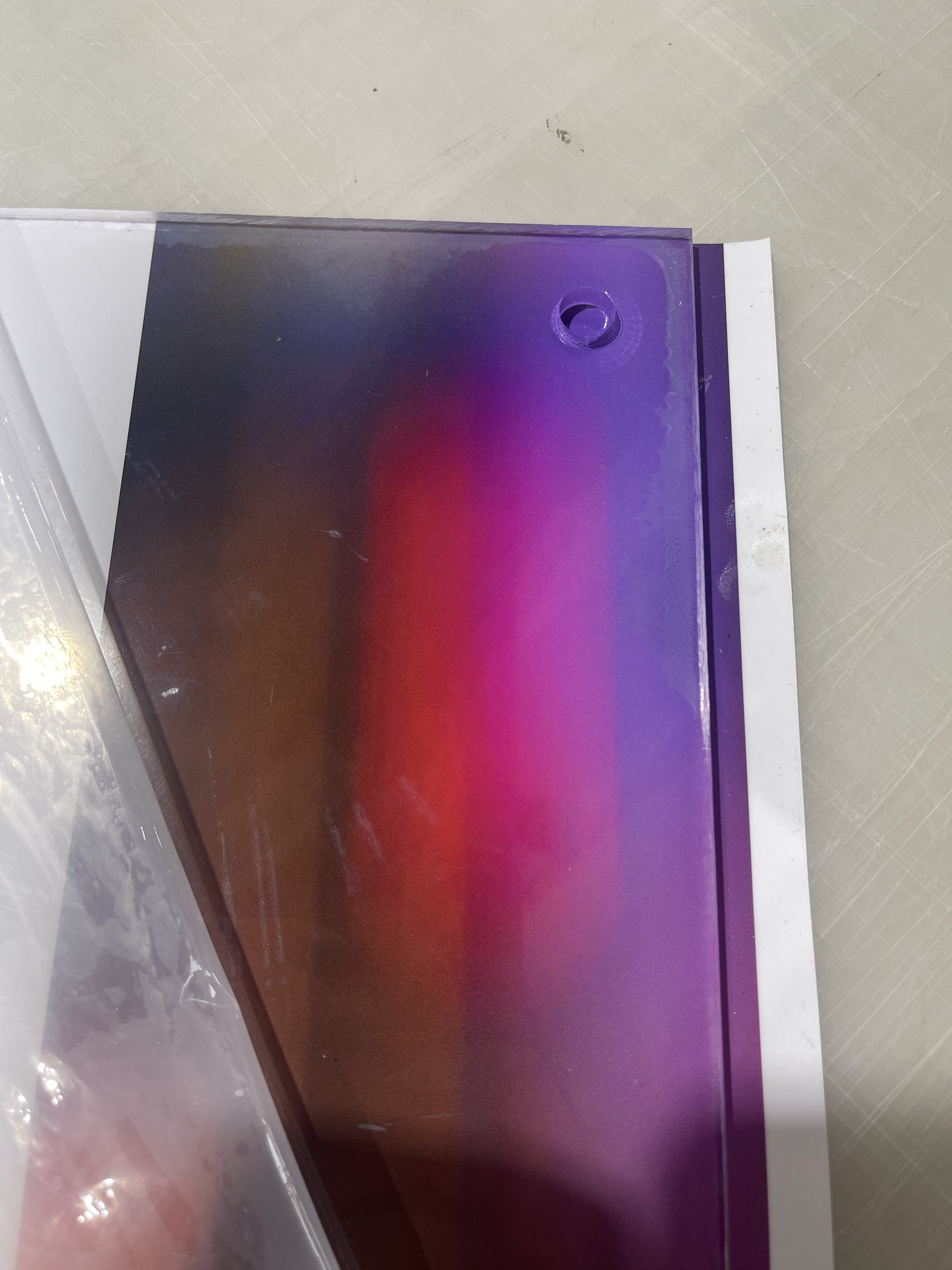

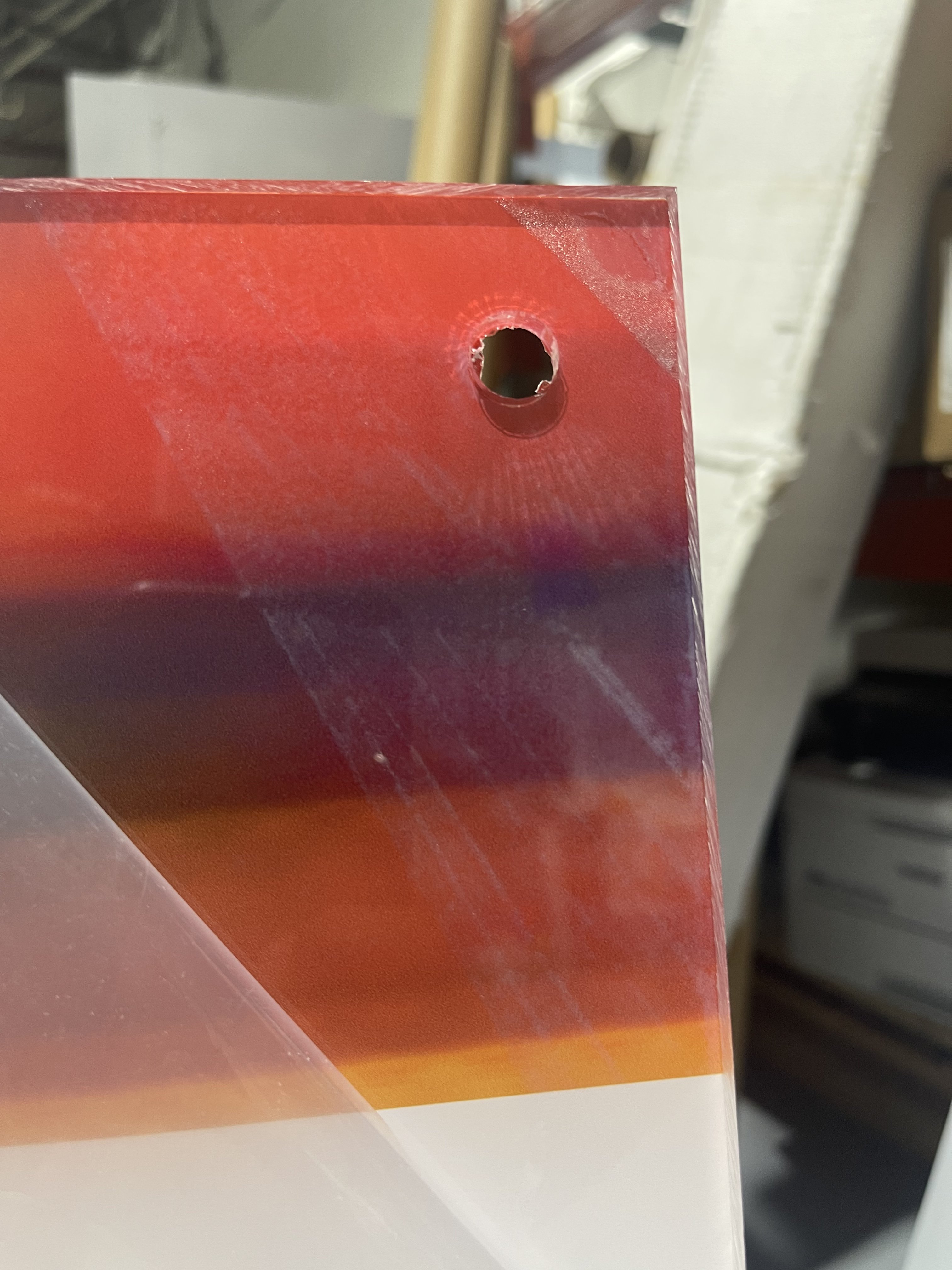

Issue wet applying clear prints on acrylic.
Rdhillo1
I have had this issue quite a bit where the edges look to have had the liquid soak into the adhesive(looks like ghosting?) I’ve tried water with soap (distilled with baby soap). I’ve tried rapid tac and same results.
I can usually get about 75% of them and always have to reprint 25% of an order.
I use a mounting table and I’ve used a laminator as well. I have been using a more cost effective vinyl from general formulations which I think could be the issue but I wanted to check and see if this could be an application issue.
Any help would be greatly appreciated

petepaz
why are you wet applying?
if you are using a mounting table or a laminator you really shouldn't need to wet apply, do you need to reposition it or move it for some reason?

Yeah, looks like it was wet applied and lifted, likely when someone moved it around the table to finish trimming. I'll usually let stuff dry thoroughly before trimming if wet applying.
I've done many reversed prints with a satin laminate to hide any such issues, arlon 4500g clear and arlon 3420 satin.

Also your squeegee is important for getting all the liquid pushed out. I use a Geek wrap suede for applying things of this nature.

I used to and was getting dust in them but I’m thinking that was more consist for me. I was told to wet apply so I have the opportunity to remove the dust if needed.

Yeh we were letting it dry and that happened. I was more concerned about the ones not on the edge. We had other that are like this untrimmed.
When you say laminate are you not putting a white backing on ?

No white backer, but usually it's black text on a donor plaque, not colorful artwork. They usually want to see the wall behind, but don't mind a frosted finish that they are looking through.
For wet applying, a fine mist spray bottle does wonders, giving you a misted surface as opposed to a sputtering of fluid that includes bubbles...

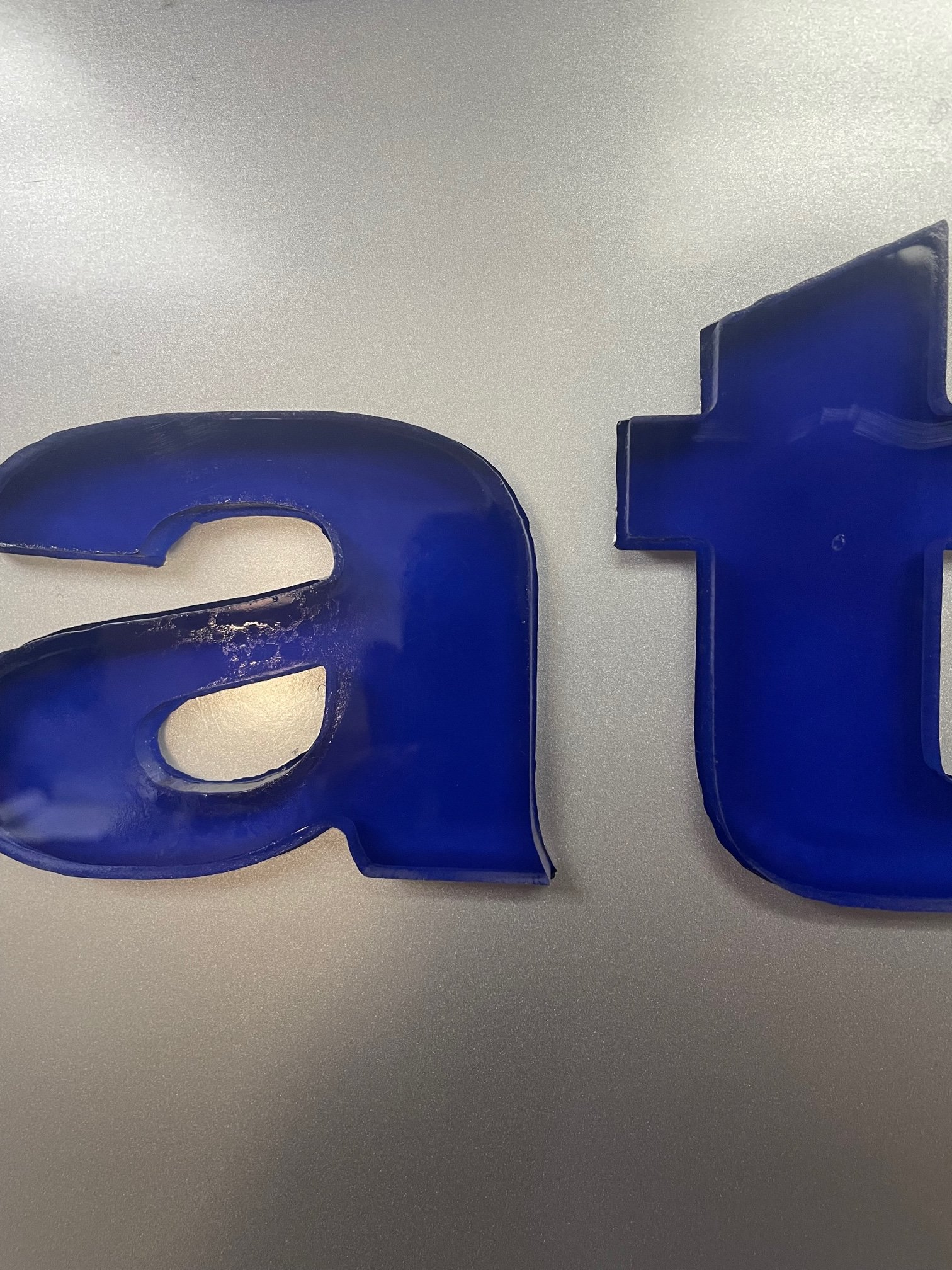

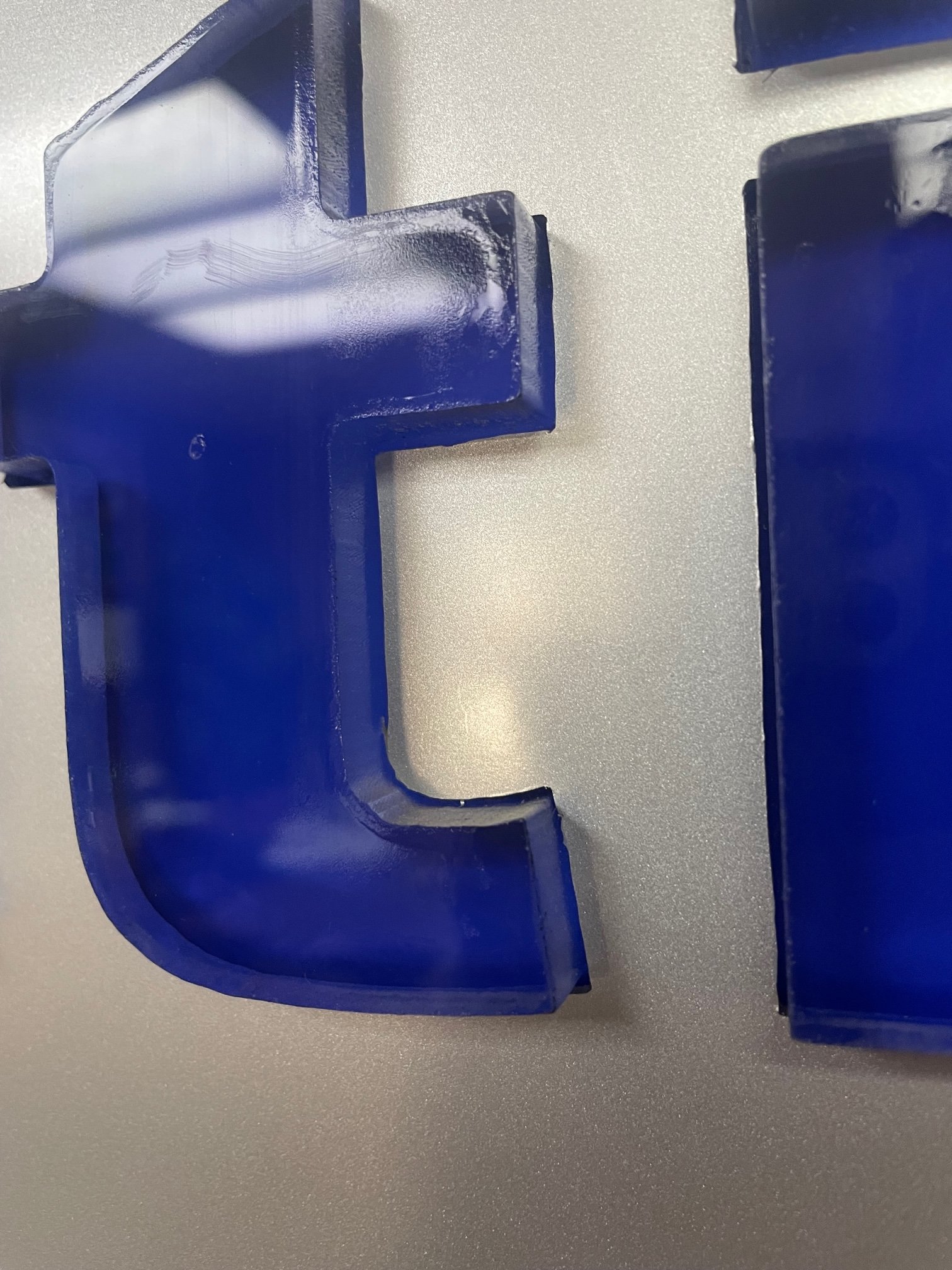

This also kinda looks like a flame polishing error, where the flame washed over the face and makes it look exactly this kinda wet. The second picture with the hard diagonal angle definitely looks like it was lifted and reapplied without more fluid. These are pics of a clear acrylic letter with cast vinyl on the back. The letters pushed through an acrylic face, so they had a lip to keep them in place, but the flame polishing with the lip caused the flames to lap up across the face more than the edges as intended. I ended up replacing the whole 3x8 because of this line of subtext, 3" tall letters, that the secretary could not get clean.
