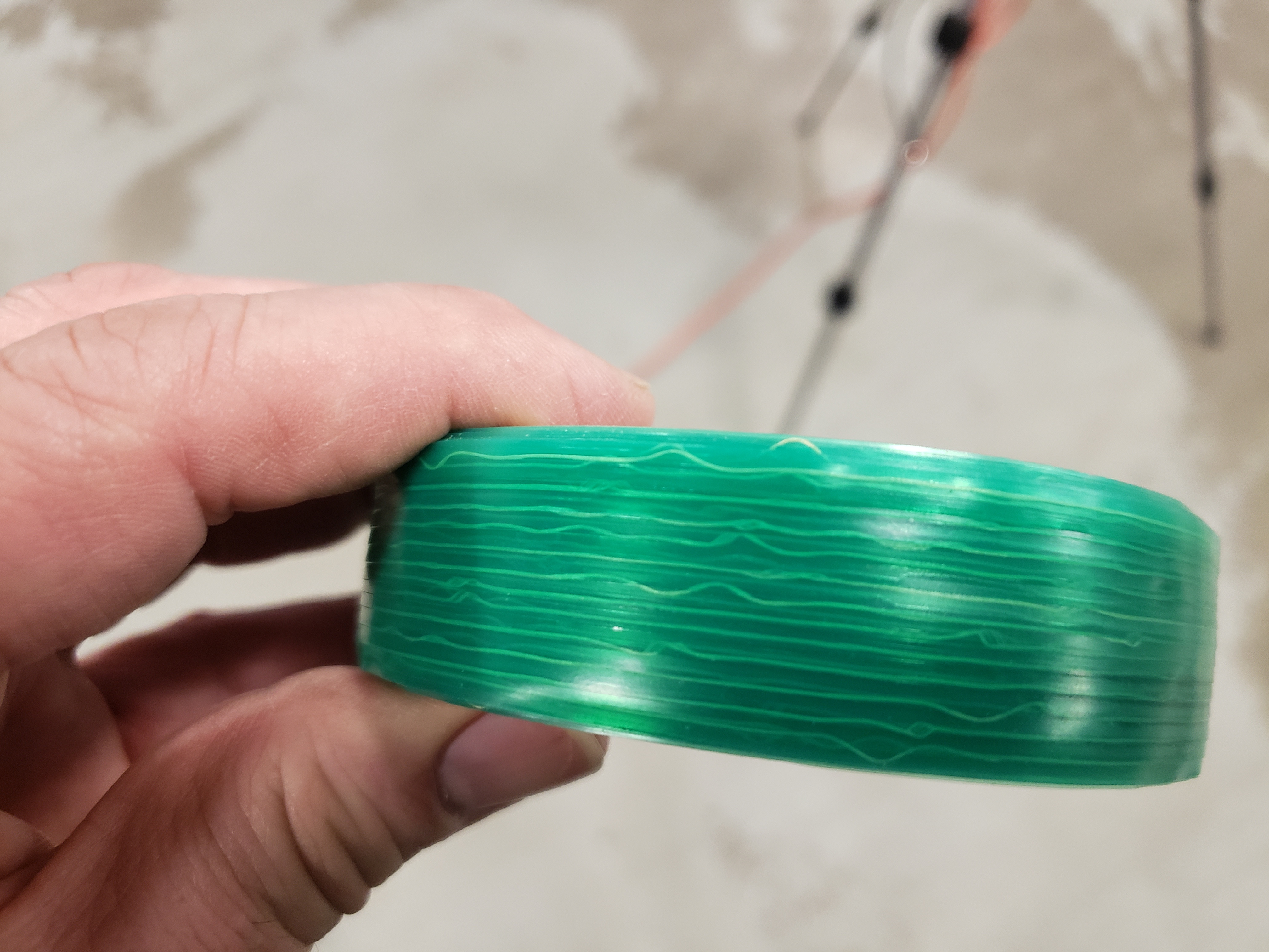

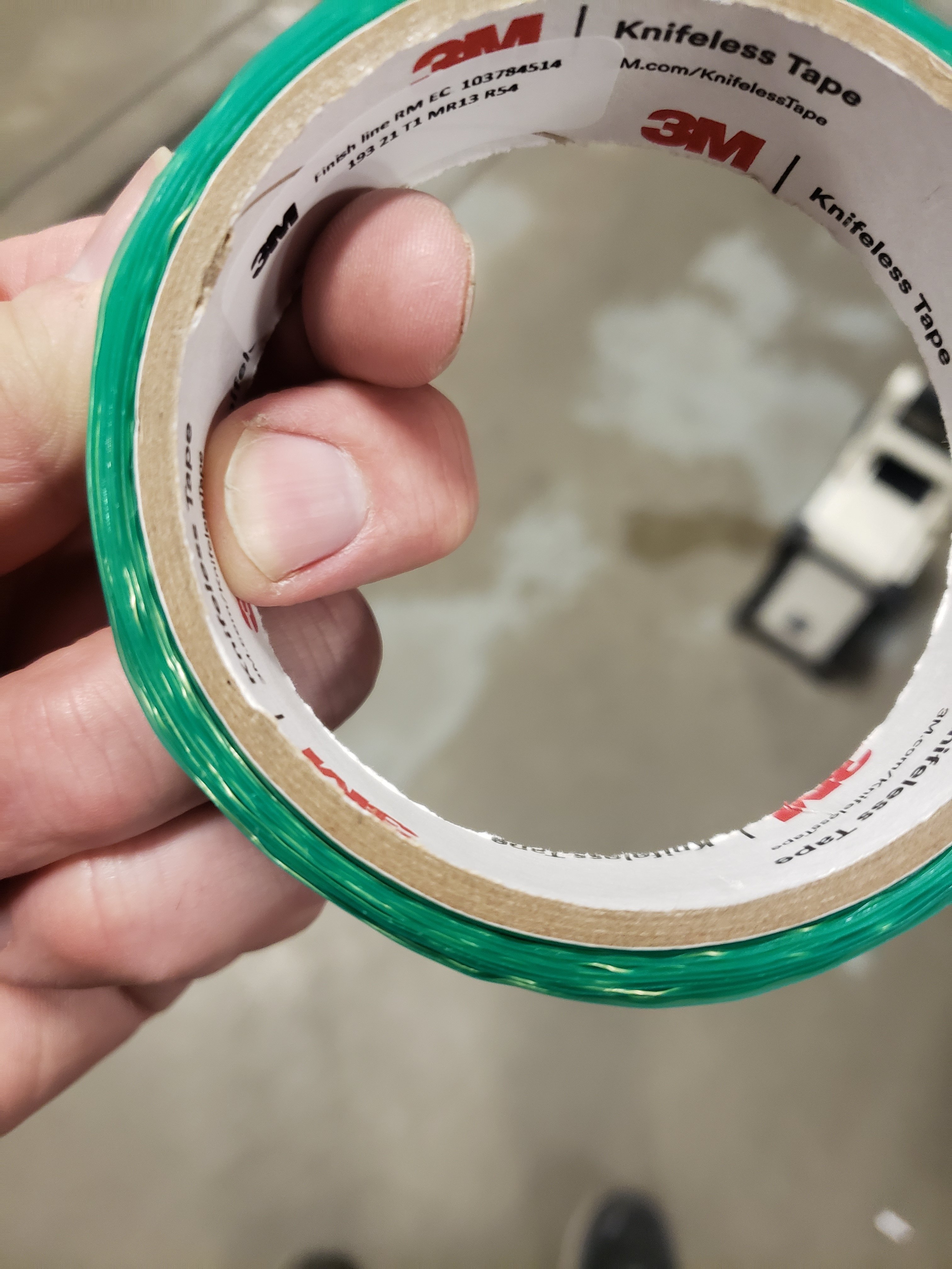

Ironically I just discovered 3 rolls of my own. All three have curvy floss (see pics). It doesn't seem like that would have happened due to age but maybe? EDIT: I guess it makes sense. The carrier tape would shrink over time but the filament would not. Duh. Still sucks.
