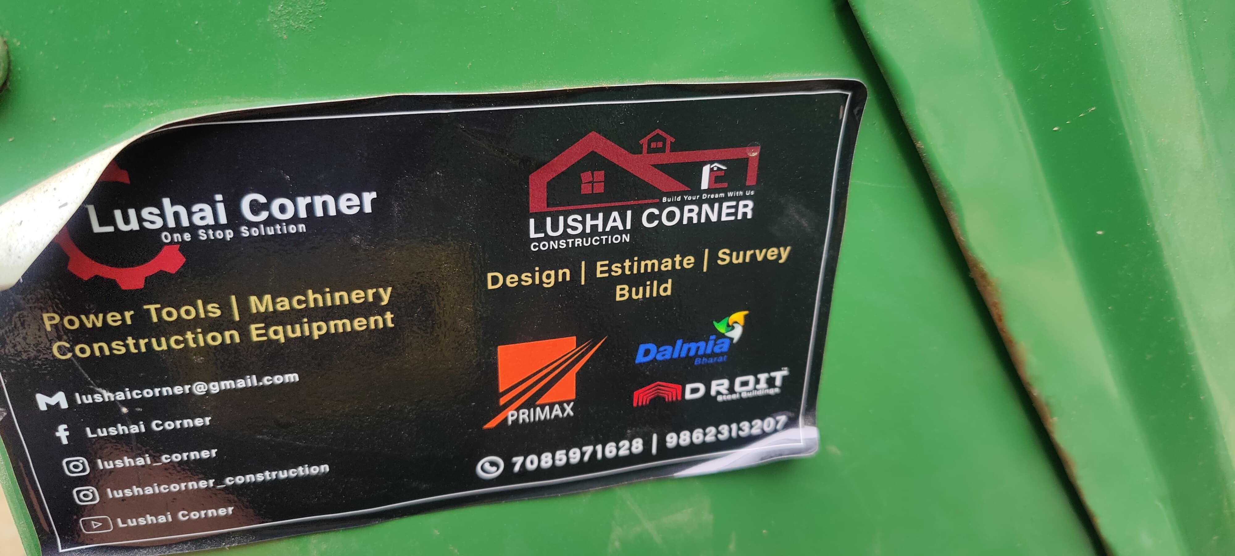

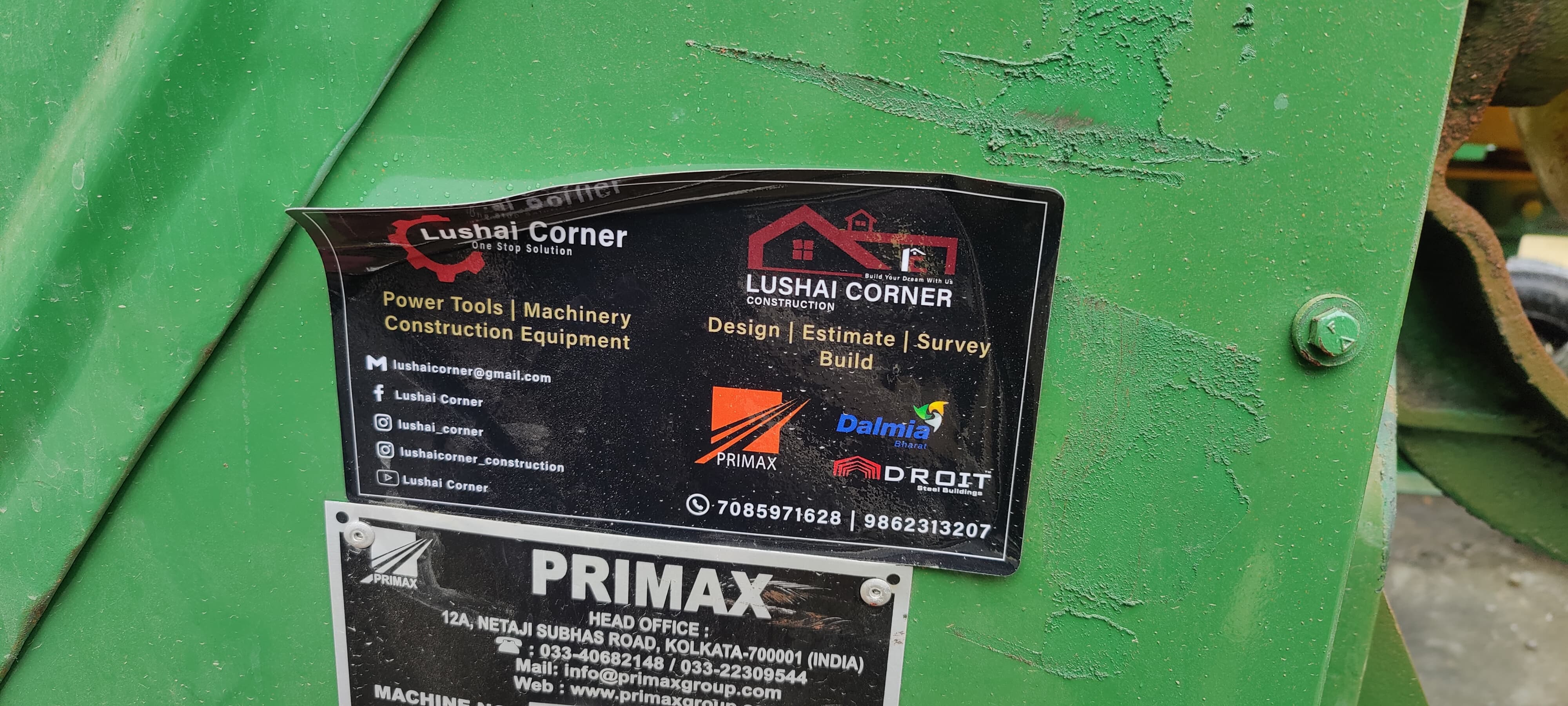

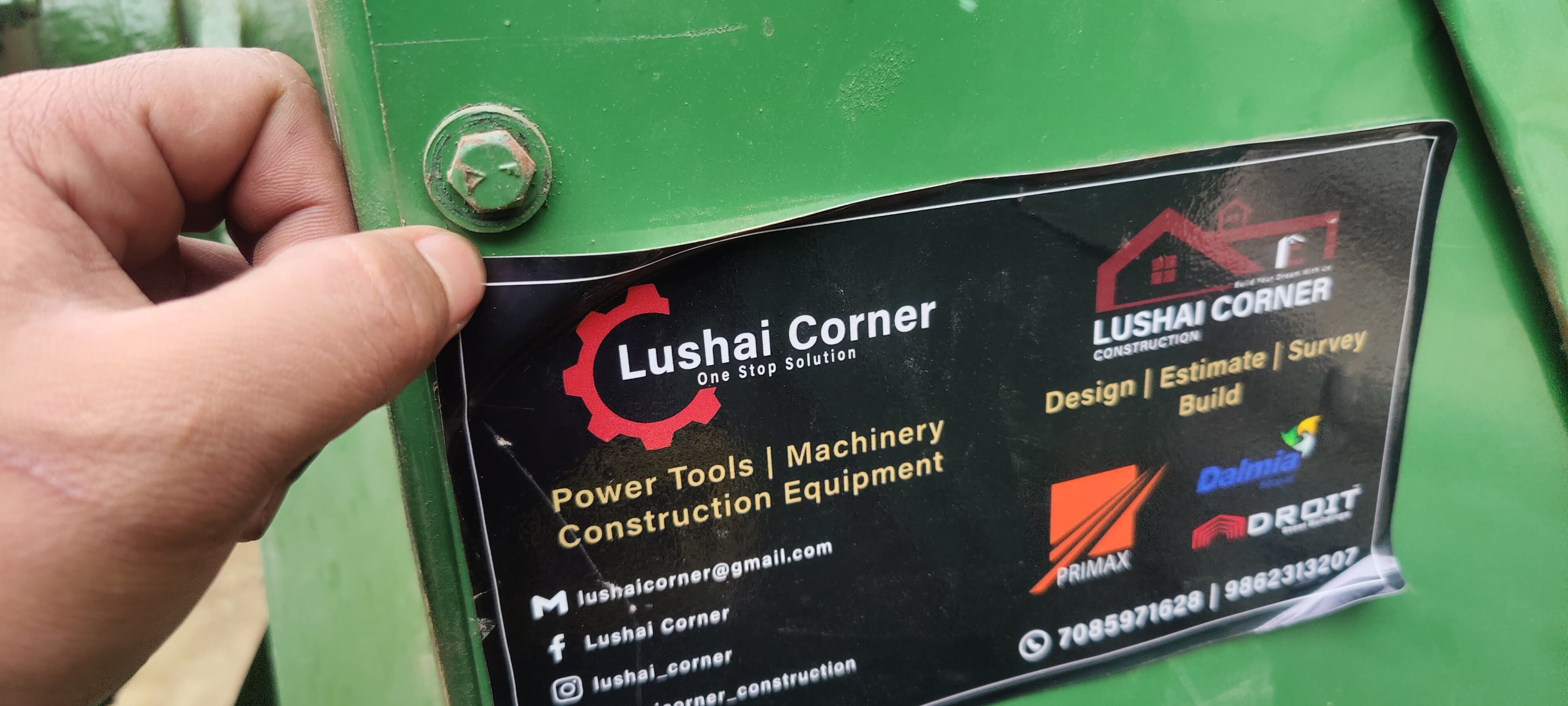

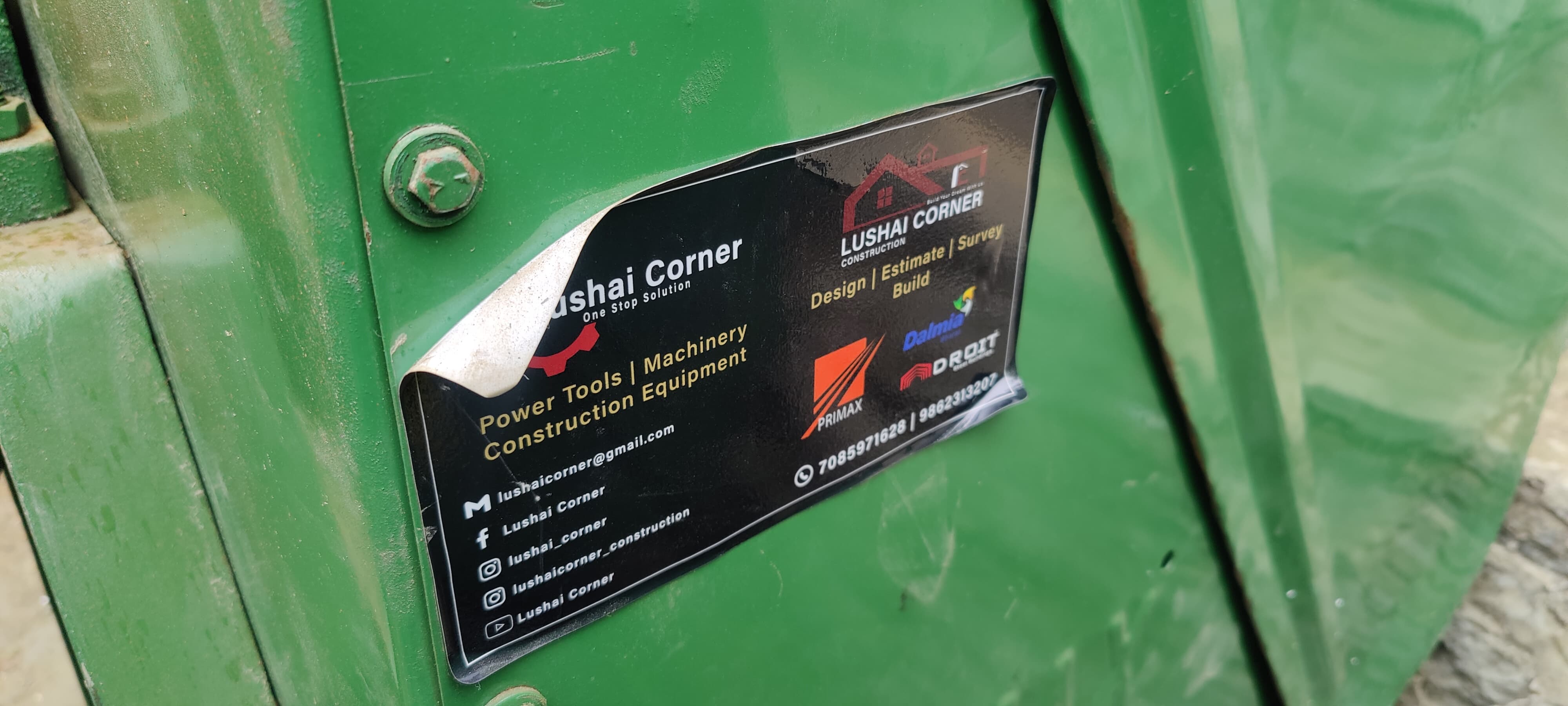

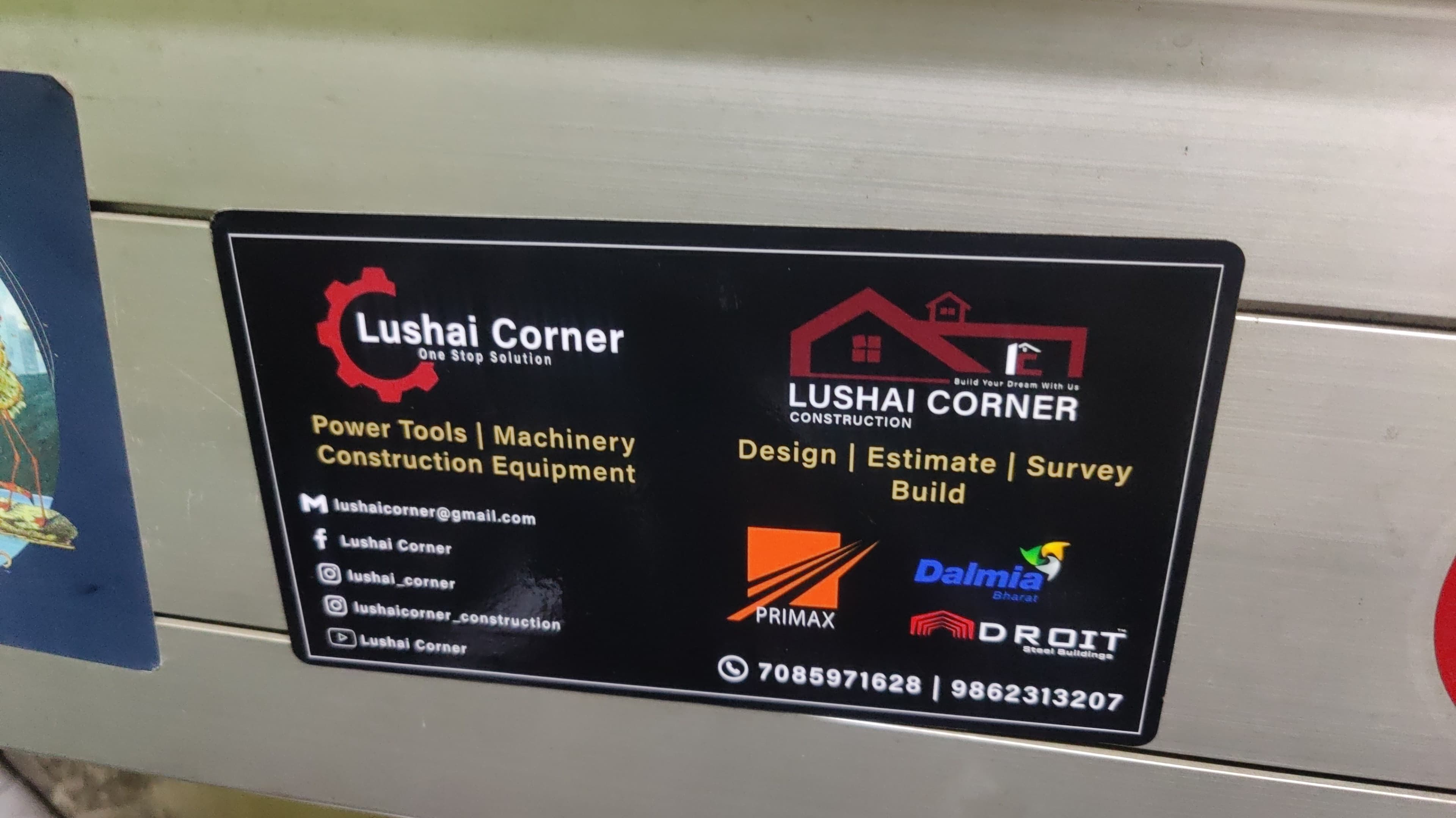

Hello guys, so last month i printed a bunck of stickers for a friend with solid black background, i used 3M ij 15 series and laminated it with the same vinyl series but transparent (vendor says it works the same as overlaminate in this entry level vinyl). So yesterday i visited my friend and he shows me the stickers i made for him applied on to a cement mixer 15-20 days ago, machines were all placed outdoor under the sun. The sickers were peeled off along the edges, it doesn't just peeled off it was even deformed/shrinked/ warped, you can see from the pic. Even tho they were outdoor it wasnt that sunny (older stickers i made for him with other printer are still ok). Back to the machine i used sc4670printer with the profile made by EPSON on the Epson edge, there are no professionals for custom profile so we used whatever the machine installer recommends. ij180 cv3 (6pass and 8 pass, red on 4pass is too dull thats why i went for the higher passes) is the profile that i used for this stickers. Could it be caused by too high density ink or adhesion fault? (Yes, I let them outgassed 7+ hours). The same sticker i applied on my machine (indoor) still sticks/adheres perfectly (picture attched for this as well).
