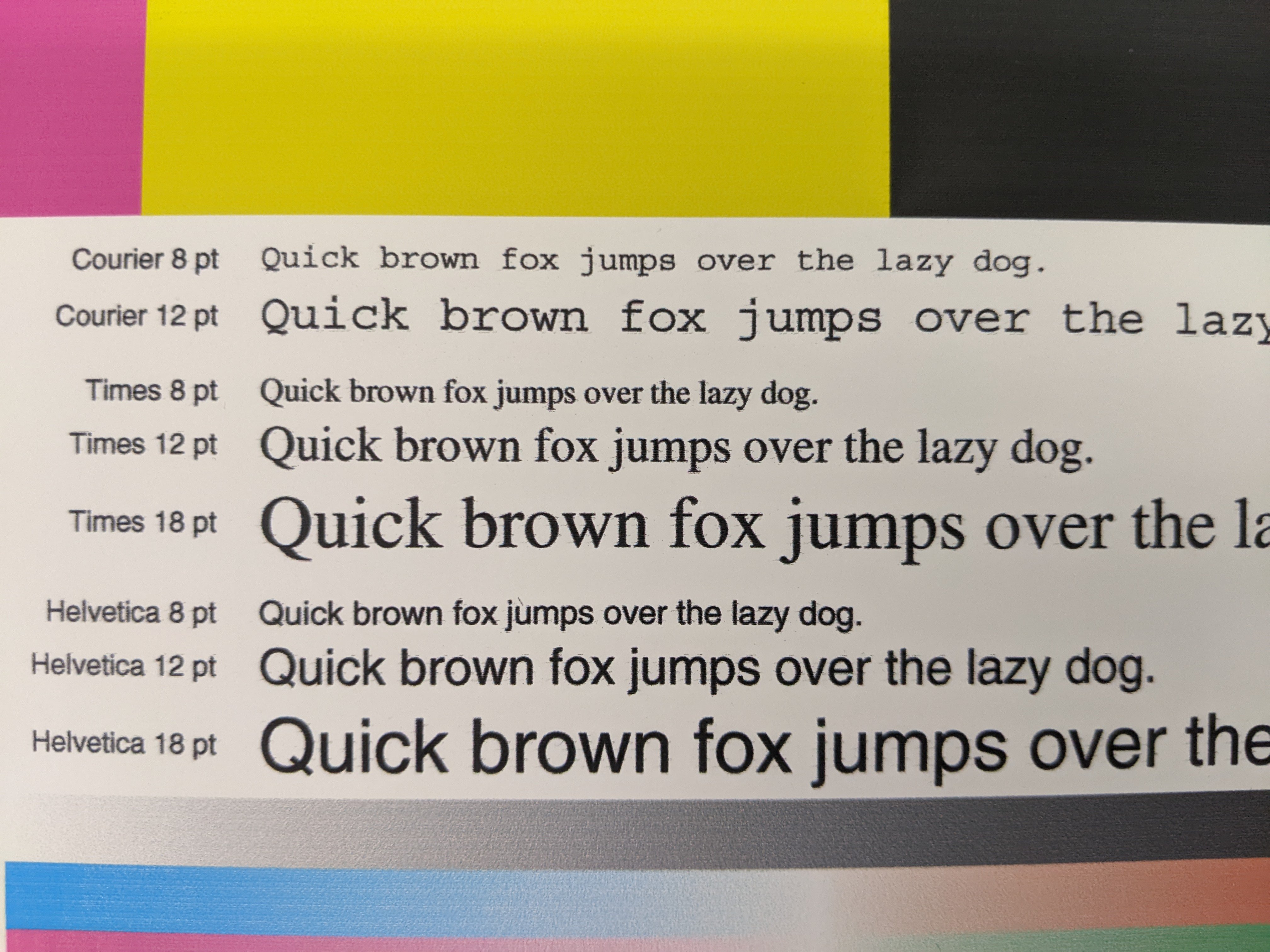

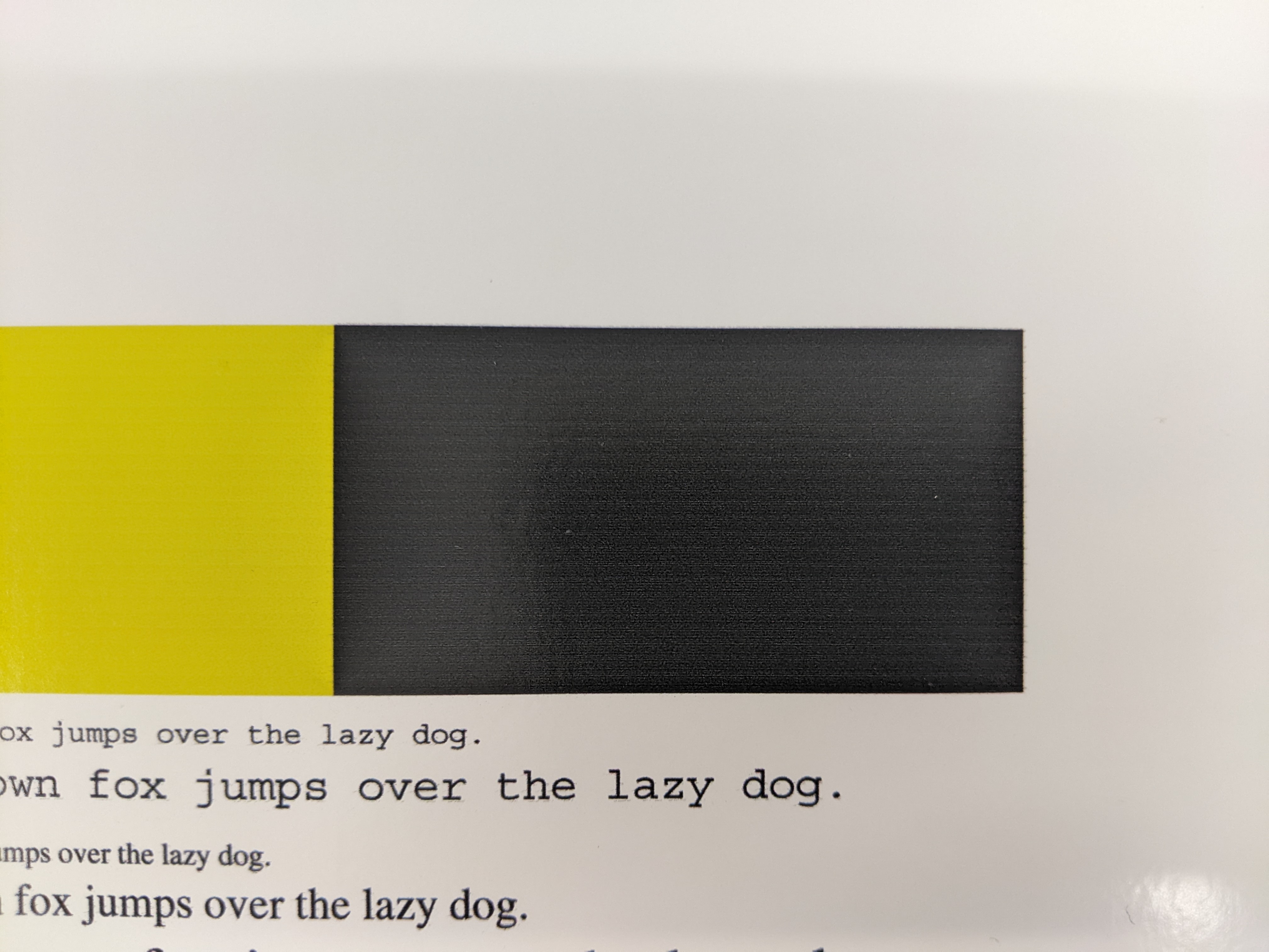

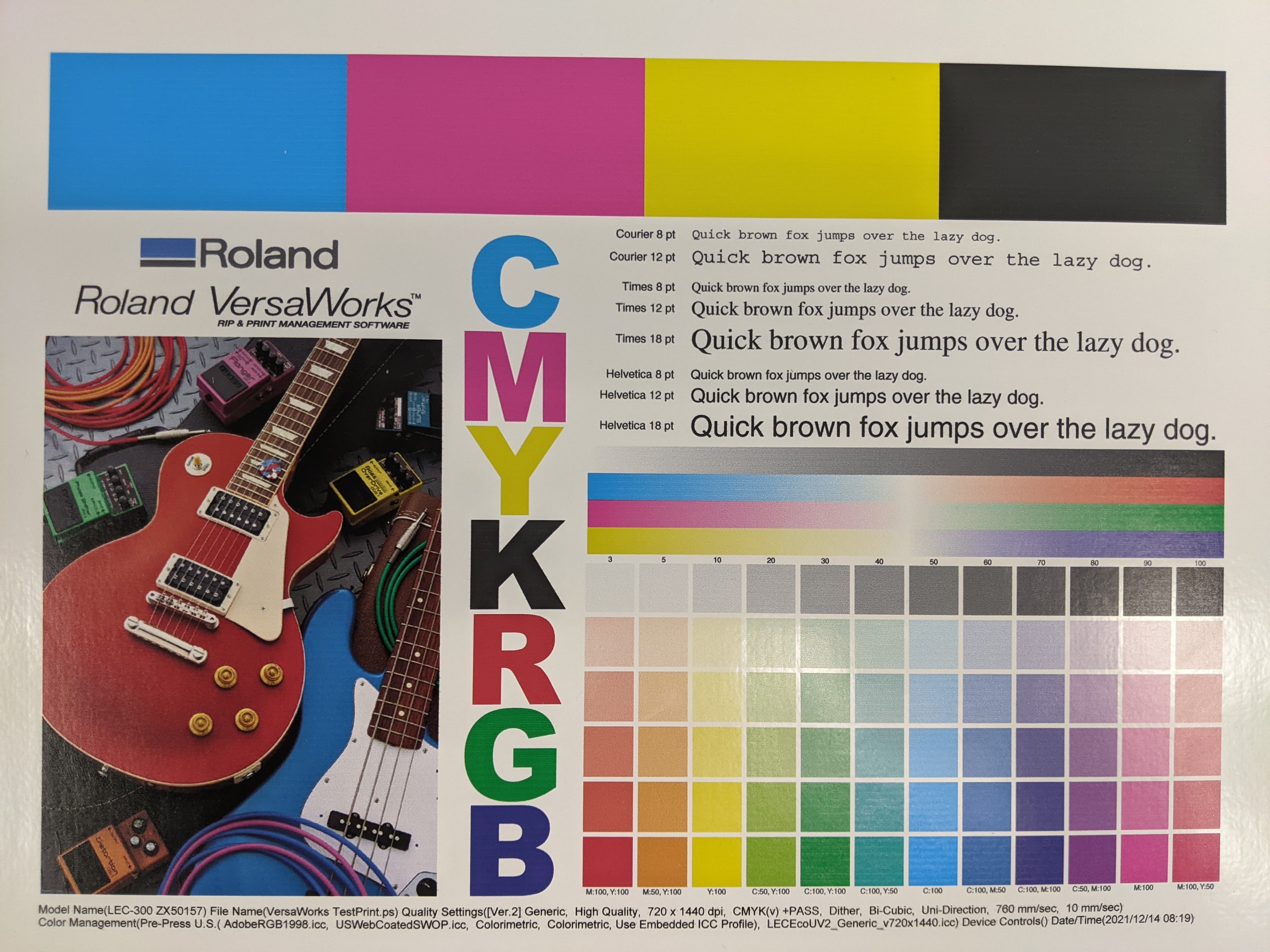

I've been pulling my hair out trying to get to the bottom of why my black is printing the way it is. I'll start off by saying this machine doesn't get regular use and it's normal for it to sit idle (but powered on) for a month or two at a time. However, this last quarter of the year it has been getting use at least once a month. Back in August it printed great, a few missing jets in the test print but the printed result always looked fine. Then as it got colder and drier I noticed the test prints start to decline to the point where I am now. Black lines now print "hairy" and you can notice banding in the black. The things I have tried to solve the quality issue:
-Numerous manual cleanings
-16 hour head soak
-Cap top replacement
-Wiper replacement
-Wiper scraper cleaning
-Cleaned the encoder strip
None of those things changed the test print in any way. The only notable change from August until now has been the humidity change in our building. The relative humidity in the room that this machine is in is currently at 26%. I've seen it as low as 17%. Would relative humidity play such a large role in print quality or am I going to have to start looking at a replacement head?
Some background: I've no formal training on Rolands. The responsibility of this one was kind of just given to me after the last person quit a few years ago but if there is a youtube video on how to do something I can probably figure it out.

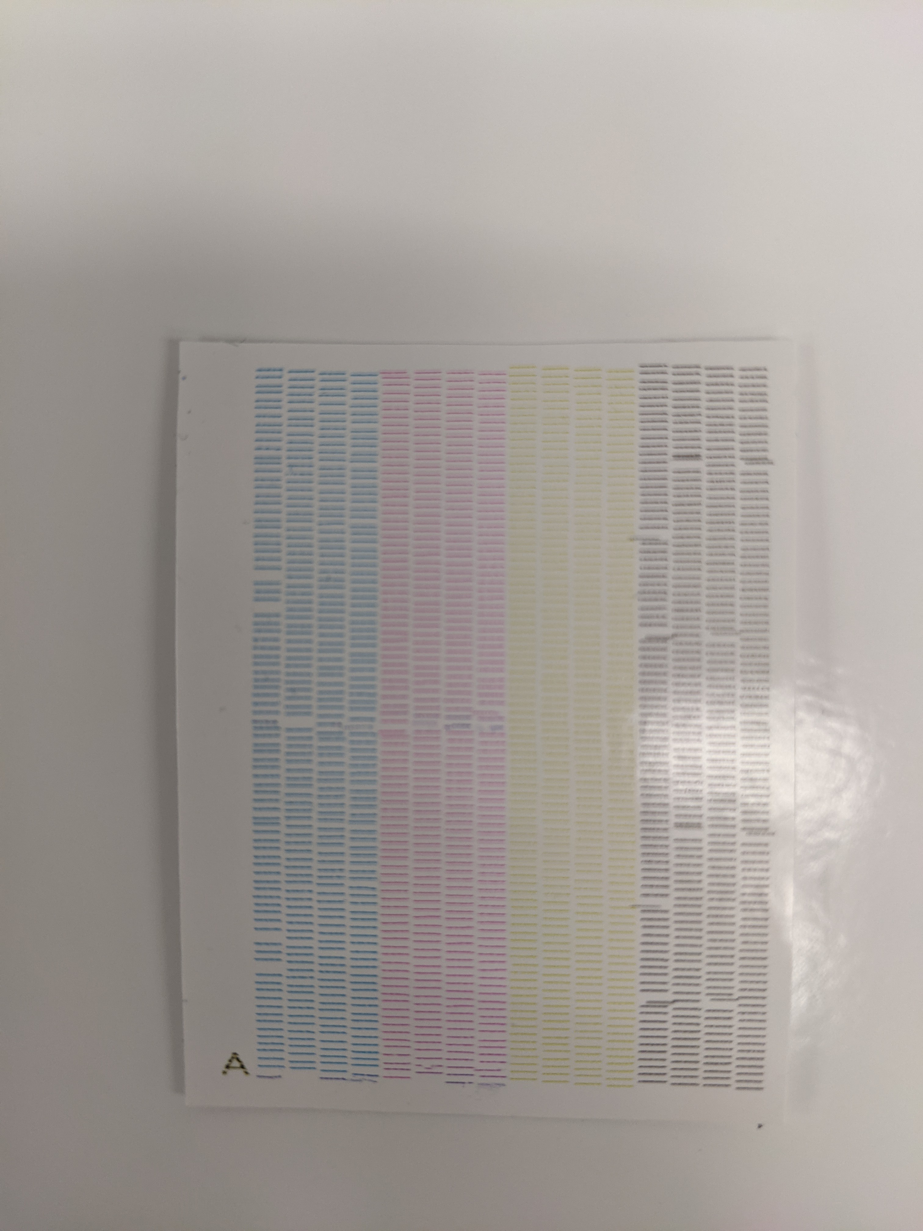

I did notice, however, that the cap tops are not draining well - if at all. I'm going to order a set of syringes to see if I can pull anything out of anywhere between the cap tops and the drain. Maybe that will help get some nozzles back but I doubt it. I'm kind of at a loss at what my next steps should be for troubleshooting. I'd like to get a tech in to take a look at the machine, but it doesn't get a whole lot of work so my boss is reluctant to spend the money on one. And from reading on this forum I do realize that I will likely need to replace the print head. But that will be an even harder sell to my boss. So until then I am open to any suggestions as to what I could do to try to get some of those nozzles back or straighten them out.

Could be due to lack of use, I've heard UV printers need to be used on a regular basis to stay in top shape. But I just noticed the nozzle test and there is a bit of deflection in some of those nozzles, my guess is that is at least part of the problem. Have you adjusted the alignment recently to see if that helps any, or try different profiles. From seeing that print, it's looking like a head would likely be needed, but you could try to do a 48 hour soak and see if that helps anything.

Typically depending on how bad the nozzle deflection is you can play around with the adjustments to minimize the banding, that looks to be the biggest issue you have, I also notice a little overspray, which is probably from the deflecting nozzles. But you may be able to minimize by reducing print speed and increase heat settings (If UV has that ability), maybe even trying different print profiles. I don't have a UV printer only Eco-Sol, but I know Roland's are very similar in function in all the different formats.

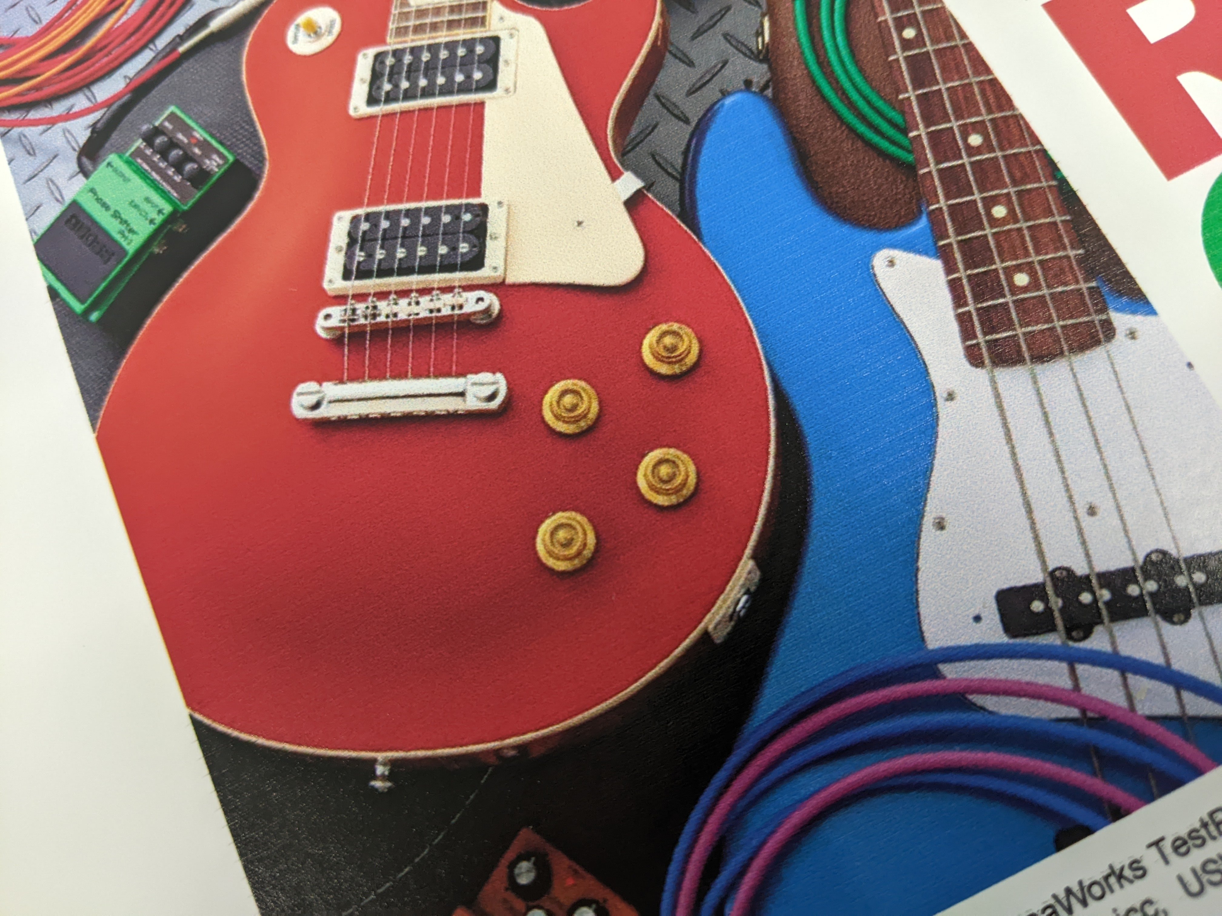

To be honest, that test print doesn't really do justice to the quality that it can print. That cyan banding is pretty nonexistent in real world application and the only real noticeable quality issue is the black over spray. I attached a pic of something fresh off the printer this morning - no adjustments from when I ran that test print last week. I personally think the quality is outstanding (the dithering in the yellow and pixelization of the background is intentional)....except for the black. Really quite disappointing.
I almost exclusively run it on high quality, uni-directional unless print time becomes a factor. I tried messing with the print speed but I didn't really see any improvements in the quality of the black. Sounds like my syringes will be coming in tomorrow so I'll post an update then if pulling ink through the cap tops helps anything.
