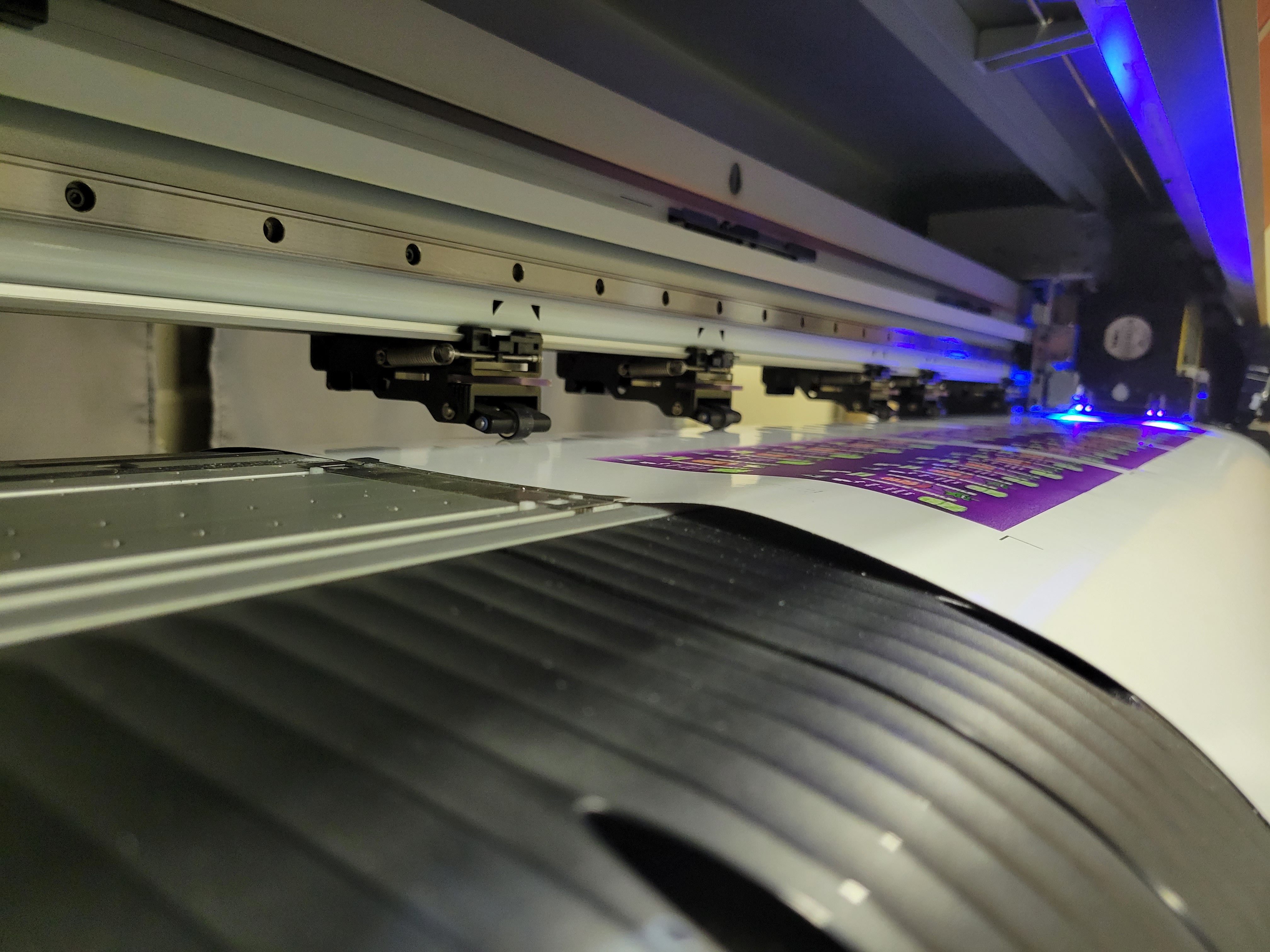

Make sure your pinch rollers are as evenly spaced as possible and make sure all the ones being used are over the grit of the grit roller as indicated by some triangle markings on the Y bar. If one or more of the rollers are out of position, it will cause the media to pop up like that. You may have had them in the proper position before but they can slide sometimes and be knocked out of position. You also want a pinch roller on each end of the media.
Also, make sure your take-up is level with the platen. You can use a strip of banner or other material to do this. Wrap the strip around the take up tube and the pull it up and through the pinch rollers so you can pull it down tight against the platen. Use the sheet cut trough as an indicator and mark the banner where they meet. Then slide the banner to the right side and do the same thing. If the left mark doesn't match the right mark, adjust the take-up until they do. That will ensure it pulls straight.
So basically when the media skews, it makes it pop up and causes issues like yours.

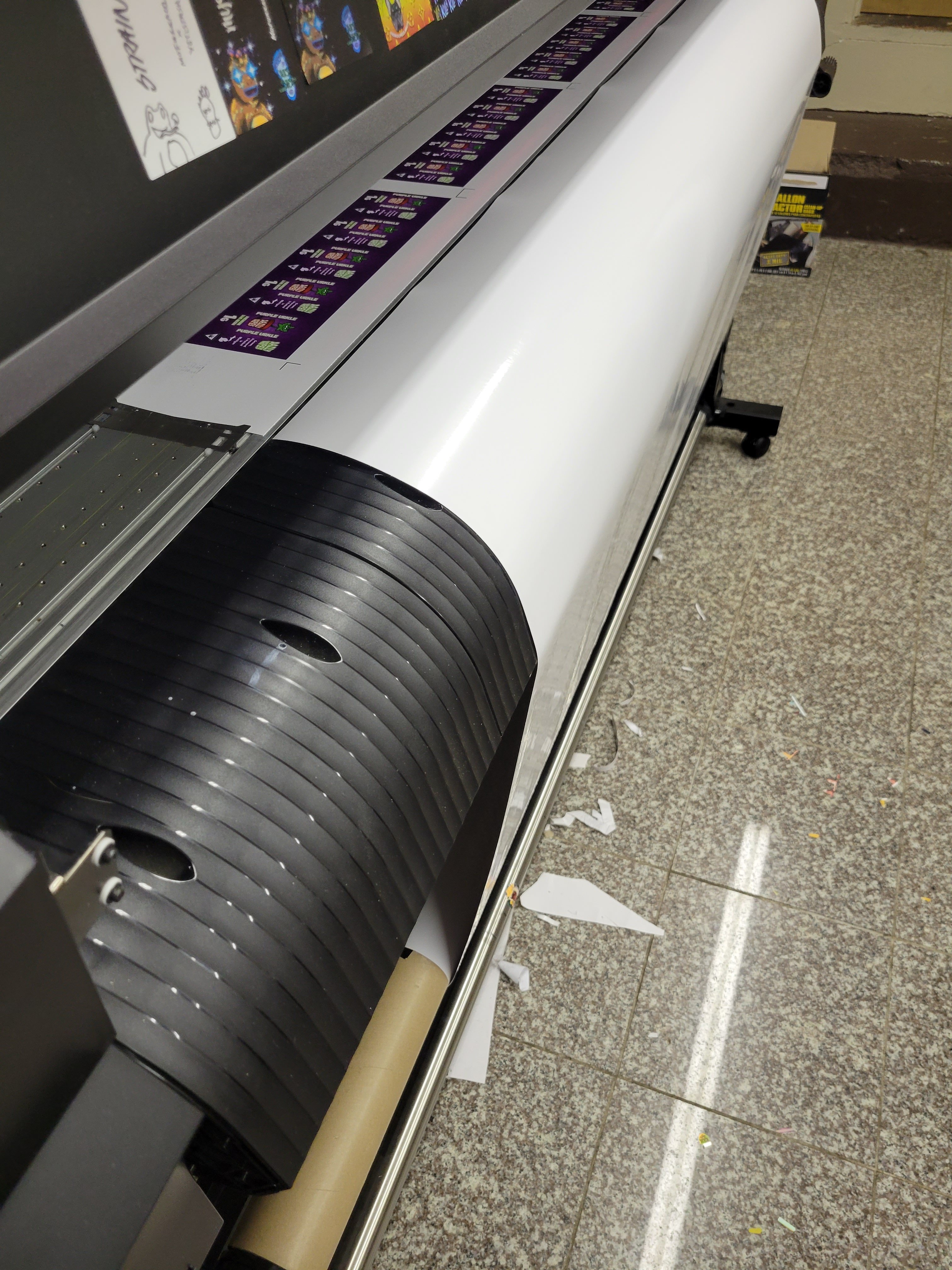

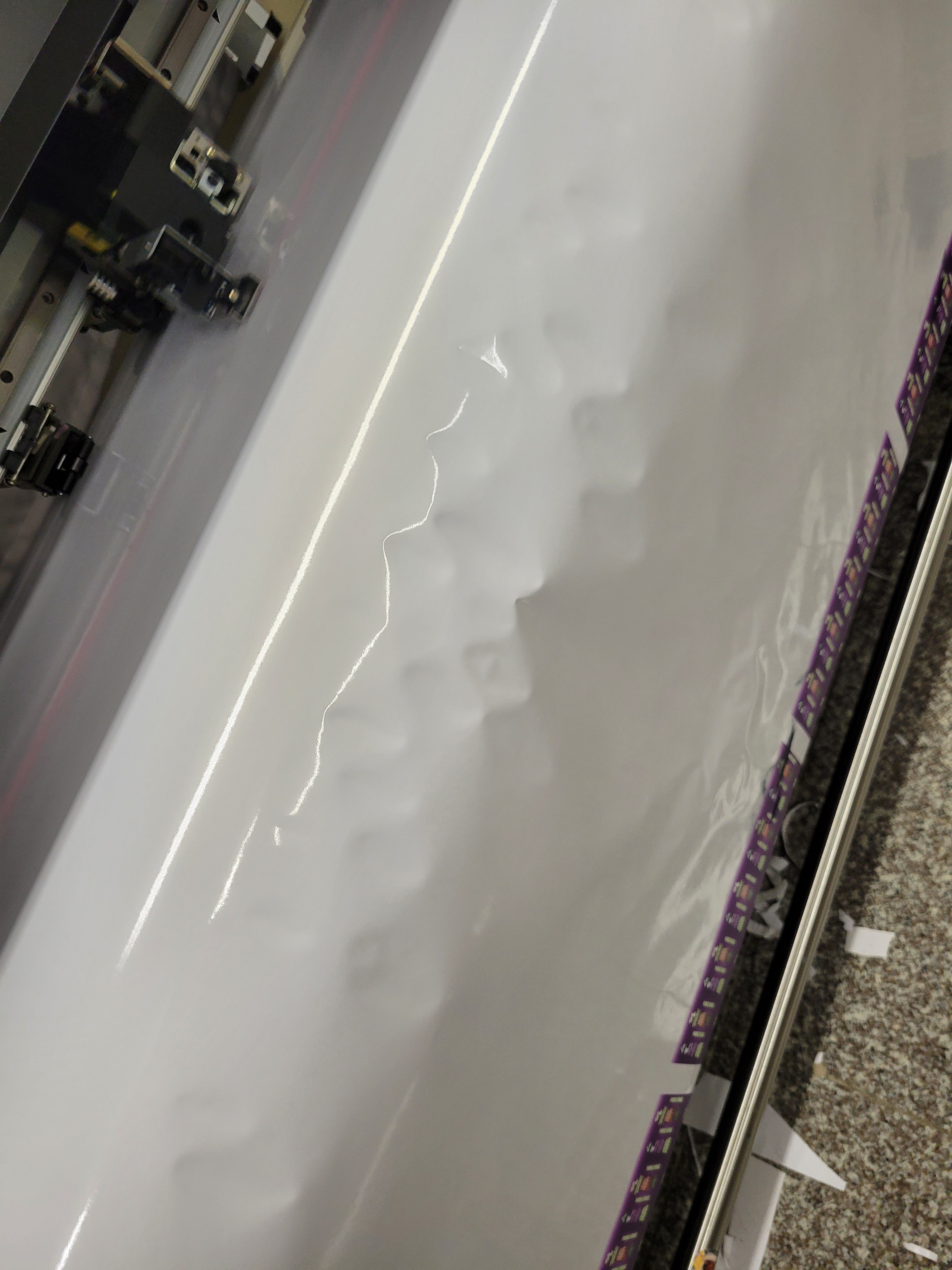

I may have said in front when I meant behind the print head. Whichever side is toward me and the take-up reel - it doesn't seem to be a skew problem right now, though I will try to check if we're level!
It's like it gets stuck on the plastic edge leading town to the take-up reel. I'll see if I can figure out how to get a video or gif of it happening up here.
You can see it flattens out after I pull it out, or sometimes when the take-up reel pulls hard enough/the right way.
It also seems to be past the vacuums so I don't think they're defective or anything.

That looks like you need to turn the vacuum up all the way if it isn't already. They also have a fix to help the vacuum pull the media down better. I don't have experience installing it but from what I hear, they basically fill some of the empty space in the platen with Styrofoam so the vacuum has less air to suck out in order to create a strong vacuum.
You also might look into adding Teflon strips to your platen. I don't know if it's static or what but it seems like there's a little too much friction between the vinyl and platen and that could be causing it to pop up like that. Mimaki used to send a strip of Teflon with each machine so look in the accessories box. You might already have some.
