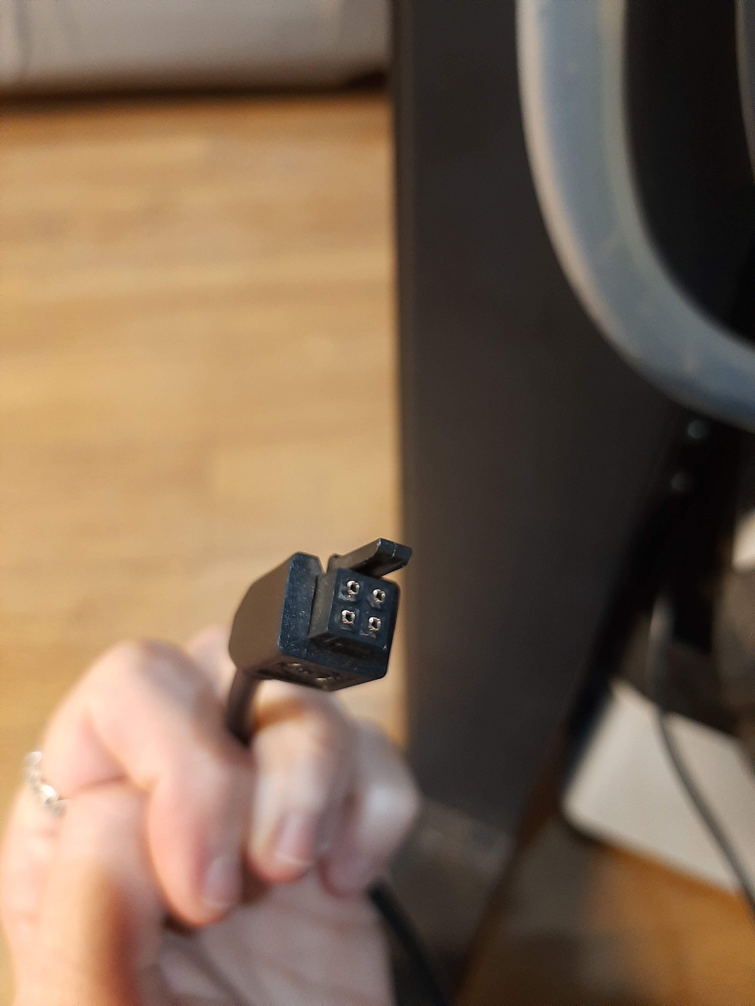

So the waste management cable broke in the back of the printer (the metal connectors snapped off one another and one piece lost), and the cost is about $500 to replace and we are getting a new printer in like a week :/ the censor isn't necessary, is there anyway to get around that error message to get the printer to print? Or if anyone has that part from an old printer of yours? Any help would be appreciated, thanks :)

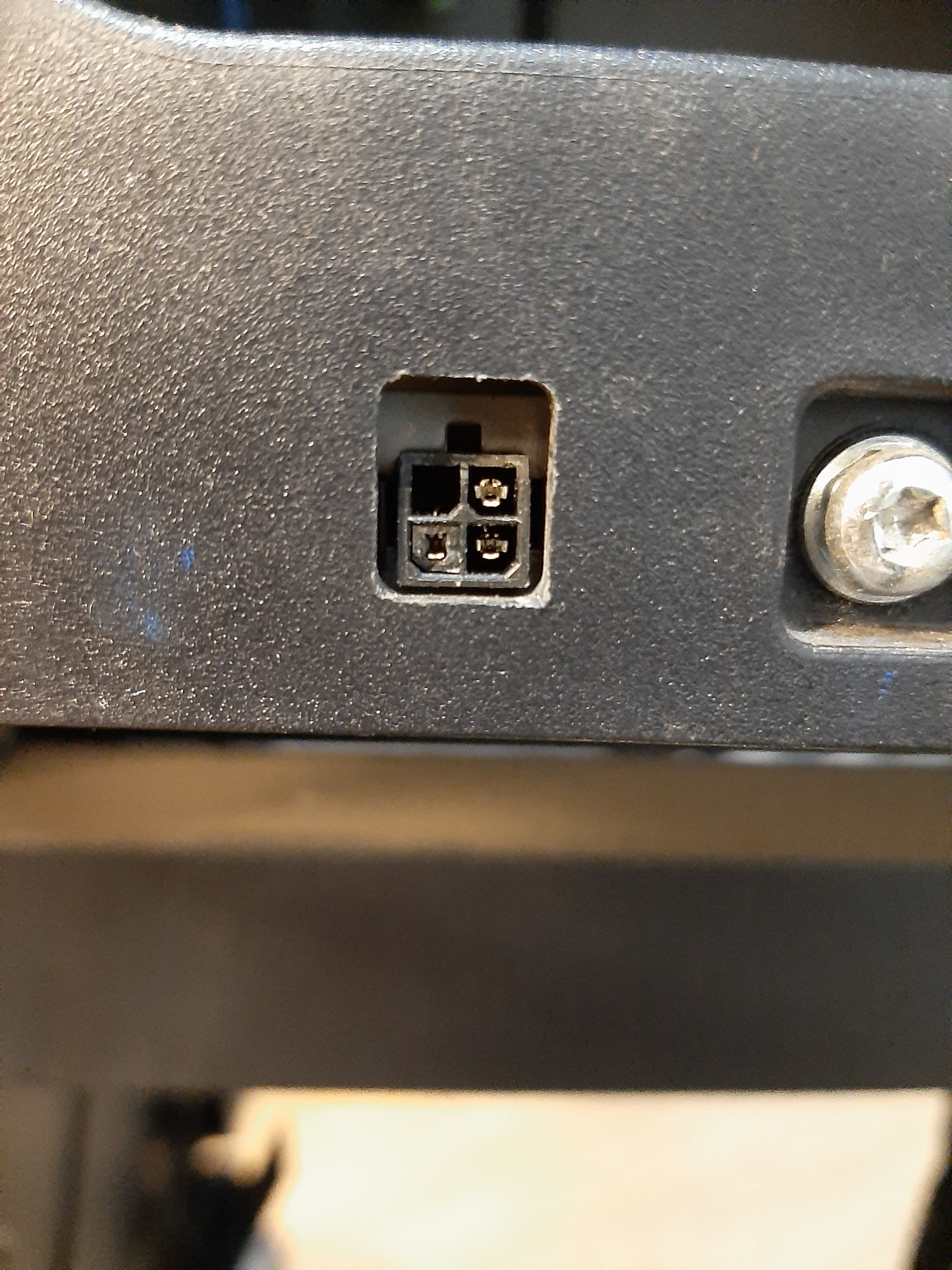

We don't have a back panel that opens up to it, it's a cable with four prongs that is external and connects to an internal motherboard where it is permanently fixed onto a sensor that would be very expensive to mess with. The part that is broken though is the external part of the cord and the metal connectors are broken in half and one is missing. (Picture attached)

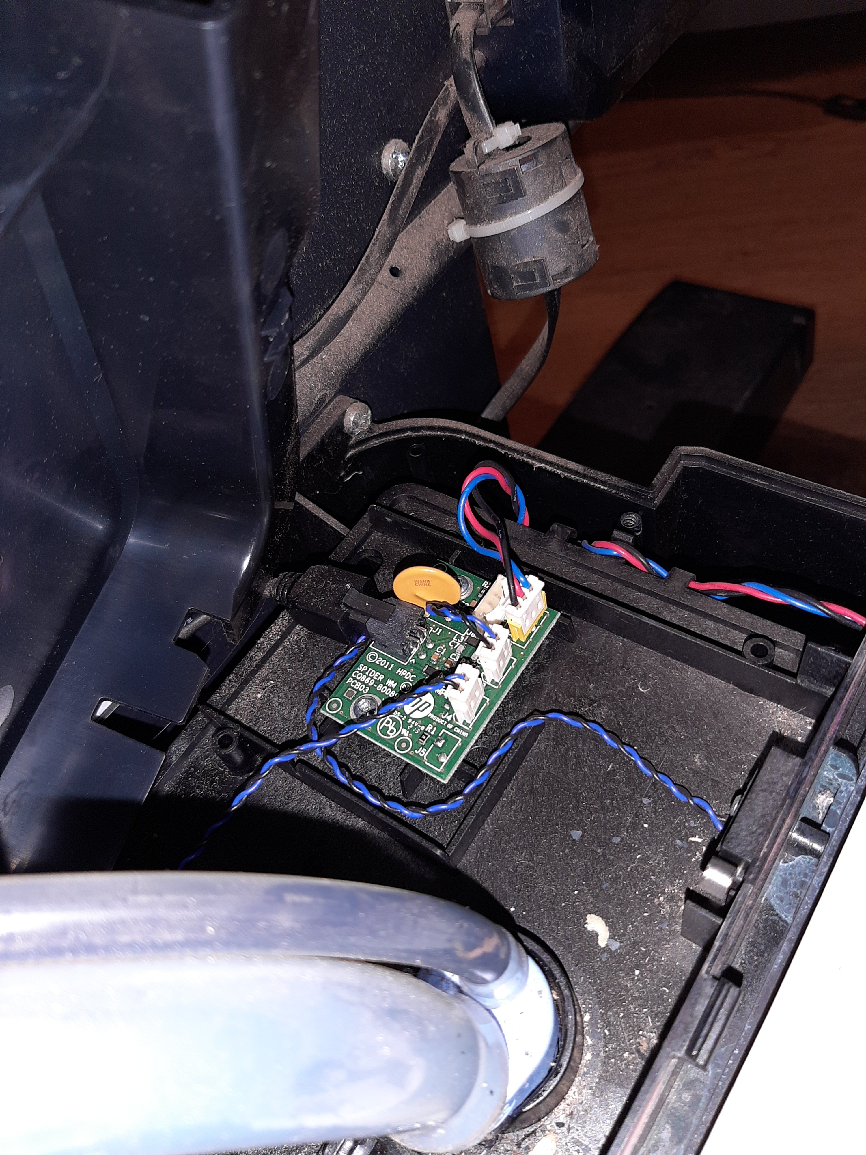

In 2nd picture you have the panel that I mean. Even got the screw next the to the connector to open it. 2nd screw should be on top of that, then just pull it out.
