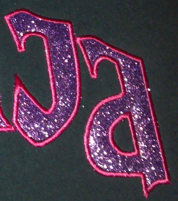

Dennis422
Here it is West.
About 30%-40% more density than a regular satin column. That is what I used. You can get away with less.
Looks good and easy to rip off.
