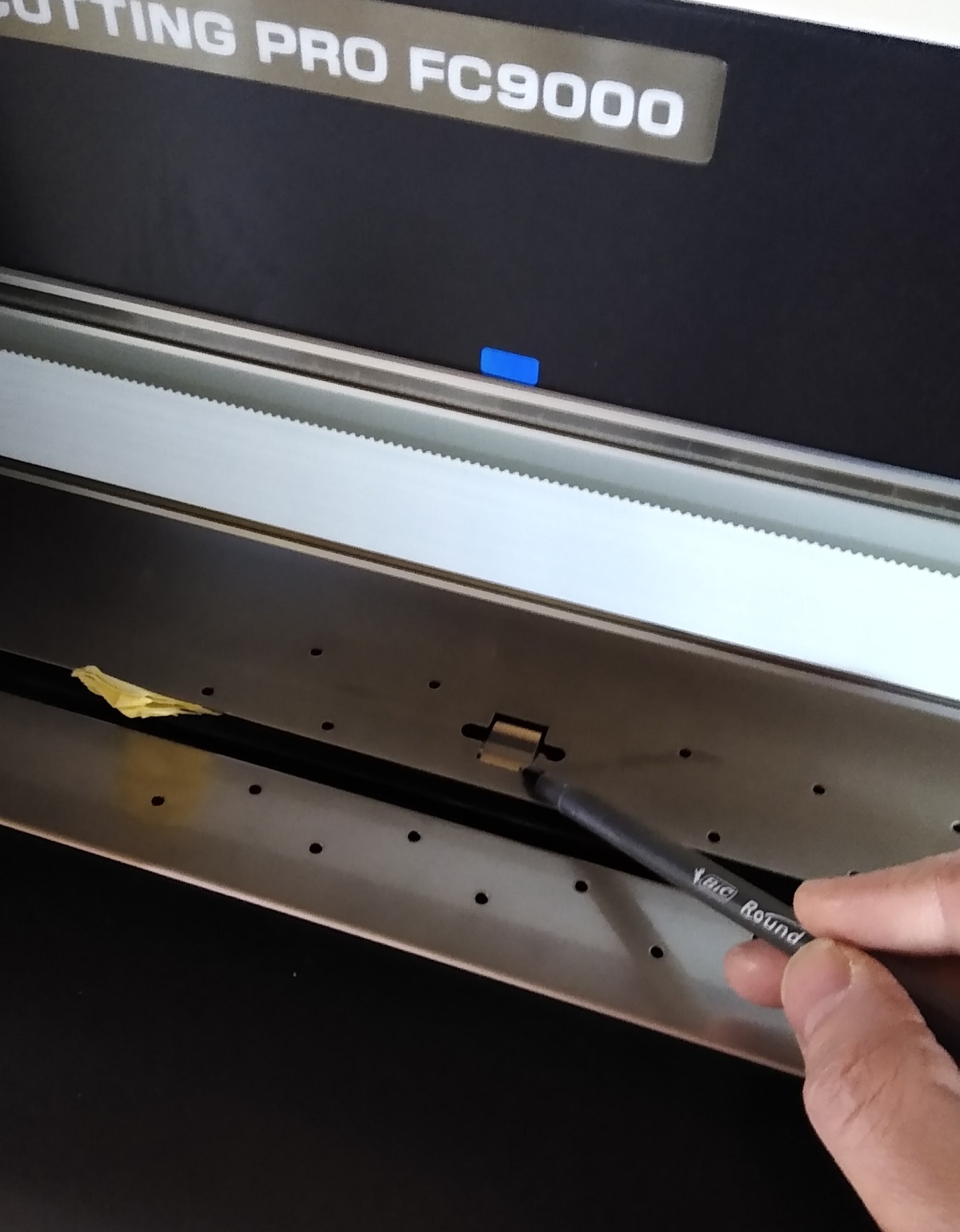

Have a photo?
It comes apart really easy. I had to do a ton of removal for the take up reel setup, nothing tricky... Just unscrew it pretty much.
BetaCtz
Where I'm pointing to the roller (front, is where it rubs).
The silver plate is wedged a little bit right now, so it's not rubbing.
