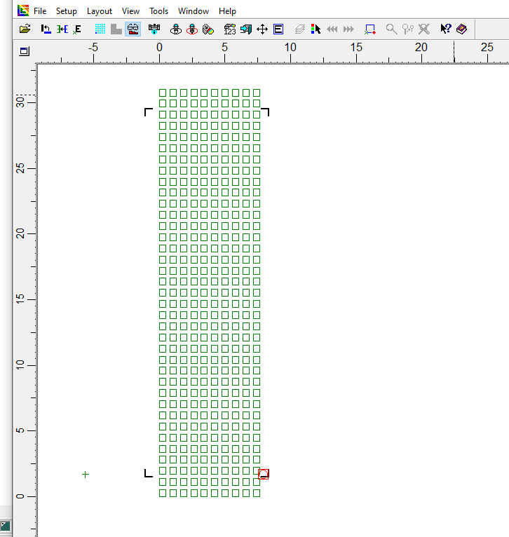

I use Envision. Graphtec SE5000-40 and Summa S class 1400 as well for contour cutting EDGE printed images. The last 2 are easier to find the registration mark, but need to take a good care of filling the material to the cutter. I Cut 10m+ on the summa without any problem already. They are supported since Omega v. 2.6

For the graphtec, are you using their ARM system? Is your print area reduced or you using the 4 corners?
Attila Nagy
Yes, That is the main advantage. It does not add the target to the width can use the same size 299.72mm with Graphtec Type 2 registration marks. Faster and quieter.
