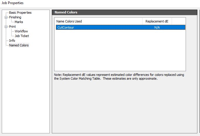

"Because it's giving you this error we know your file doesn't have "CutContour" on it". Unfortunately this isnt true, Cut Contour shows up in the Named Colors on our file. Any other ideas?
regardstobuck
Thanks for your input. The onyx support sent their print cut file and got the same error.
We reinstalled the software and it’s working great now. Somewhere a file got corrupted we have no idea how.
