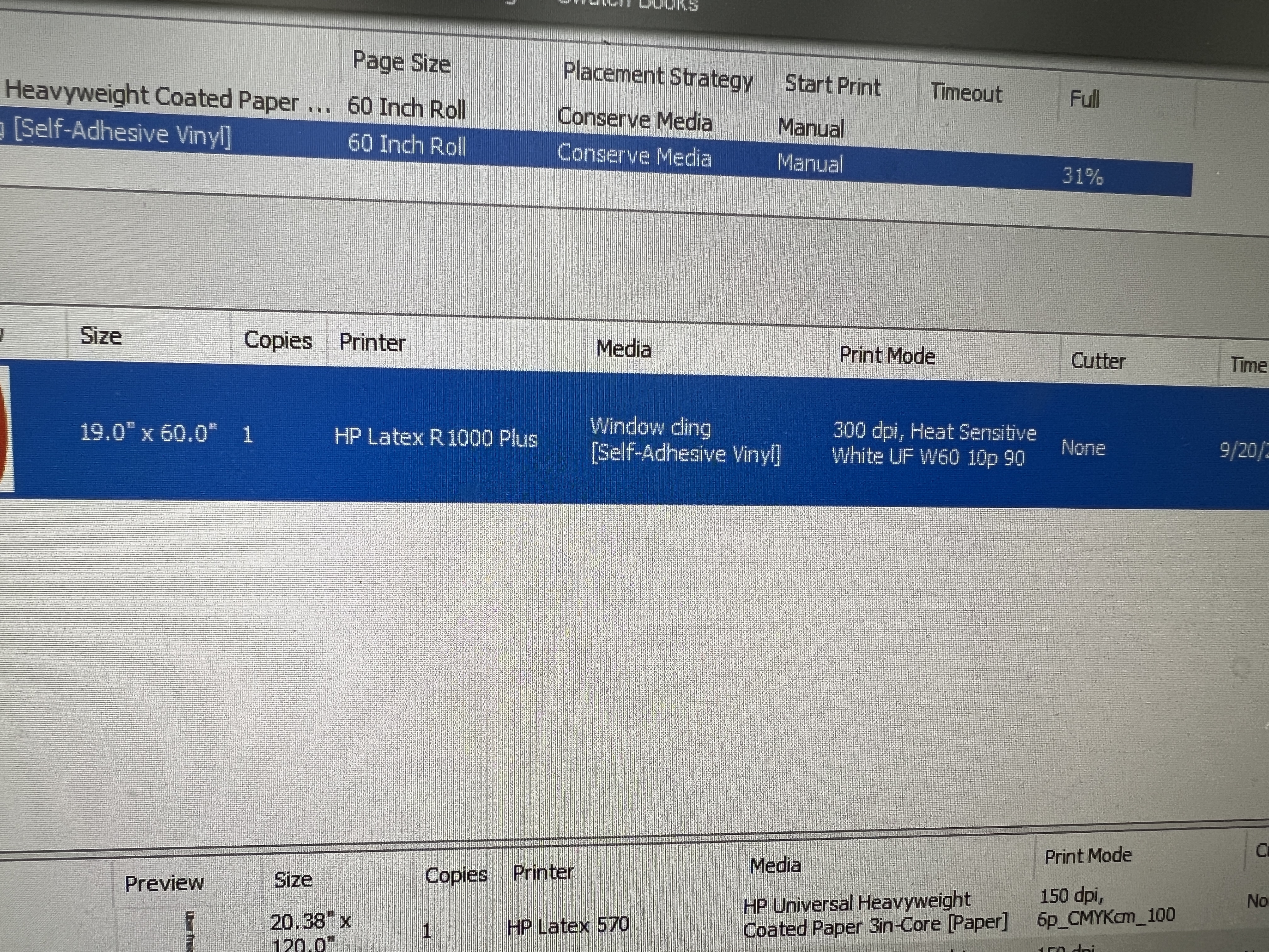

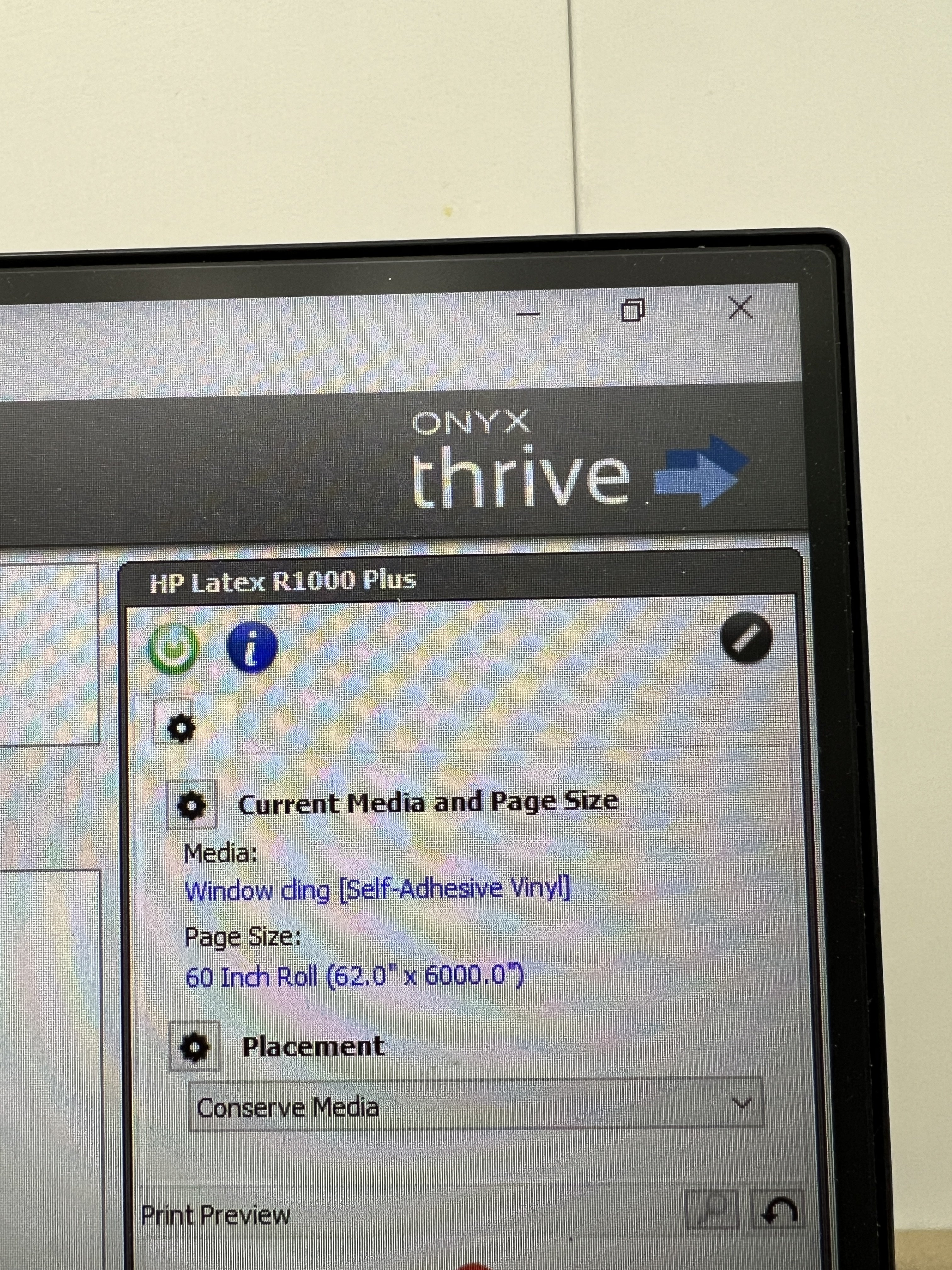

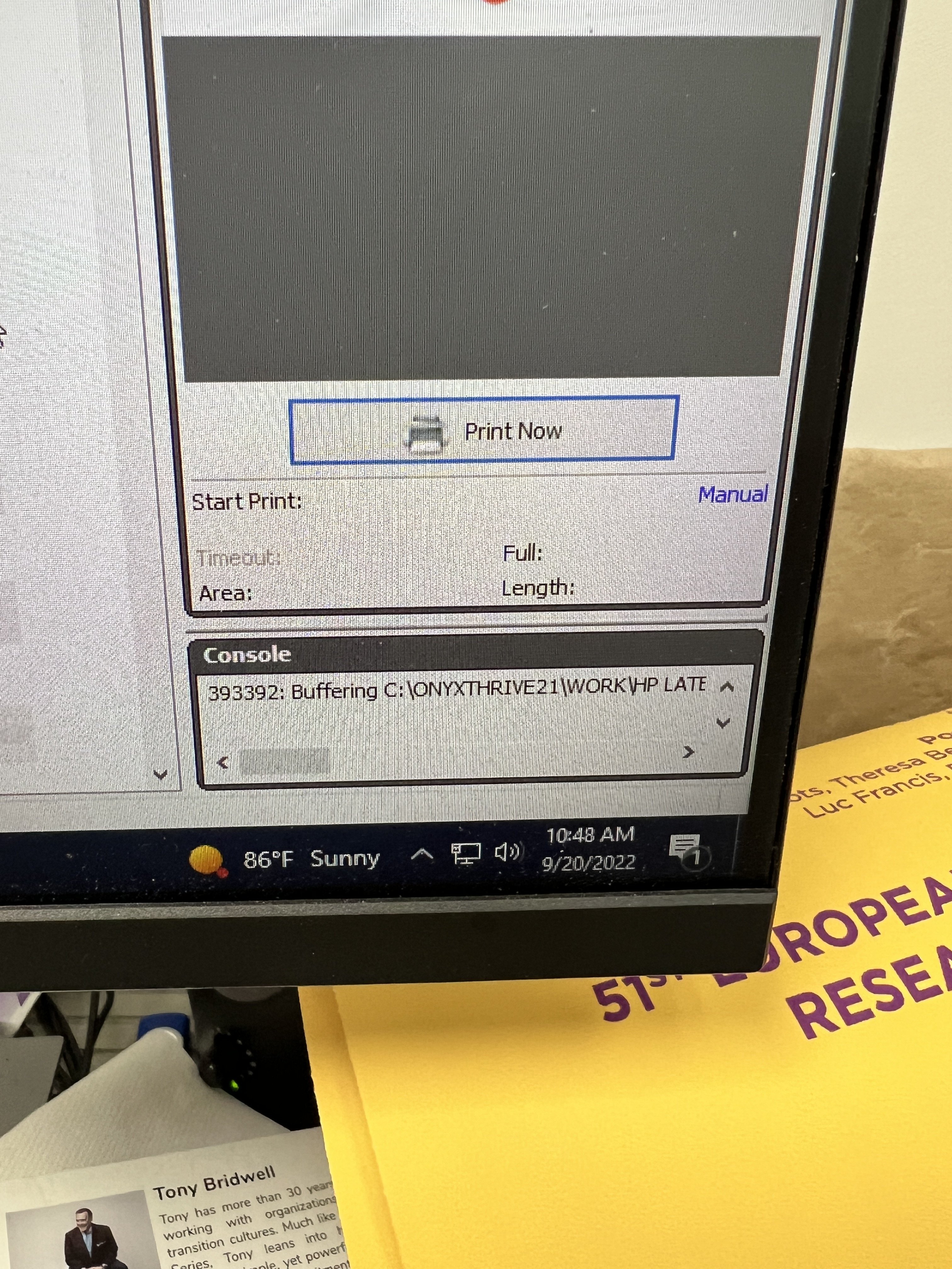

I’m having a struggle with Onyx this morning. I have a file that is set up on the correct material in Onyx. It’s a window cling with an under flood of white. My white print heads are in, the machine is operational and onyx shows that the job material in the printer, material or substrate agree, and I have a “print now” button. When I hit the print now button it processes and then the job returns to the list of ripped jobs, but the job does not show up in the queue on my R 1000.

Well um did you try to restart Onyx? Does he have some "minimum area fill" turned on? Change placement to "individual jobs"?
Anyway this is Onyx issue or connection between the two PCs. Printer has nothing to do with this problem.
Does it show errors beside the job? Are there any errors coming up on the console? Can Onyx see the printer if you click on info "i" button? Have you tried re-loading the file and/or trying a different file with same quickset?
Like balstestrat, mentioned, try cycling through placement options and/or rebooting Onyx, sometimes that magically fixes things.
We've been having lots of issues with Onyx lately, between it forgetting our Mimaki and causing our Roland to error out it's been a real pain.
MGB_LE
Thanks everyone for the quick input!

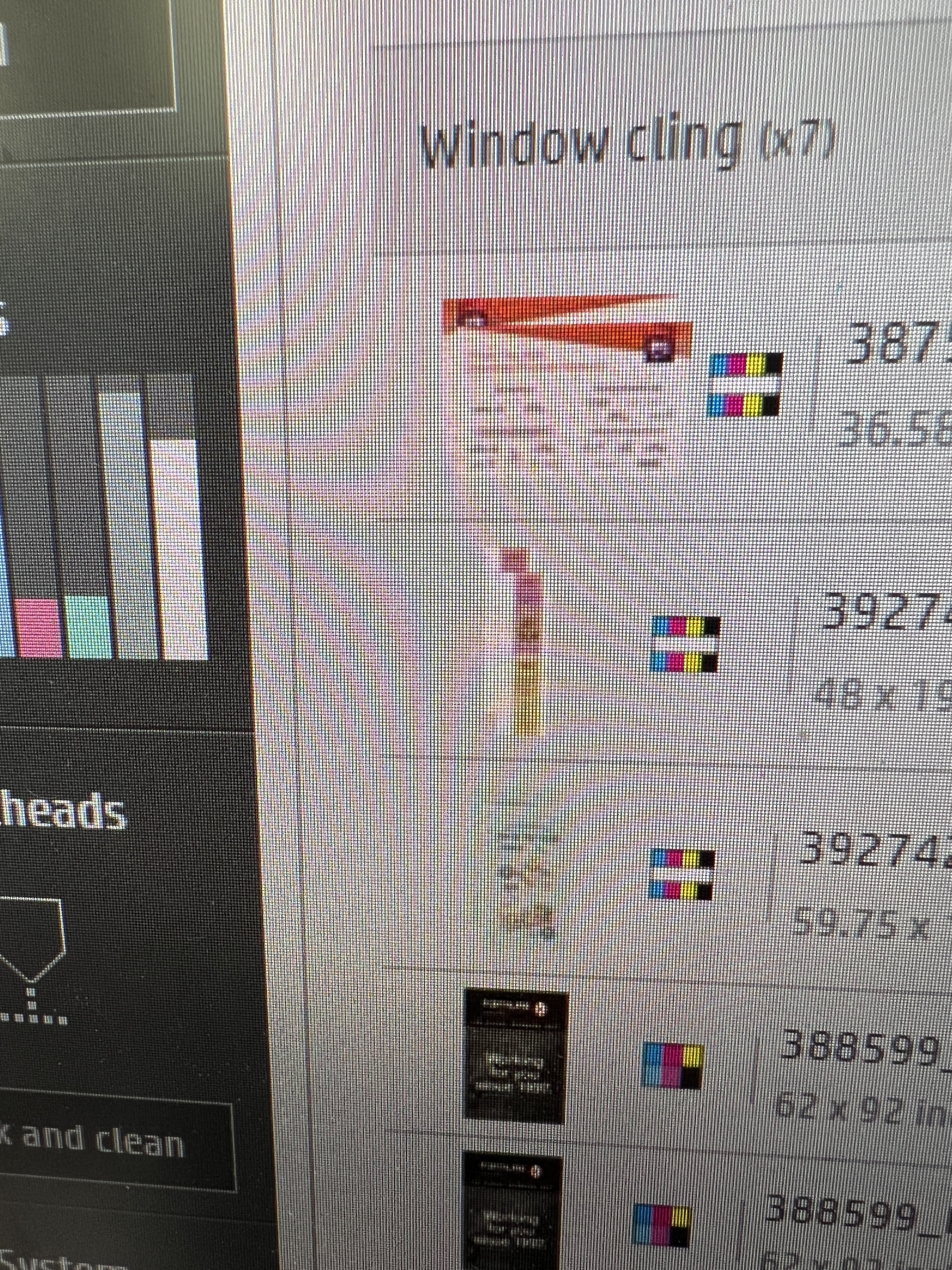

It seems to have been an HP issue instead? Someone said "I think you need to go to root (of the HP printer's PC) and then the Output folder. That should have folders listed that match the various print setting and material you have.
Find the folder that matches what you are printing and it should be in there."
Sure enough when I browsed the hard drive of the printer's PC, I found several copies of the job that Onyx was successfully submitting to the printer with no error message. For some reason the jobs weren't Appearing in the printer's Inbox, which is subdivided my material name. I submitted manually from the printer's hard drive and all was well from there.

Restart IPS and it should work again. Something wrong with Onyx sending the information to IPS that the job is ready etc. so it would add it on the list. It's using JMF for it.
