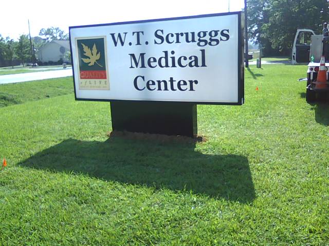

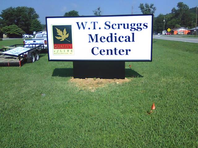

Is it a complete coverage print? If it is what we do is print on orajet clear and set the print setting to print twice with a paused dry time in between printing & it comes out very vivid. In the pictures attached the logo on the left is printed on clear at night it is awesome, couldn't find the pictures of the completely covered signs we have done. Hope this helps.
