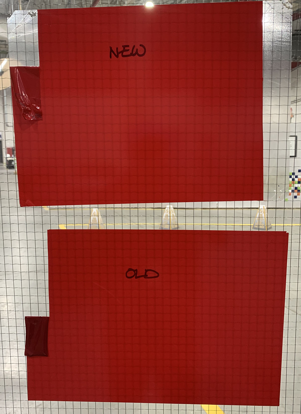

I had a similar issue with 3M 180mC-53 Cardinal Red, for a fleet of transit buses, the adhesive was peeling away from the vinyl when installers tied to pull it off to reposition, epic disaster, 25 rolls from same lot number all had to be sent back and replaced,
I lost 3 weeks of labor, because off of the kits I had prepped to keep ahead of installs have to be replaced,
