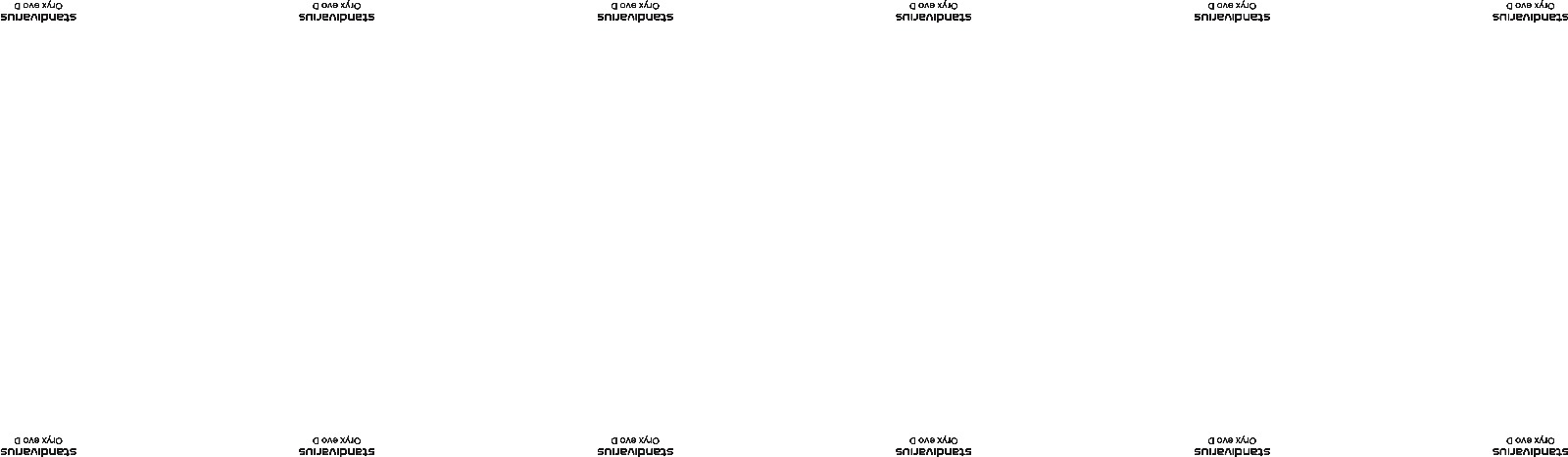

Edit: I attached also a file which can explain a bit better the situation. 12 logos printed on 12 products, 2 rows. Once printer finishes the first row, it keeps moving (the roll) at the same speed like it does when printing, about 1cm. So instead of moving fast to the next printable area, it moved 1cm at a time, so another 10 minutes lost.
