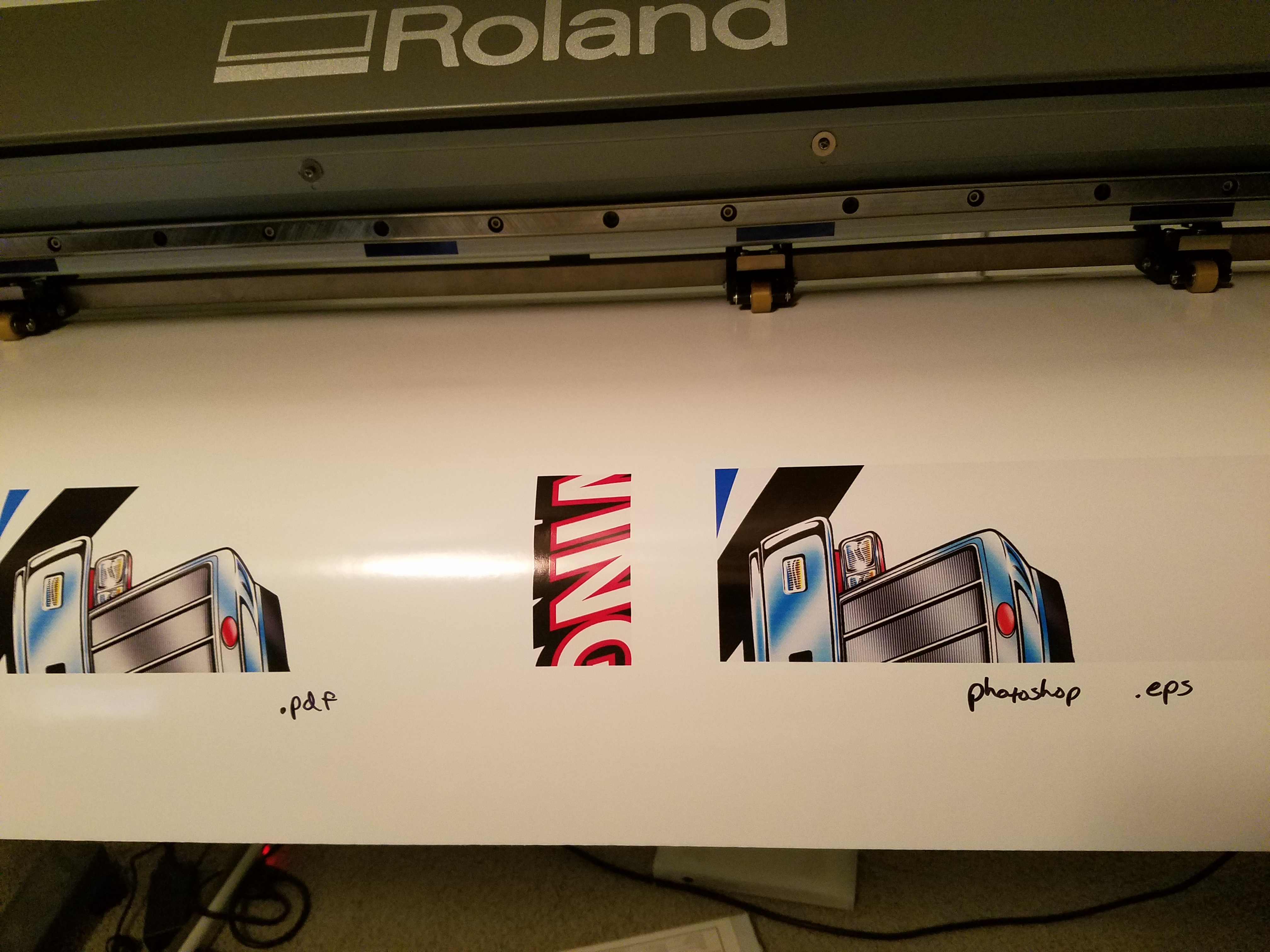

Here's a reference to what I'm talking about. Both files were saved out of photoshop, eps on the right with pdf on the left. Notice the offwhite box on the right with the eps where it is printing instead of just staying true white.

I don't use Photoshop, but it'll be in your color handling options. It's applying a profile to your eps saving that is changing the colors.

looks like you have a transparency issue, where its not flattening the image correctly and is printing a background

EPS files don't include an input profile and PDFs do which means the RIP is going to interpret them differently. There is absolutely no reason a PDF would be less quality than an EPS or any other file but if your down sample settings while saving the PDF are turned on, that would cause the quality to go down. When you go to save as a PDF, look at the options. One of them should be, "Compression". Click on that and there will be a setting for, "Down-sampling" Make sure you are set for ,"do not down sample" and also turn off compression. Now when you send a PDF, it should be as high quality as your file began with.

You're probably not saving your PDFs correctly. Elaborate further? Print quality as in colour or sharpness.
make the jpeg CMYK not RGB
That's not the issue. IMO if you're printing photos, it should be in RBG and let the RIP do it's job and covert the colours so your printer understands it.
The issue could possibly be the colour space in photoshop. TIFF, PDF (even jpeg) will embed an icc profile. EPS doesn't so either way EPS vs TIFF or PDF you'll see a difference in colour.
Go into PS and go Edit - Colour setting. RGB should be sRGB and CMYK should be U.S web coated (SWOP) v2
Check those.
