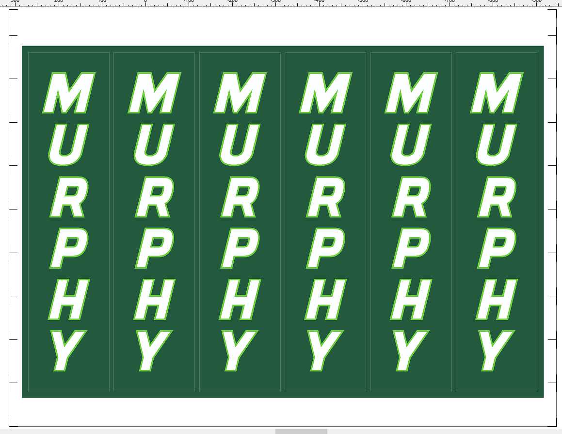

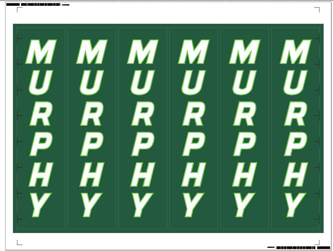

Hi,
I am using Flexi to print to my Roland VG machine. The problem I have is when I use the Graphtec Segment Area Type 2 registration marks they are outside the print. However if I use the barcode feature for 'Roll' so I can send it off to cut unattended, the registration marks are places within the print itself. What setting do I need to be able to ensure the registration marks are outside the print when using the barcode.
I have attached a couple of images to illustrate.
Thanks in advance.
Neil

Just use 4 corner marks for that if you need to get that done asap. You don't need all those registration marks for something that small. Or only print 5 of the stickers side by side instead of 6 to give enough room for the registration marks
tdgraphics
Thanks.
Got it sorted. It was the communication between the PC and plotter. I set the plotter from Auto to GP-GL and it works fine now.
