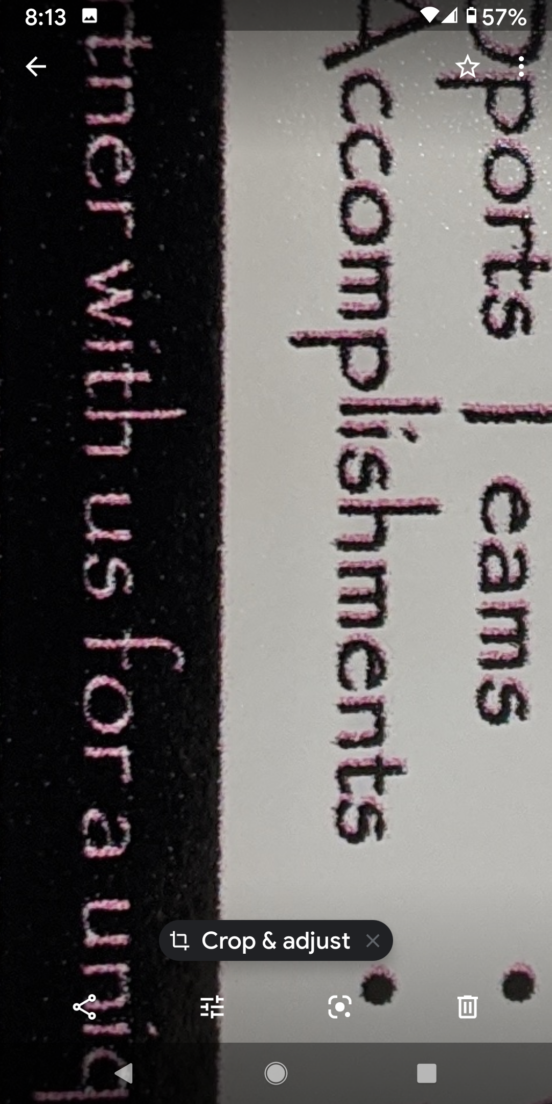

Here is a better picture of what's going on
I am getting ready to do the head alignment tomorrow. Did all the test prints and got all my notes and adjustments ready..

Jaya kishore
You need to perform Horizontal alignment.
