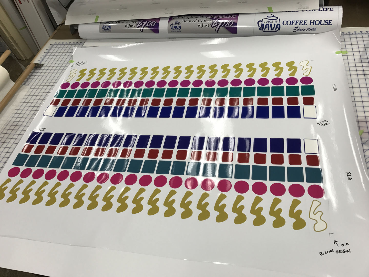

Greetings, all. I've had a Roland for over 10 years, and I switched to a new Mimaki CJV150, and it just can't cut right, despite finding all reg marks no problem. Not matter if it's a 1' or 10' print/lam/cut, it's about 0.25" off. Multiple attempts with SL10 support, still no answer. Getting really frustrated, I've got a hell of a lot of SL files, but have had to output thru RasterLink instead. PLEASE, anyone out there running SL10 on a CJV? I'd rather stick w/SL, but it's turning into a pain to export everything for a simple print & cut. I've tried all different media weight, pinch rolls, up speeds, knife pressure options, everything.

Right, but I've already got SignLab, been familiar and using it for 10+ years. Just can't get it to jive with my new CJV
