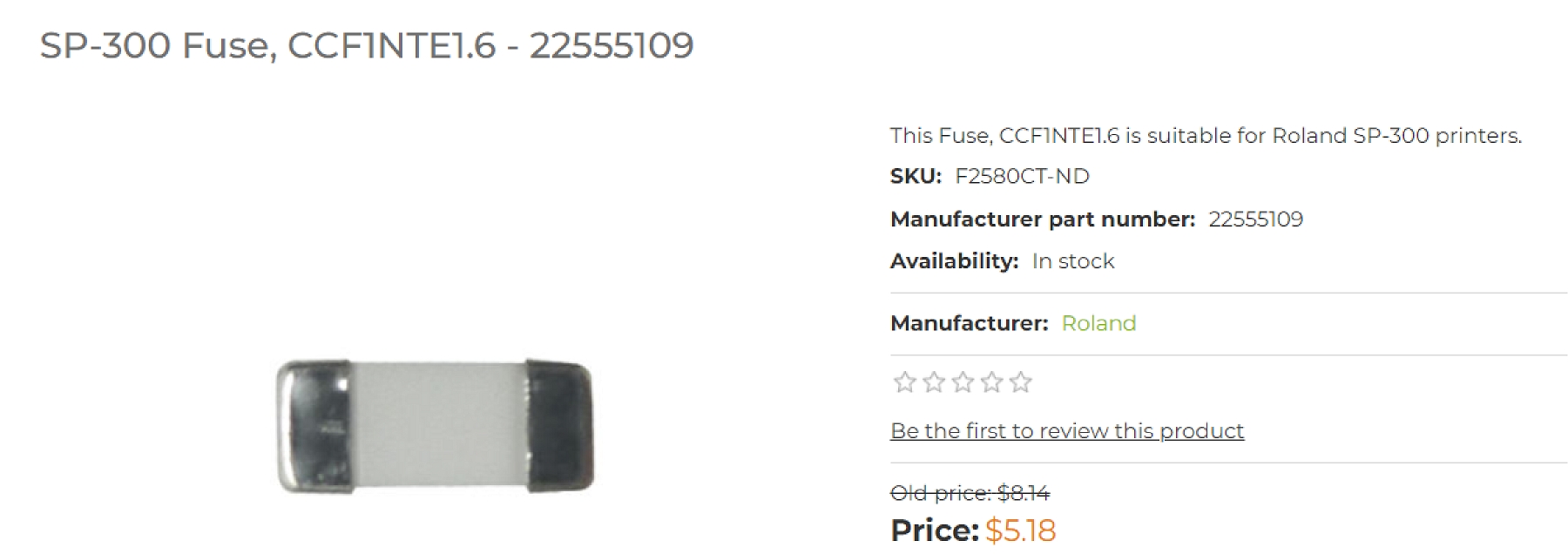

Yes. Otherwise, you may just blow the fuse again. It's a simple test and will get you running quicker. What kind of fuses did you get, and hopefully more than 1?
signgirl71
I ordered two of these and two head cables - hopefully they are the correct ones. Out for delivery at the moment, haven't received them yet.
Jim Hancock
Old School Technician
Those are the correct fuses. I suspect your existing cables are probably ok, but check the traces at the ends of the cables for any damage.

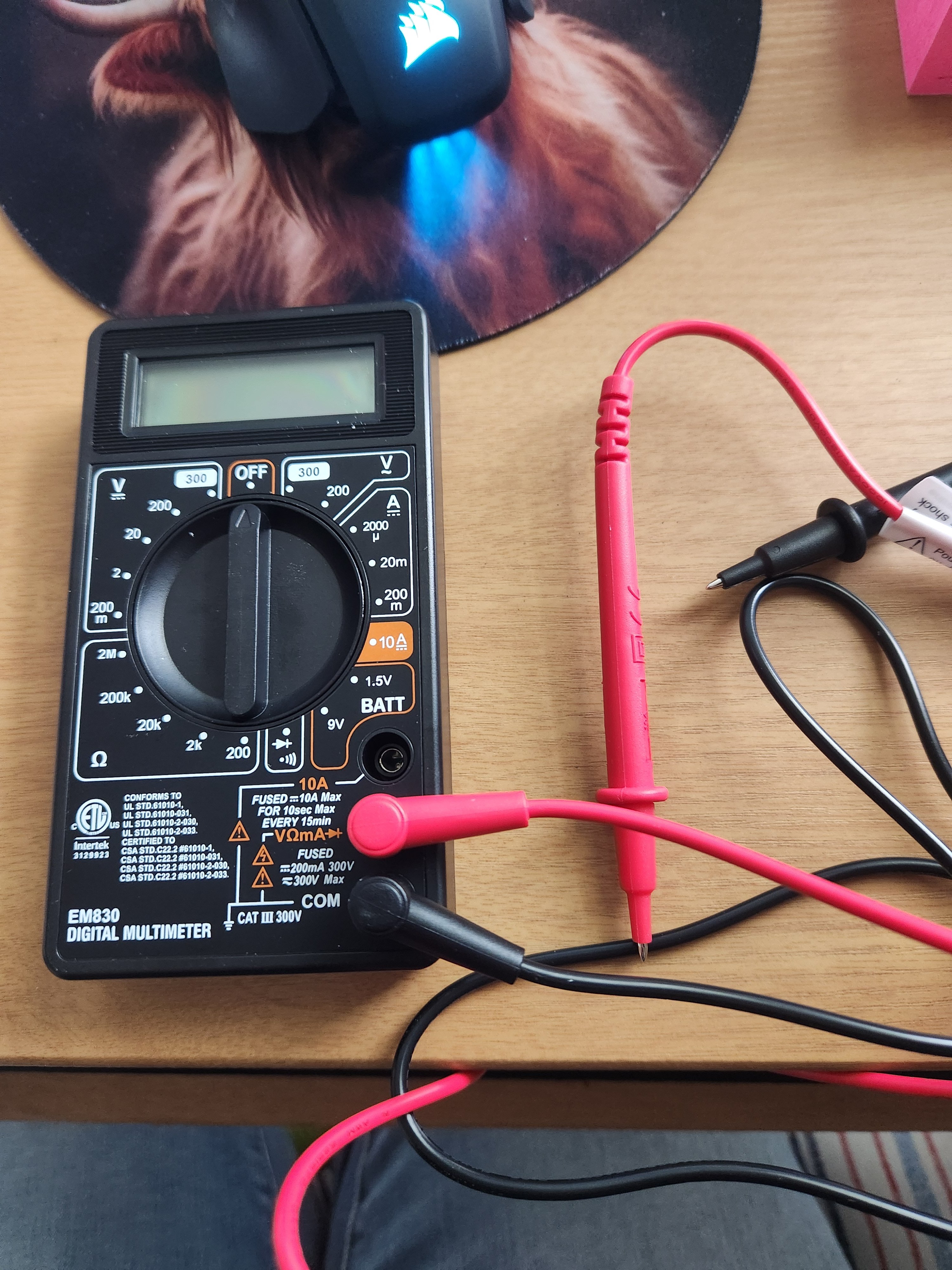

I just texted my son at work to see if he has one here, if not I will have to take a ride to get one from my father. (a multimeter as I read above)
damonCA21
You can get multimeters from any DIY place like harbor freight etc.. for less than $10. You just need a basic one that tests continuity, DC voltage and resistance. They are always handy tools to have for working on printers so worth getting one
signgirl71
of course they were out of the cheapies - thats just my luck but i'm sure we will have alot of use for this anyways since this house we moved into has some weird electrical problems in certain areas. So, that being said, do I dare do this? I have never used a multimeter, don't know how to read one, and don't know where the output transistor is. Honestly I'm feeling pretty stupid, but I will never learn if I don't try it...
