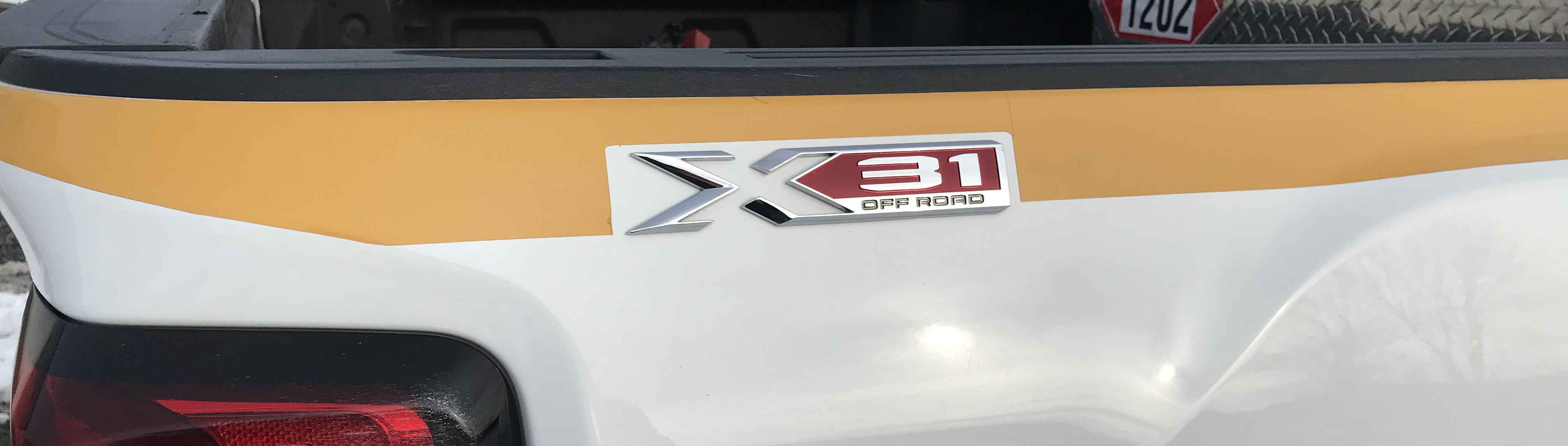

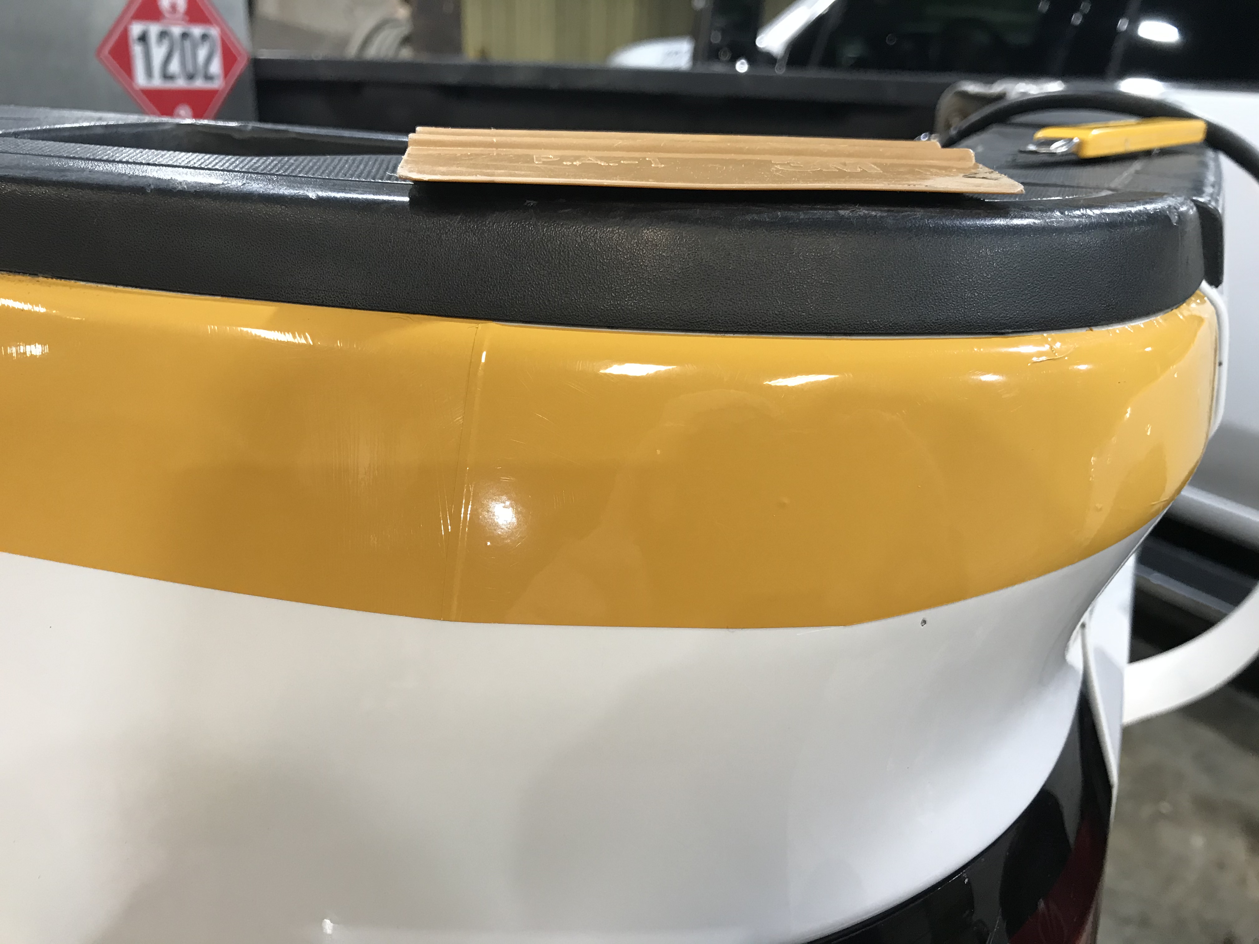

I am putting a 2-2.5” stripe on a truck boxes where it meets the truck liner so right at the top. I always find it hard to make any slight curve with a stripe this wide and trying not to have a splice. What is the best way to make that curve at the end that goes around to the tailgate? I precut the stripe by hand to get a 8’ plus length. Should I leave a good chunk at the end to wrap it then trim with an exacto? I had to splice in the photo below. Any ideas would be appreciated.

I would use 3M Finish Line Knifeless Tape to lay out your lines, then Lay the vinyl on top in one piece, enough to cover each edge by about an inch, you should only need to use a knife on the ends to cut flush with the bed. Are you using Cast or Calendared vinyl?
kroger
I use cast for vehicles and anything outside. I did use the 3m knifeless tape which didn’t go well. Lol. It’s been a while since I used it. Does it get old? I didn’t find that it has a nice clean cut. I need more practise too! I did try heat but i ended up scraping that piece. I’m not fond of the striping but when I do the decals I can’t say no to the trim. Thanks
