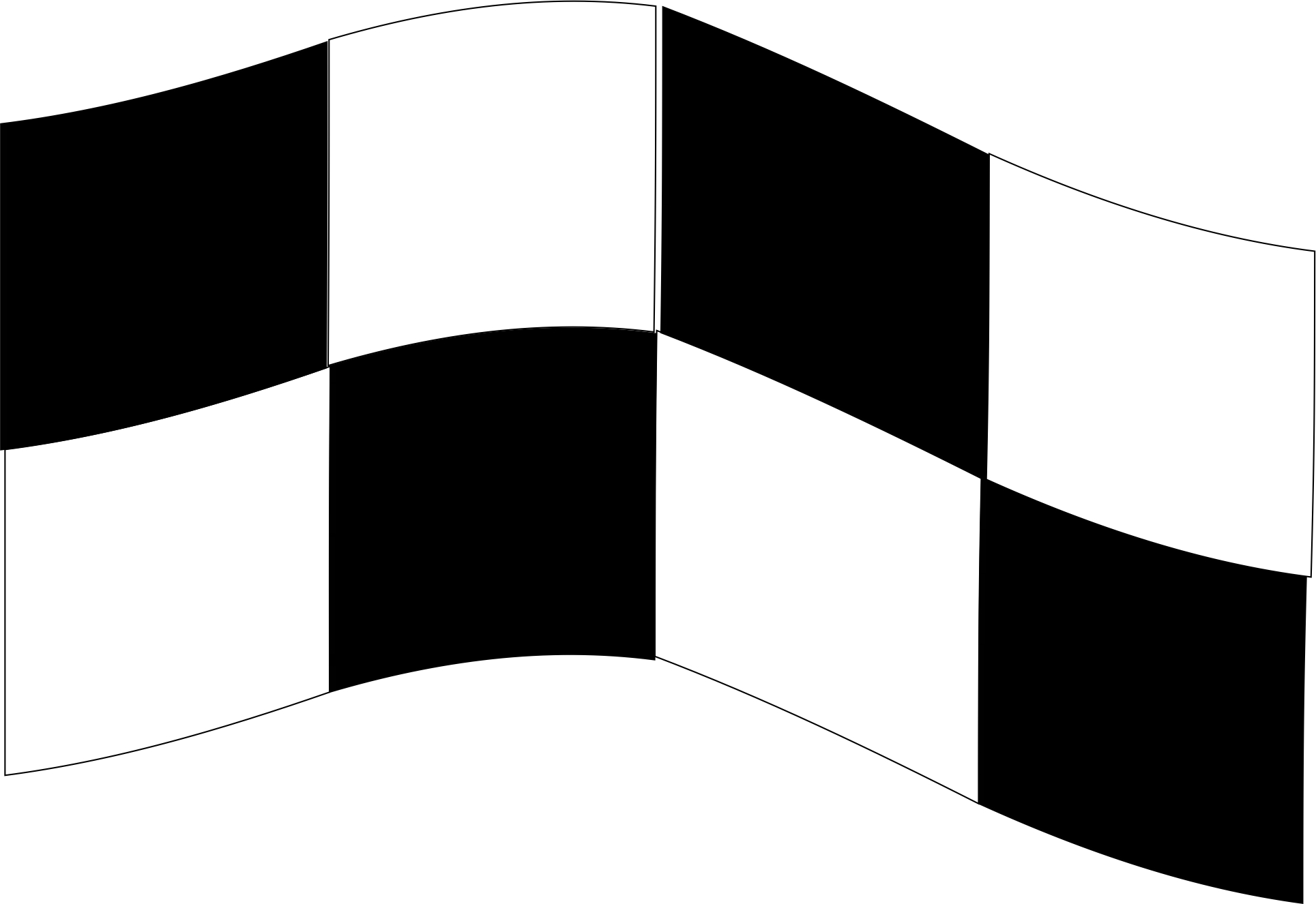

OldPaint
that pattern i showed you WAS AN EXAMPLE.......... now your in the business....so VECTORIZING shouldnt be a problem. or redraw lines in corel draw......create your own..... 5 minutes in corel was all i spent on this.............it is vector(converted to jpg to post here)
