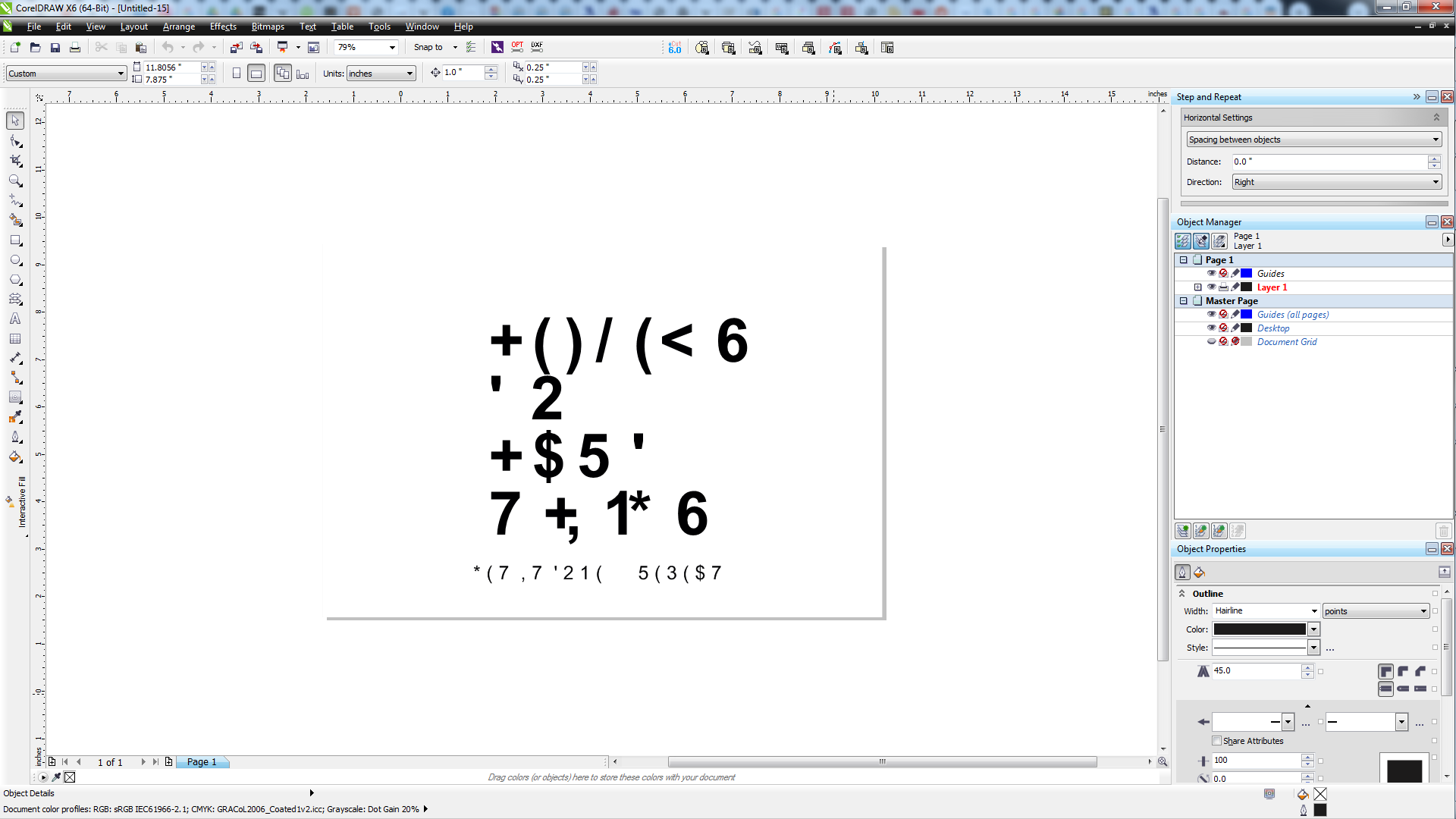

So what's everyone's version of corel here? I'm working out of x6, and just got either two boxes, or a jim jam of characters that aren't in the file at all.

I'm more curious why your would work and mine wouldn't. I tried import, drag and drop, and open in corel, all both as curves and text. Best I could get had random characters in place of the originals, but at least the font was correct and scaled properly. Every other method just gave me two rectangles.

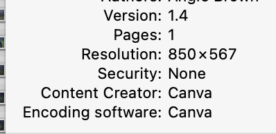

It's not just Corel that has issues with them... To avoid headaches when I get Canva created files, I try to open them once, if they don't open right, if they aren't usable, or print ready, I just smile, and flat out reject them. I don't get a lot of them thankfully.

I was just ranting about Canva files this morning. It is a SCOURGE upon the profession.
Yep. My guess is that a lot of (non professional) apps aren't tightly integrated with Adobe. Instead of developers paying Adobe for access to their advanced libraries and rendering engines, they just opt for a quick GPL library (off GitHub, for example) and call it a day. As such, we get poorly optimized results from the likes of Canva, PowerPoint, etc... Sucks for us that need high quality artwork, but I guess we were never the intended audience anyway.
