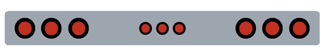

Help! I can not figure out how to get my decals to print right. I have tried almost every order of printing, and every choke/spread, but somehow it always leaves white circles. It is only 1.375 inch long by 0.15 inch tall, so I am having a hard time figuring out how to bleed the black into the silver without minimizing the red circles.
My black is printing way off to the left, so half the circle is always missing. I can't use overprint with the silver, because the other colors don't stick too well to it, however, bleeding into the red makes it disappear. Any ideas? I'm getting tired of wasting the silver, which isn't cheap!
How should I choke/bleed, and what order to print in?

So you're printing three colors, silver medal, black & red on white?
I would do this as red and black on silver vinyl.
Instead of choke/spread could you try making the black ring a complete separate piece which overprints on the red circle?
To save the silver test with another color till you get it to work.
Another option would be to print the silver (with a white prime coat) and black on red vinyl.
Correct, I am printing on white.
If I used silver or red vinyl, wouldn't I have the same problem, but with silver or red shadows instead of the white? I don't want silver spaces between the red and black, or red spaces between the black and silver.

The Silver Medal should be used as the top layer. It will overprint any other foil successfully but doesn't like being overprinted in most situations. Therefore you should either set the overprint parameter for the Silver Medal to overlap which will not knockout the colors beneath it or perform a choke and spread with the underlying color(s) spreading beneath the Silver Medal.
How do I get the red to spread under the black, and then the black to spread under the silver? I've tried to select all 3 colors, and the silver just overprints the whole thing.
Fred Weiss
