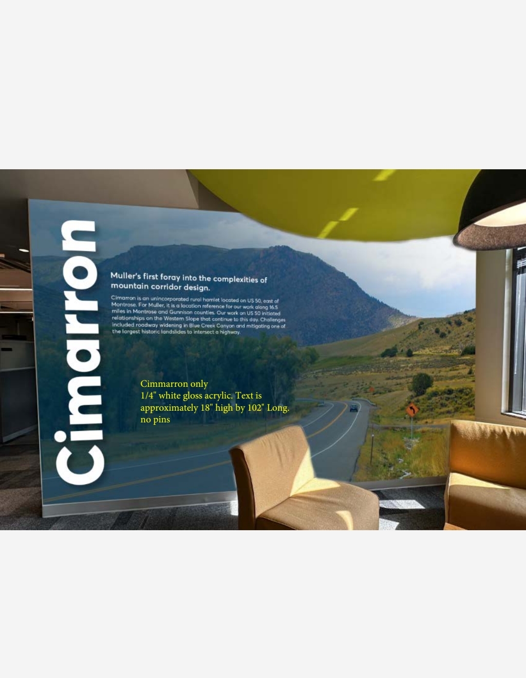

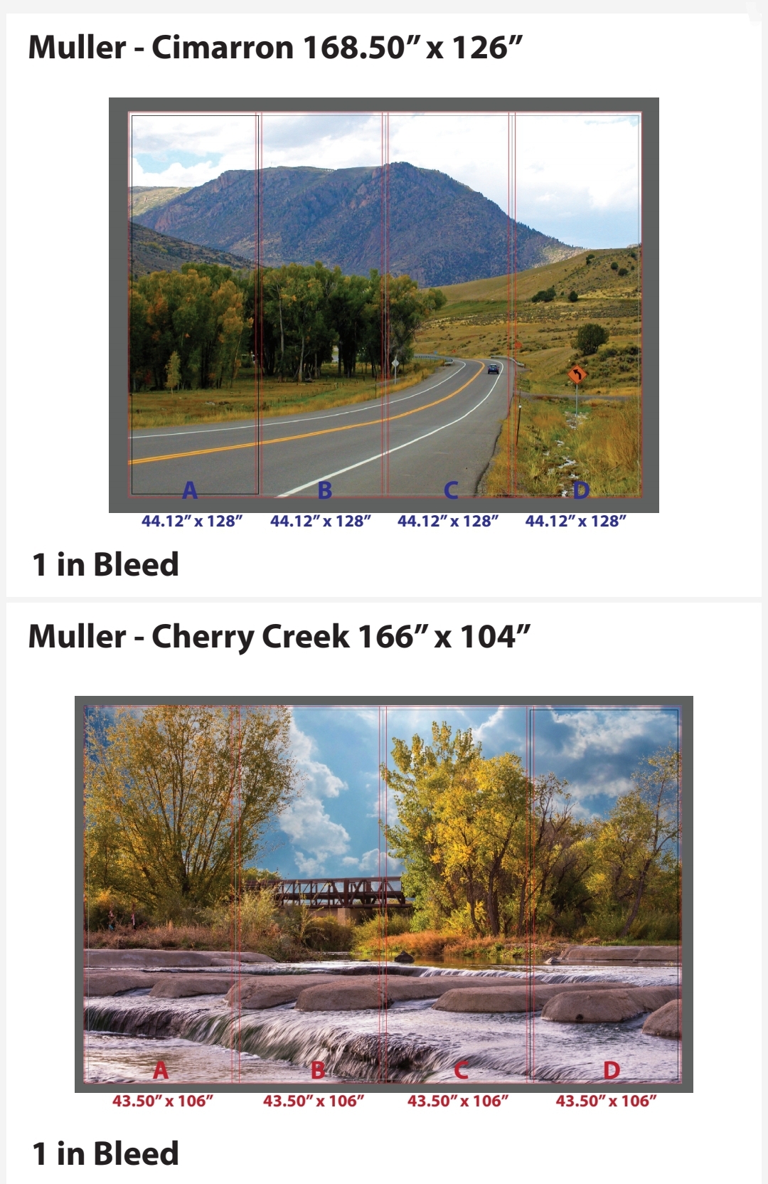

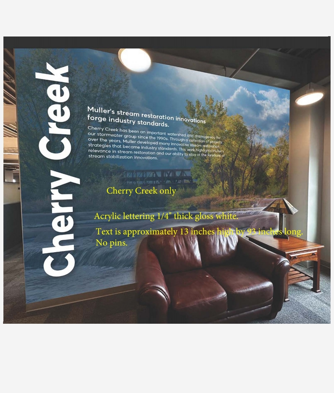

I quoted this wall mural/FCO install at $2,268. That includes drive time/mileage.
***I am only installing! I did not produce or print artwork. And did not cut acrylic letters
Mural 1 Cimarron" measures 126"× 168.5"
Mural 2 "Cherry Creek" measures 104" × 166"
FCOs are installed with Quick Snap mounting which will be done on site after I complete murals.
I will be using all my own tools and ladder.
(There is another half of the job, but I haven't quoted that for lack of details)
