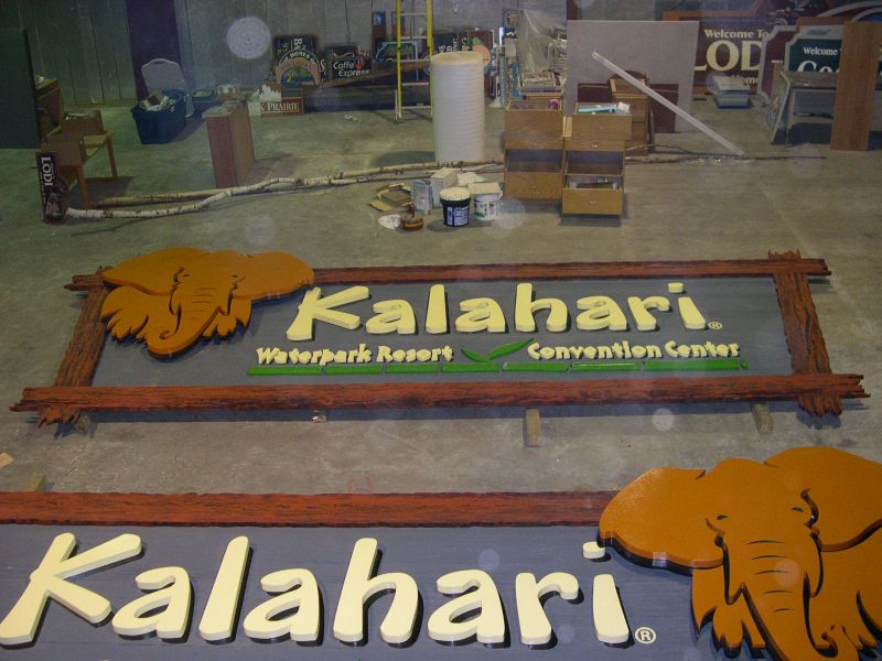

Here is another picture of the main signs almost complete.The panels are 22'long at the top and 20' long at the bottom.the framing is 2X12 redwood sand blasted,the panel is rewood and the copy is 2" router cut foam. the elephant is also 2" foam.they are supposed to be installed in ohio some time in Jan.
