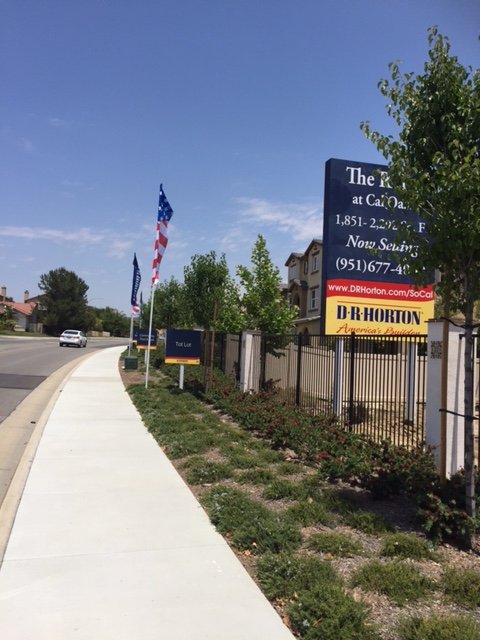

12' x 8' 1/2" D/S MDO Signs. Anybody out there familiar with this fabrication?
Angela
Any guidance would be appreciated :)

so what are you asking?
assuming you are referring to the large sign in the image since there are multiple signs.
a 12' x 8' sign is easy, MDO boards come in 4' x 8' sizes, so you need 3 sheets and then you will panel them on the pole into one large sign
We used to build those for local DR Horton in SC and GA. they are PT lumber frame with 3mm acm overlay. They usually keep them for up to two years.
