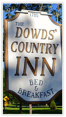

Here is the sign we're replacing that's 20+ years old. They would prefer to not have a metal sign. Generally I use aluminum/dibond materials for signage with vinyl graphics. I've never done a hanging sign this large. Advice appreciated...
That is a hand-carved sign and you wanna just do vinyl ?? It looks like gold paint, but they were generally gilded. The place is over 200 years old and you wanna put a cheap aluminum and vinyl sign up ??
Be creative and find a source for a 3D sign, be it carved or raised copy. If it's beyond your capabilities, then farm it out.... or tell them to find someone with more experience. No offense, but if this is a large sign for you and you can't figure out what to do, I think you're in over your head.

Why a new sign? Is the name changing? The old one doesn't look that bad in the photo (at least the material doesn't look bad).
If it has to be replaced a carved sign should be the first suggestion. If budget isn't there then at least a thick sign so it doesn't look cheap.
I would probably do a colonial shape out of two pieces of ACM and bond them to some scrap HDU to build up the thickness.
