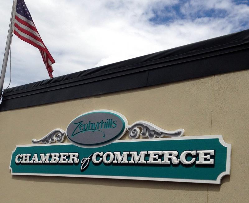

Made two new Chamber of Commerce signs and installed over the weekend. One for their side wall and the other front and center.

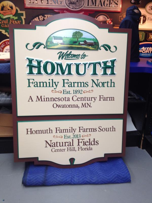

The Homuths signs are done but they are picking them up today and doing the install themselves. I hope to get a few photos once they're installed with the post and finials that will complete them.

Sweet..... looks great.
What are you using software wise to create your convex or prismatic lettering?
For all the filters and plugins Illustrator and Corel throw at you, its tough finding a good vector based shortcut for doing a freakin' convex letter.
SignManiac
The prismatic lettering is done with ProfileLab on the router table but I think we're going to shift over to Aspire 3D. I have both but my router guy says some thing are simpler to do with ProfileLab and other things are easier with Aspire. So I'll may just keep using both.

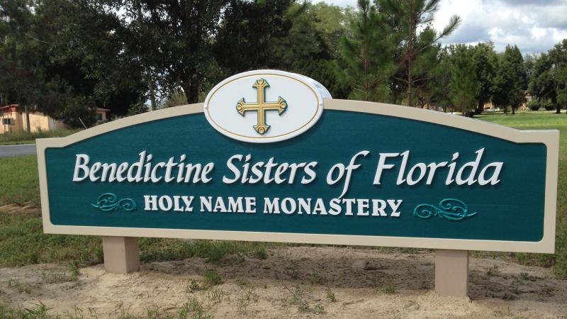

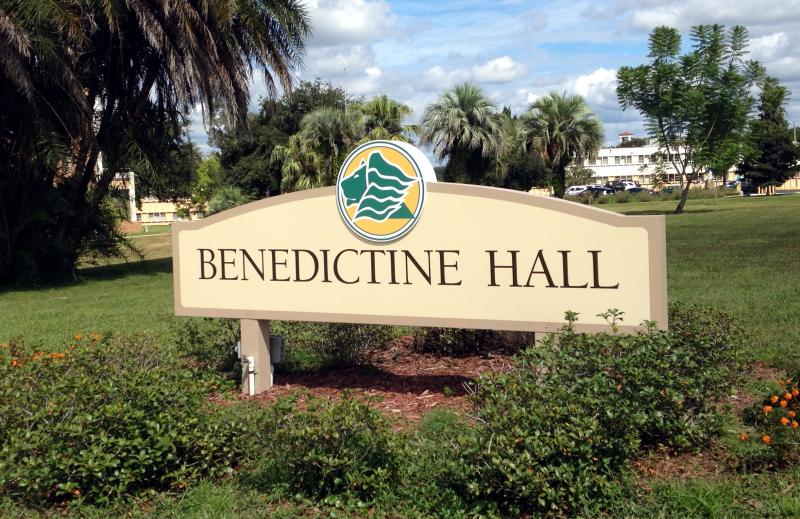

I'm sorry Z... I didn't see your question before now. Yes to PVC and Matthews paint. Here are a few more that I did last week. The Sisters sign is a modern day remake of my original sandblasted redwood sign from fifteen years ago. It's all PVC and Matthew's except the capping with is aluminum. The Benedictine Hall sign is a temporary sign meant to last about five years (LMAO) at that one. It's a polymetal face, vinyl lettering and some more aluminum for the capping.

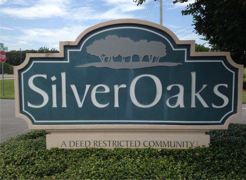

The Silver Oaks sign is a retrofit. Somebody made the original monument sign but the face was aluminum and glue on. It started peeling off. I remade it so it won't fall apart. Here's the before and after.

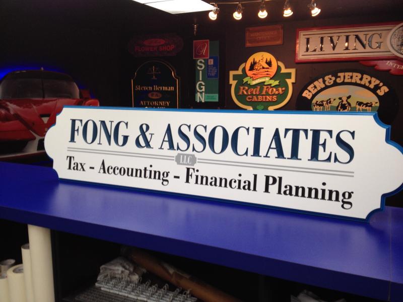

And last is a simple carved wall sign for an accounting firm.
