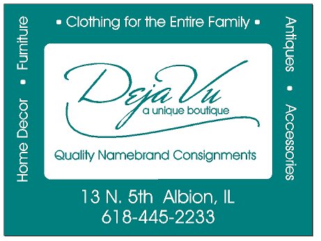

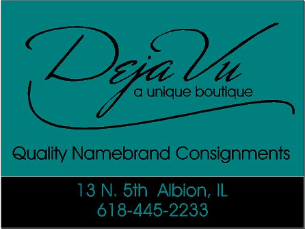

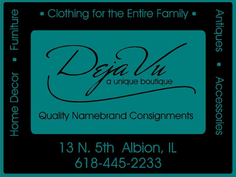

Well, here is a current sign that I have worked up. The customer wants the extra information that is on the edges included. The Teal and Black is sort of her thing as well. These are for coro yard signs....
Let me have the thoughts please...
thanks,
Ryker

Not the greatest contrast and the wording around the perimeter is distracting to me. If this is for yard signs placed around town, I would think that the message is pretty much lost completely. I would focus on what the primary message is and take out all the rest.
HaroldDesign
I'm not so sure about the text around the perimeter for a sign. A card maybe, but it doesn't flow as it is. The contrast is difficult. I think I would put the name up top in teal on black with white offset behind it, and list the other items beneath in white.
FatCat
IMO this is way too busy, not enough contrast and too many small/thin fonts for a typical yard sign. If the purpose of this sign is to gain attention from passing traffic it will be unreadable. If it is meant to be used on a sidewalk area where people are strolling past it, it might be OK.
Not trying to be harsh, but look closely at the thumbnail in your post.
What can you read?
The only thing I can read is Deja Vu and it still takes a moment for that to register.

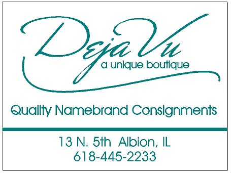

lil Details
I think your last layout posted is much better than the two first ones. There just isn't enough contrast between the teal and black. The one thing that kindof bugs me about the last one is the thickness of the seperating line in comparison to the skinny text.
just pitching thoughts...didn't really think about the line being that thick, but NOW I do...

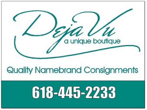

lil Details
We ended up selling the sign like this. Did 10 double sided with the teal vinyl.
Got a roll of vinyl that was old or something on the first 16 faces. It would not weed worth a crap and you could see the adhesive string every now and again. Hit the end of that 10 yards and the last 4 out of a second roll weeded like I KNEW it should...
Frustrating to say the least, but my wife and me worked together today and got along very well....got some good practice in as well....
