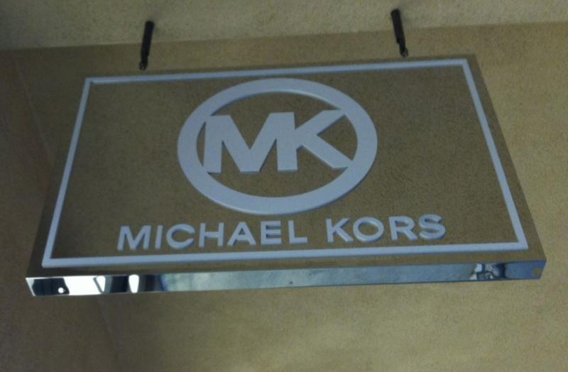

We have a request from a local merchant at our mall for a custom acrylic sign. The sign is going to be 18" x 24" 1" thick clear acrylic hung vertically from a ceiling. "See attached Michael Kors sign as the example the customer liked" We haven't decided yet, as to using cut vinyl or router acrylic for the lettering.. any advice on this? "The sign will be single sided" Also, if you look at the picture of the Kors sign, the customer wants a shiny frame around it, and then mount faux lightbulbs to the shiny frame. How would, or could you mount a frame to 1" acrylic. Also, the cable mount from the ceiling to the sign, what type of hardware would you recommend? We can drill into the top of the sign with an acrylic bit, but the hardware we are unsure of.

custom cut white acrylic for the MK and graphics mounted to the clear . on the edges hard to tell if it has some sort of a chrome finish or if it's just a polished edge.

I agree - the MK sign looks like polished stainless or similar - not acrylic (except for the text).
1" acrylic is heavy. An 18" x 24" would weigh a bit over 17 pounds...so if you go that route, you'll want to make sure you're hardware is sufficient. Gyford has plenty to choose from for your hardware.

hard to tell from the pick. it does look like clear acrylic because you can see through it but the edge either has a polished finish or has some sort of chrome vinyl or something like that applied to it.

after looking closer you guys are right. its the reflection that i see not clear through. polished/chrome alum or possible stainless?
Pat Whatley
If it was clear acrylic wouldn't you be able to see where the mounting hardware was inserted?
A chromed metal sign makes installing the faux lights easy.

If you have a CNC machine definitely route out their logo out. If not, etched vinyl would probably look okay.
Looks to me like those edges were flame polished. If I were you I would get the diameter of the bulbs and drill holes for the bulbs. Flame polish your edges and then insert and secure the bulbs with silicone.
