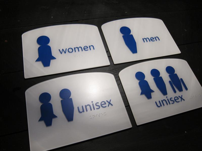

visual800
Came up with own cause Im very bored with the run of the mill bathroom stuff and sent them to whitewater graphics to be reproduced. they are very reasonable and pretty quick

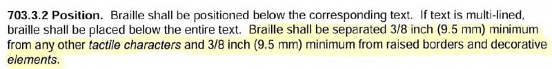

Braille has to be below the text (except for as noted for elevators).
