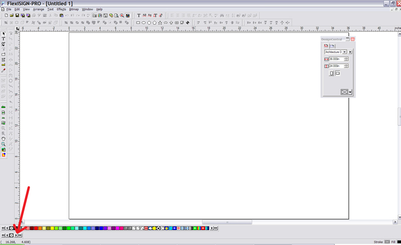

1. Create a new color palette. View > Color > New Table

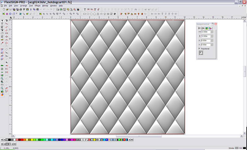

2. Open a seamless texture tile. In this case I am choosing a stainless steel texture such as you might find on a hot dog cart.
3. With the texture tile selected, go to View > Color > Define Pattern and click it. Choose New Table in the dialog that follows. The texture has now been added to the swatch palette table. Save the palette table by going to View > Color > Save Table. Give it an appropriate name.

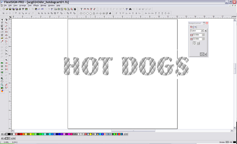

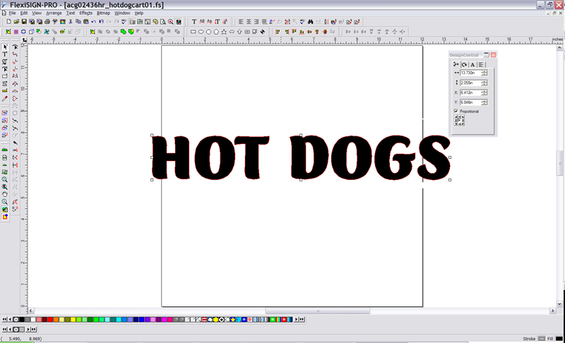

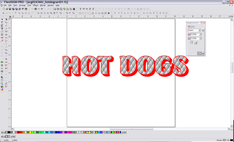

4. Enter some text or draw or import a shape. Size it for your layout.

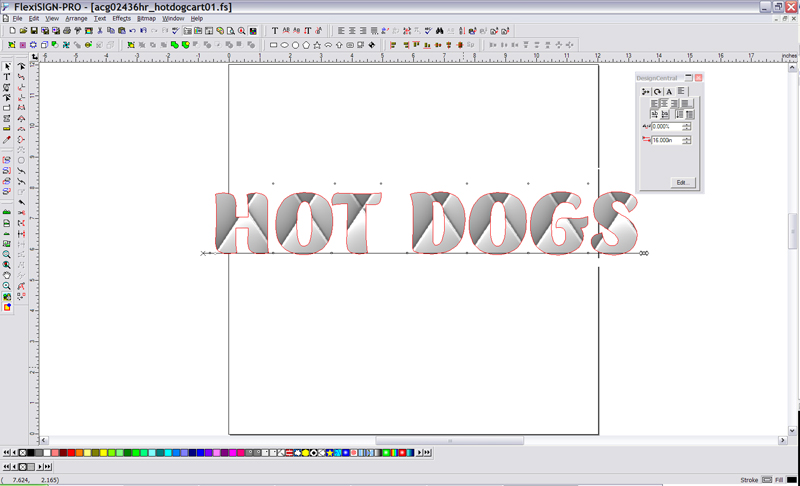

5. With the object selected, click the texture on the palette to fill it.

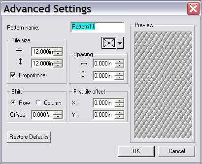

6. With the object still selected, double click the texture on the palette to open the Advanced Settings dialog. With "Proportional" checked, adjust the Tile Size setting to arrive at the scale you like. In this case I reduced the size of the tile from 12" to 3".
7. Add whatever effects you like.
