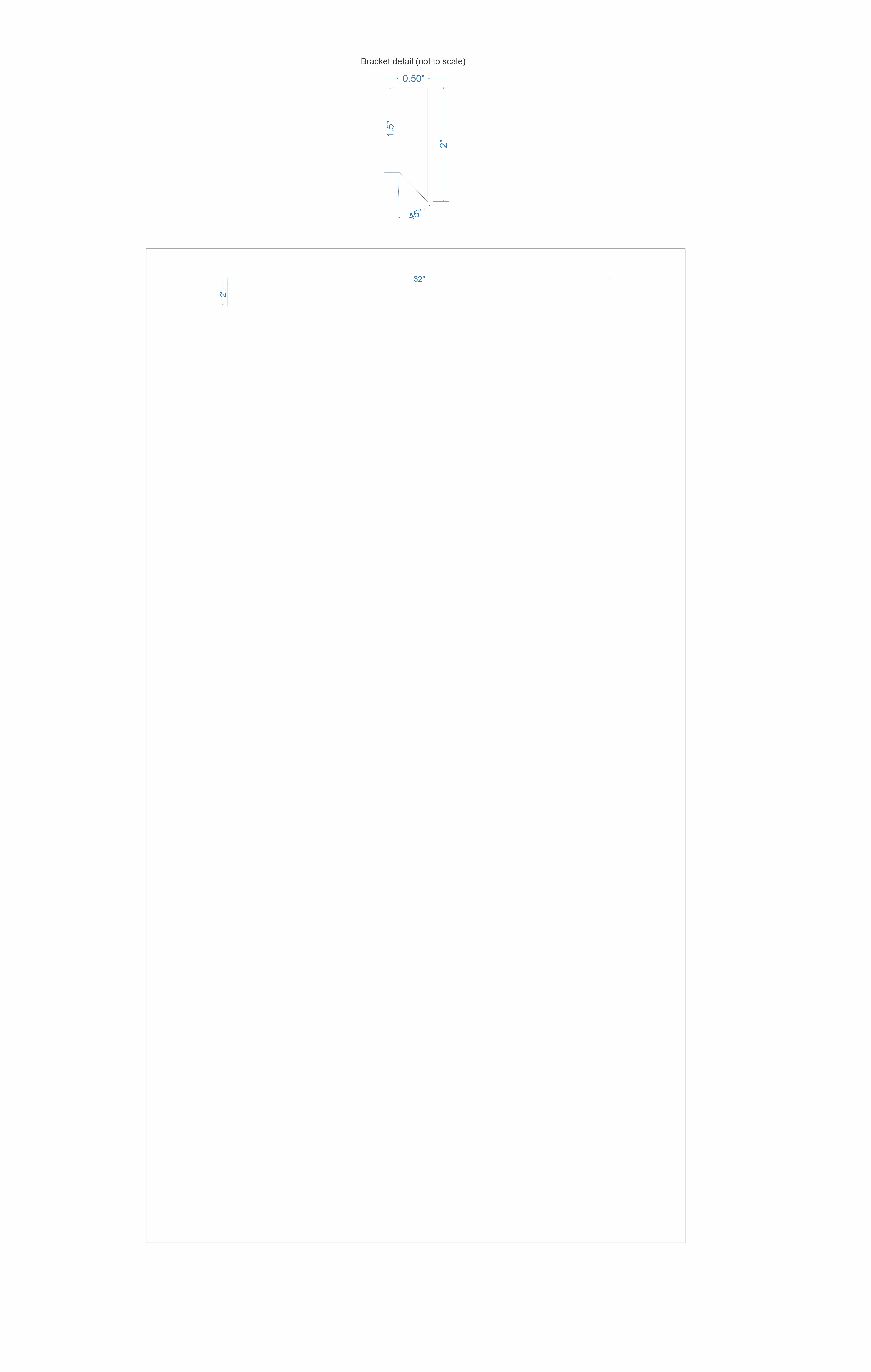

Long story short, we made a few showroom display panels for a client last week....built to their specs.
Biggest panels were roughly 45" wide x 83", vinyl mounted to 1/2" thick gator foam. They spec'd a 32" wide wedge bracket/french cleat on the back, and spec'd that it be made out of the 1/2" gator foam.
We made the panels, stuck the brackets on with Mega Tape double sided, which seems to bond the gator foam to itself really well. I pulled and pulled and couldn't get any to budge.
Customer received panels yesterday, said they looked great. 3 hours later I get an email saying one of the brackets came off and now they're worried about all the other ones.

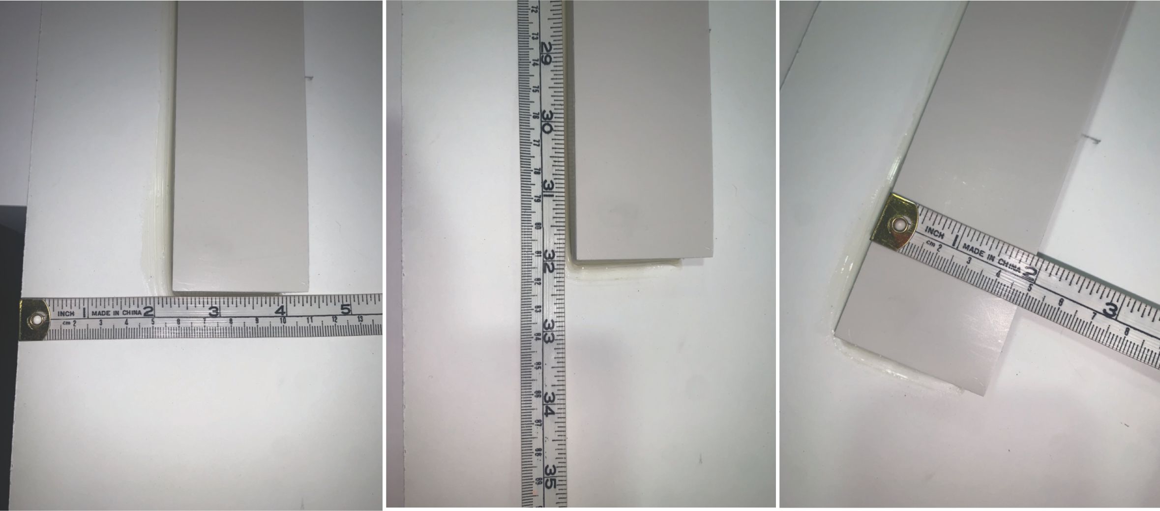

When they had originally sent me pictures of some of the existing brackets, it looked like someone slopped on some sort of glue all over the place to mount the bracket.
The area that is to be bonded to the board is only 1.5" x 32" so really not much coverage given the size of the panels. (pics attached) Using a thin double-sided tape was definitely an oversight, given the rigidity of each panel and the potential for warping.
Any thoughts on what would be a good product to glue these things back on? Something that will set up fairly quickly so we don't have to tie up the whole shop all day fixing these things?
