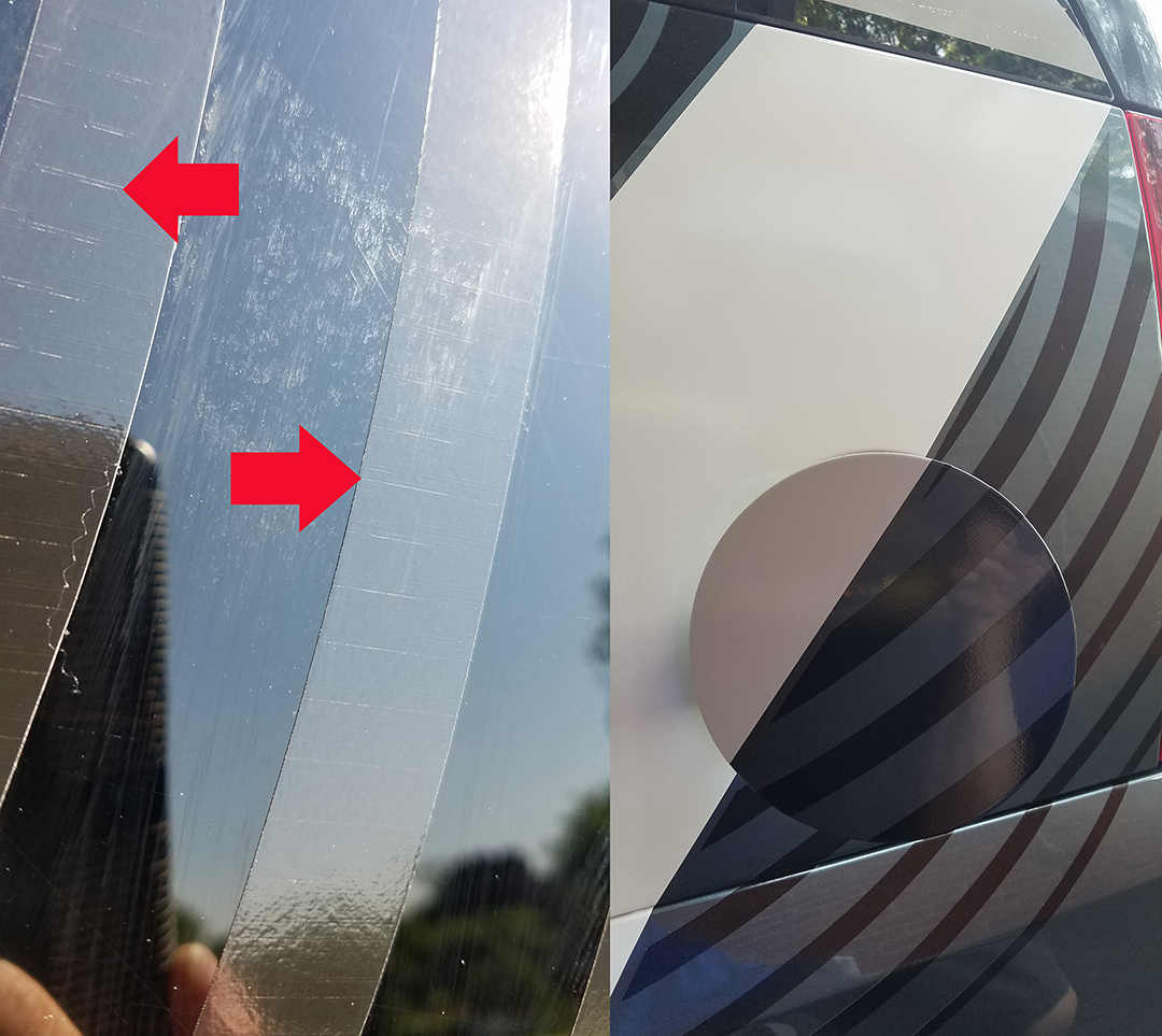

Any idea what causes these marks?
Tony Rome
It is not a squeegee I am pretty sure it was there before laminating but not positive.
Any way it could be printer profile because I do not like the profile 3M gives you for the Roalnd sp540V (GCVP actually looks better for me).
Material IJ380C
Roland Versacamm SP540V.
THANKS!
I included a pic on the right for what it looks like zoomed out.
The pic on left is zoom in of IJ380C contour cut on window.
MikePro
aye, looks too uniform to be squeegee scratches.
more like the sheet cutting blade on a printer/plotter dragging across the surface, most likely due to vinyl lifting up during operation.
Tony Rome
Ohhh, that's interesting. Especially since it is not happening anymore.
