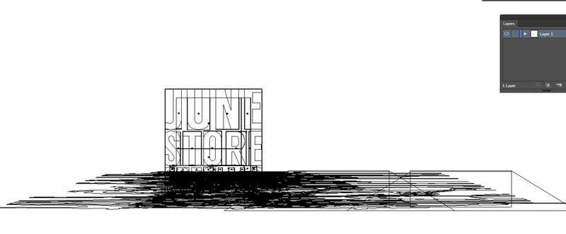

You mean like this?
A simple 5x6 show card. That Tokyo Subway line drawing looking stuff on the bottom is a masked wood texture (vector) that only displays as a 1/4"strip on the bottom.
Gang up about 20 of these and the RIP starts crying as it tries to load them in.

Yup, that's an extreme example. But exactly what I was talking about.
Liked the part where the RIP starts crying, that was great!

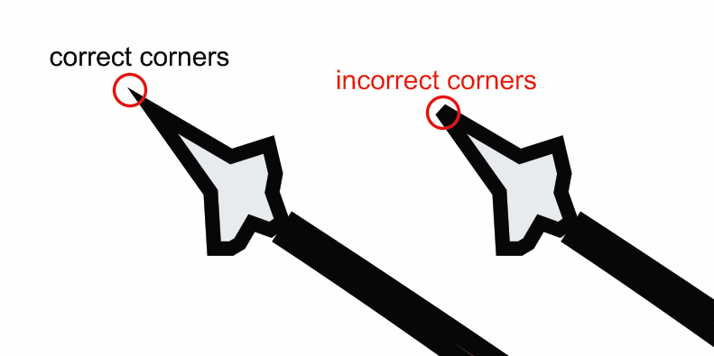

I, myself, refer to my career as "graphic designer" not "sign designer" though that is the name of the place I work. A good graphic designer has to consider the end product in all facets. You are wrong if you think you can rasterize a file and "hide" any imperfections. Below is snipit of the ai file as given. What you see is only a small portion of the problems. Luckily all I needed for this sign was a rectangular decal applied to 10mm pvc. None of the outlines were converted nor were they set to scale with object. When I did set the outline to scale the corners were not set correctly (see other snipit). All of these flaws were somewhat easy to fix in corel but still time consuming just the same. btw I hate ai with a passion but it's a necessary evil in this industry.
If designs were done correctly from the get go we would all be in a better place!

Your screen capture show's flaws in the design that would show up regardless of
the end product, that's different than it not being plotter & router ready, or giving you issues
when you bring it up to 1:1 scale. I don't know about other programs, but converting strokes to outlines
is pretty easy in Coreldraw.
Like I said, I understand your rant, welding a shat ton of wire outlines together to make it plottable sucks,
but it has always been much easier for me to make the changes than to try and explain it to a designer,
who has no idea of how to make their "pretty" design less of a pain in the @ss for me.

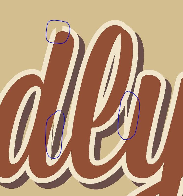

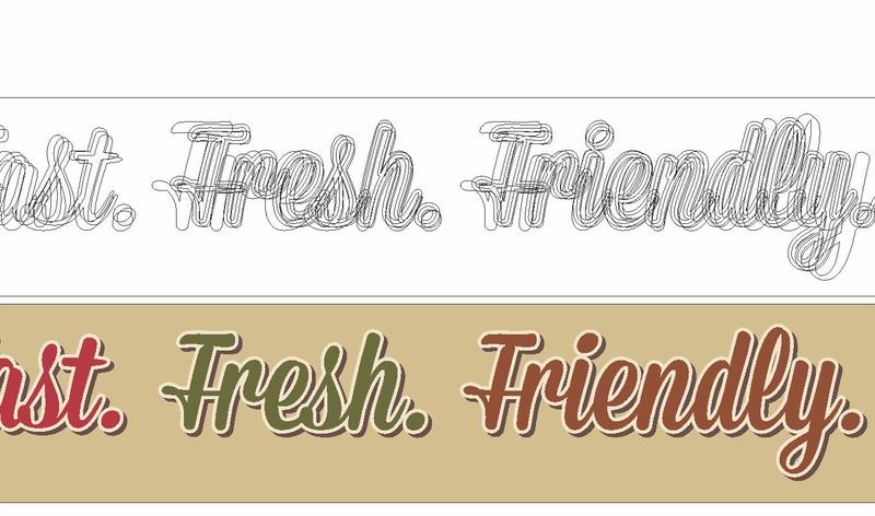

Pure coincidence, I just got done printing a perfect exsample,
the picture is of a backlit, channel letter, pill sign, I was printing today.
If I had to do this signage with plot vinyl, it would have been a nightmare
to make the vector right, but I'm printing it, so it was perfect as is...
except for the spots in the close ups, that's 100% their fault.
