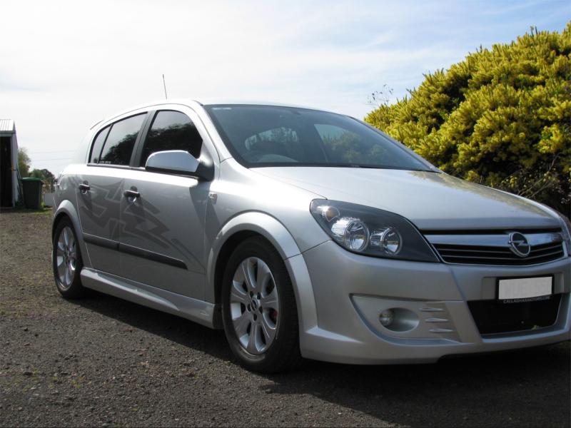

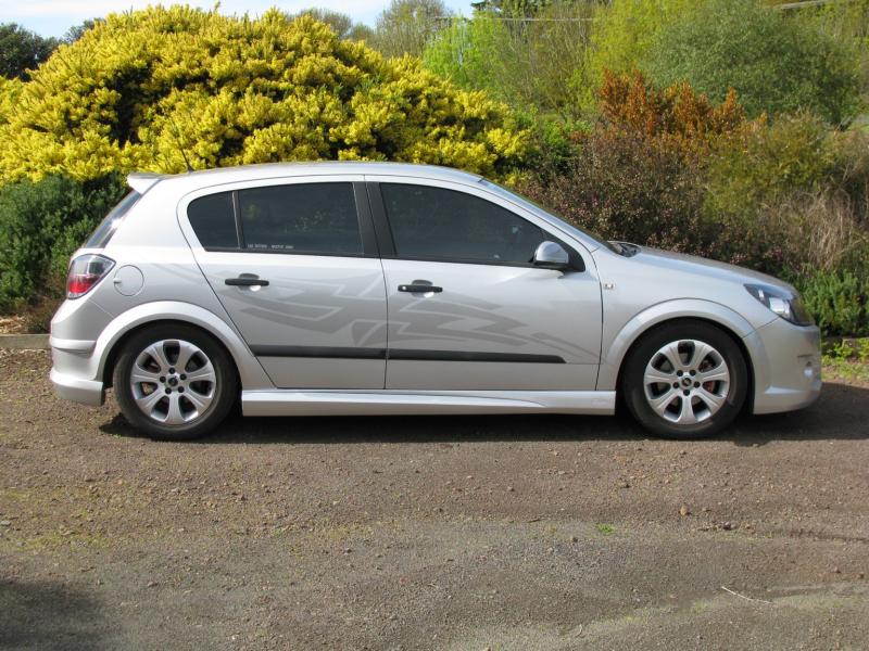

Was a bit bored yesterday(Sunday) so decided to play with the wife's car, she picked one of the designs I had done (naturally wasn't the one I liked) and I slapped it on. The Avery Tattoo vinyl feels different to normal vinyl (probably not) like a more thicker plasticy feel and is very sticky, so when applying, don't let it touch down anywhere you don't want it to stick. It stretches very easy, conforms to curves no problem, but attracts dust and lint like you wouldn't believe....I did it dry, but I think it may be one of those vinyls better off laid wet. Anyway I have put on the windows advertising for "Car Tattoos" and will leave it on for a few months to see if I sell any.

Hey S'N'S, thanks for sharing. I like the outcome and have just read the PDS. I'm definitely gonna try this and get some on my next order from Spandex.

Looks great SNS, very nice car too!
Have you tried multiple layers to get extra tones or isn't that possible?

I have used window etch film which gives the same result.
SC
Originally bought this stuff to do a customers bike...until he crashed it.
The window etch is about 30-40% lighter and I was thinking of mixing with the Tattoo film on my bike, bike is painted with Harlequin so I'll have to do test peices and put it out it the sun to see how it looks.
JJ_Holland, yes you can layer for extra depth in colour, noticed that when I overlapped some pieces before cutting them off.
TIZZ, I think it's about $122 +gst for 10meters.
Good for drop shadows on cut lettering too.

Long ago before we had a digital printer, we used window etch film on some designs for fade effects, it actually worked pretty well. Used it all the time for ghost flames on cars. Looks good, hope it works for you! good luck!
