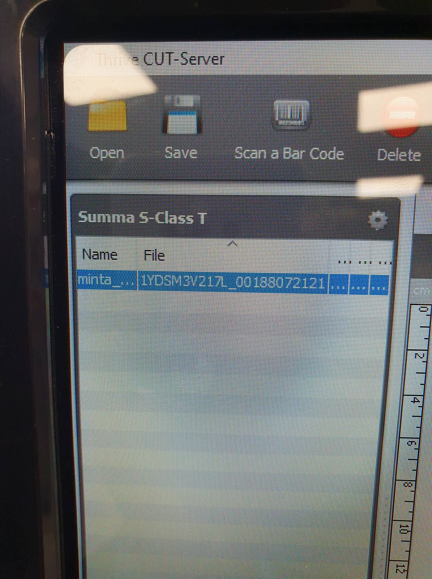

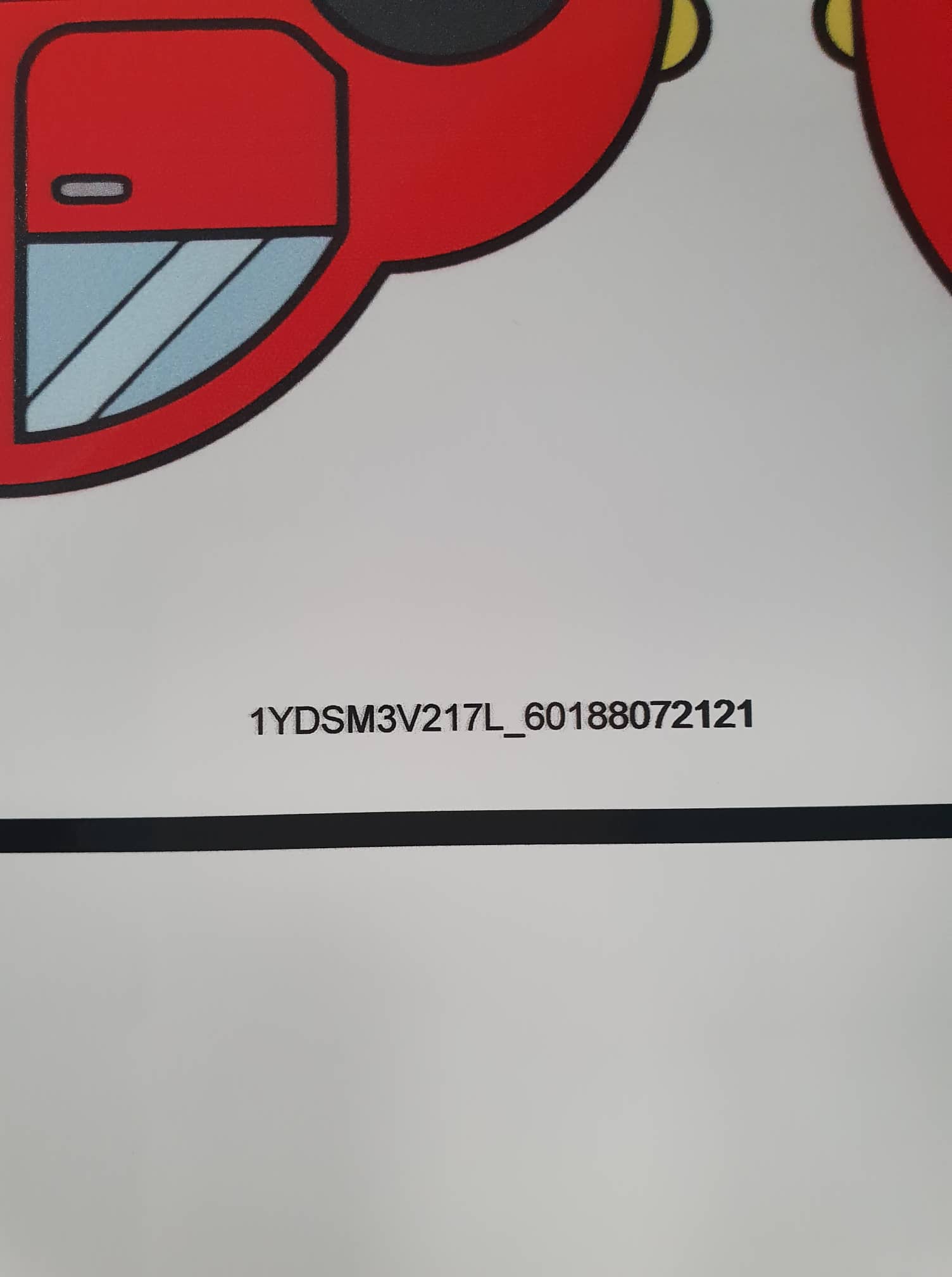

I am using ONYX RIP-Queue (version 18.0) and its CUT-server with a Summa cutter (S2 class) and I have noticed a problem that makes it impossible for my cutter to read the barcode. When I print the barcode is on the paper, however the number next to it is not the same as the number that appears on my computer. There is only one number that is different. The number in the CUT-server shows a 0 and the number on the paper is a 6. I have no idea why that happens. I tried to rename the file and the cutter started cutting but as I expected it was making a mess.

And what is the code on the other end? Is that matching?
If I remember correctly correctly that's how it's supposed to be. That way it knows in which way the work is aligned. It will still find it with the barcode if you have everything else working properly.
Maniko
The code on the other end replaces 6 with a 9 so it's not matching either.
balstestrat
Problem Solver
Okay but that's fine, it just tells the way it's put in. Only the end has to match. So if your barcode is not working you have some other issue going on.

You should have two barcodes, one at the top and one at the bottom, one with the 6 and one with the 9, as mentioned above it's to differentiate front from back.
FrankW
As mentioned before, the different leading number shows the direction in which the print is loaded. Onyx generates two different cutting files, one for each direction, but will use only the one which fits to the direction the print is loaded.
it should work.
