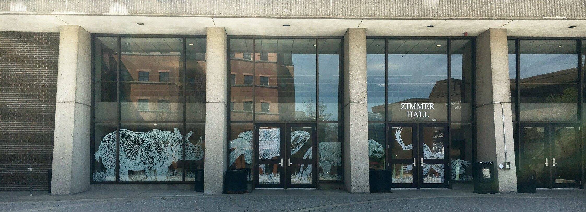

White on Clear from an Epson s70675. The new series should be even better, but we went for Dual-CMYK instead since we already have a printer that does white and we do way more wraps.

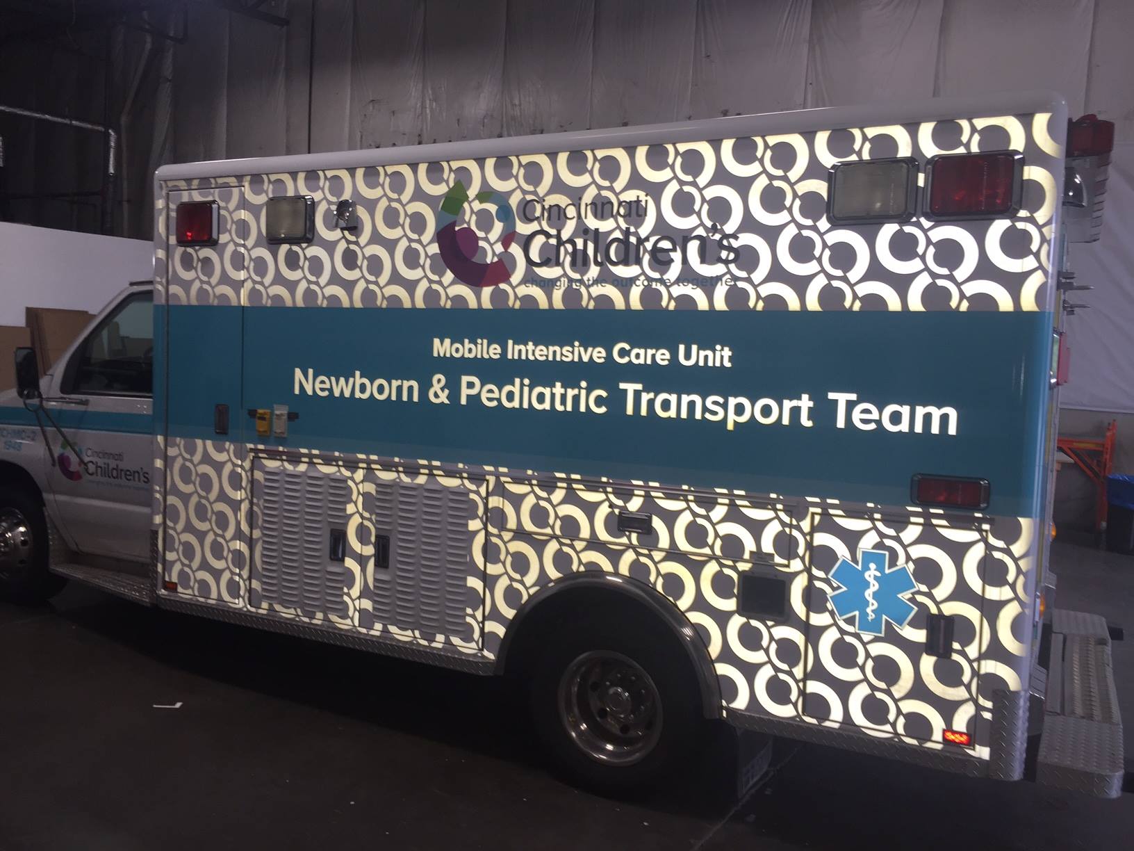

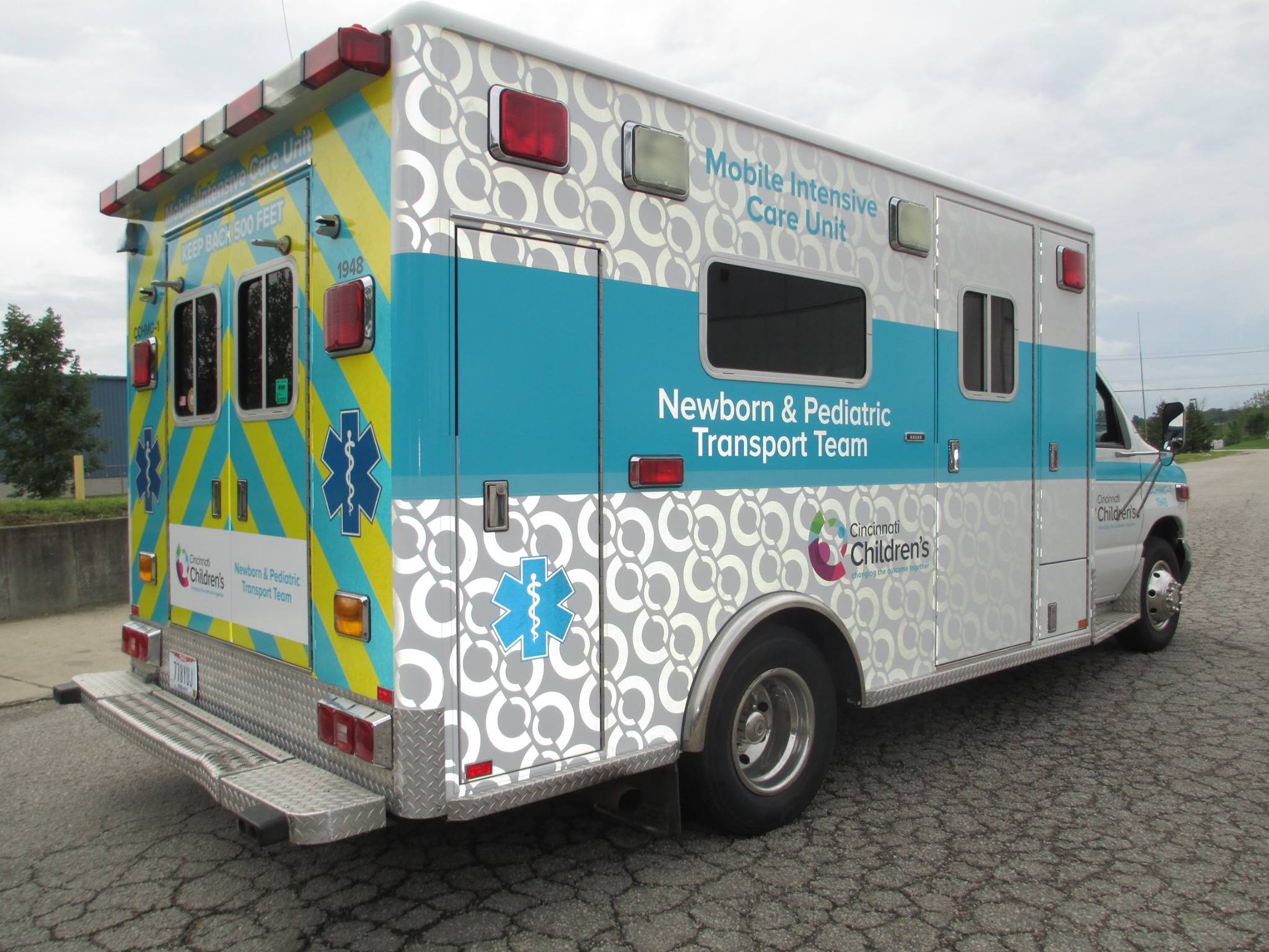

clarizeyale
Yes, hard to see in the daylight, but REALLY gets your attention in the right light or at night.
Kinda like the "stealth" black reflective on black cop cars.
White on 3M IJ680CR-10 from an Epson s70675. (crazy looking effect!)

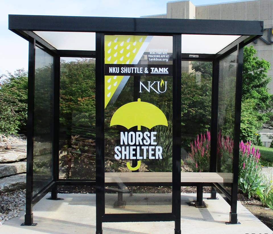

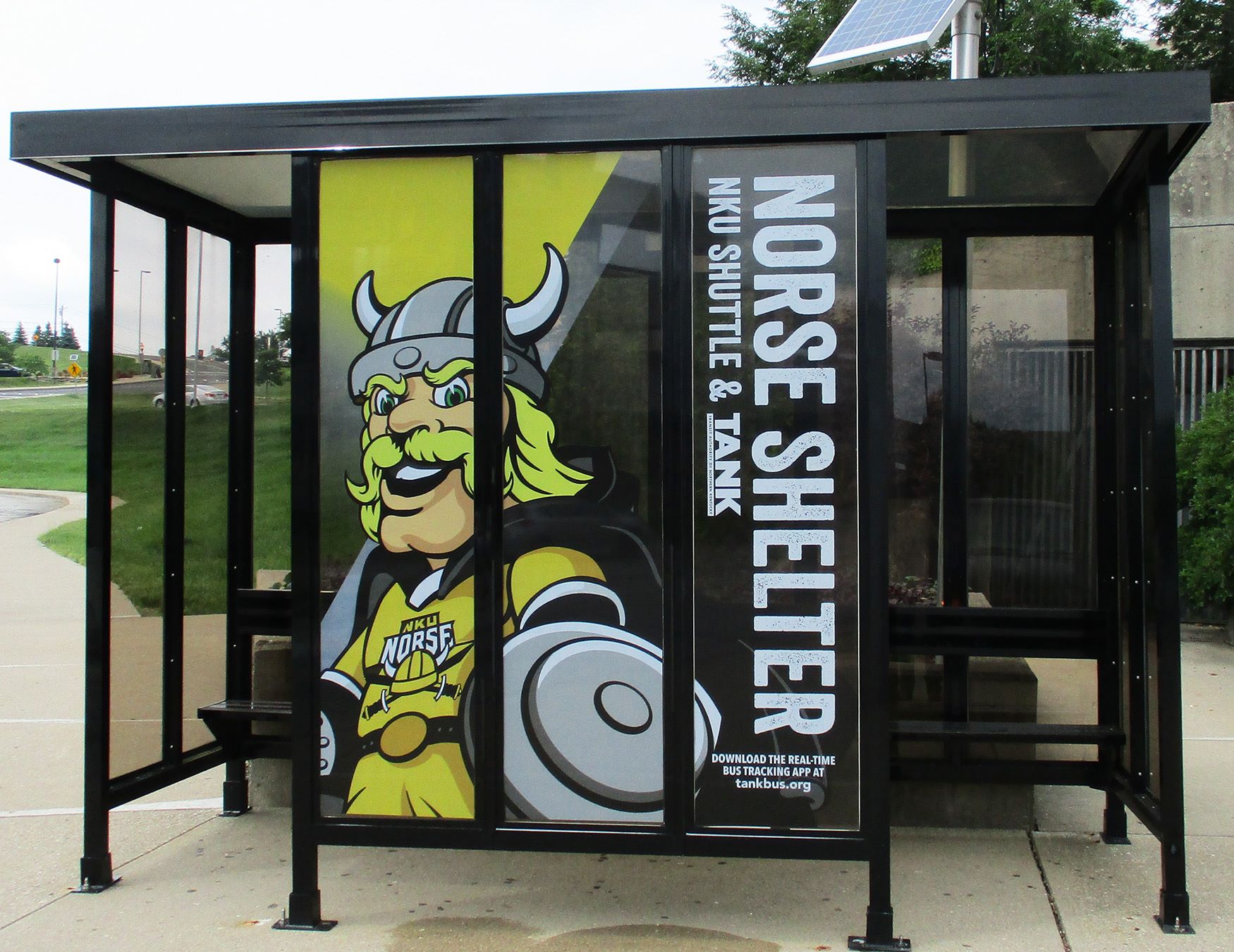

Spot white and color from an Epson s70675 on 3M clear (wet application). Sorry the photos aren't the best, our installers aren't photographers.
