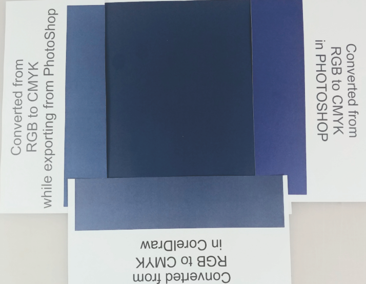

I just had a bunch of file I had to convert from RGB to CMYK & decided to see if how I went about it made a difference, & it did make a large difference.
1- I converted from RGB to CMYK in CorelDraw
2- I converted from RGB to CMYK while exporting from CorelDraw
3- I converted from RGB to CMYK in Photoshop
4- I converted from RGB to CMYK while exporting from Photoshop
I ended up with four different colors & none of them were that great.
I know CMYK has a smaller spectrum than RGB, which is why some colors will never match, but
thought someone here might have a program that does better than most, or a different technique.

Profile mismatch will shift colors. If you're preserving input(embedded) profiles that will also cause issues. Basically you need to know what you're starting with then convert depending on the device(destination profile).

What is the color profile that you are originally using in Photoshop? Usually it defaults to RGB 8bit, but this is not the best color profile to be designing in.
In Photoshop go to Edit > Convert to Profile. Normally sRGB is used to design for web. Adobe RGB 1998 is used for print. Normally just normal CMYK profile Working CMYK Web Coated v2 does just fine for converting, but if you are having trouble another solution can be to convert it to U.S. Sheetfed Coated v2 and see if that makes a difference.
If converting color profiles in Photoshop I was taught to never ever ever ever EVER, Go from Image > Mode > selection (unless doing a simple color --> grayscale conversion. But always use the above method.
I was taught this not by my design teachers but by my printing teacher when we jumped on the big 4 color litho presses. Haven't ever really designed in a different color profile before and always convert files using this method, so I can't say much outside of that.

They are not my files, I think they were provided by the customer.
Another designer in another one of our locations needed help and sent me about twenty files to order out for him, the only thing I did was size everything correctly and converted to CMYK, because the vendor only accepts CMYK files.
It's amazing to me that by changing the method of converting in the same program, it made such a huge color shift.
Below is a printed test I did, the middle color is the original;
Andy D
Where did you get the original swatch from?
And if this vendor is chosen by the designer at another location, then I'd ask that fellow how he goes about determining PMS to CMYK values for this vendor.
I only had the files, the original swatch was the RGB file, printed from reader to one of our professional paper printers.
On this particular job, I talked to the designer and he told me the blue wasn't critical, it was a random blue he picked.
I really only wanted to know what people's preference was when making similar color changes, mine has always been Photo Shop, & it seems it is for many others as well.
