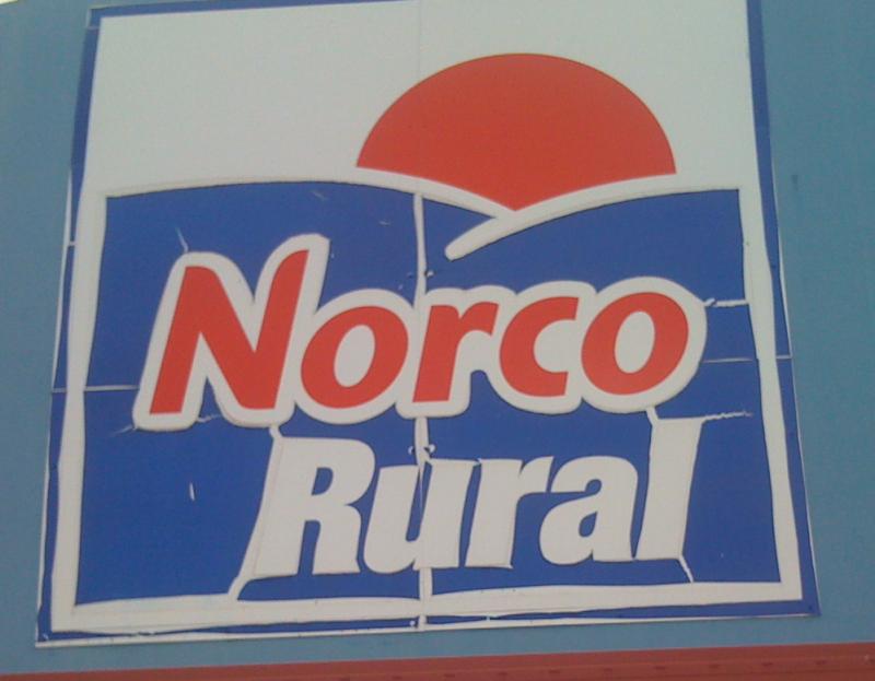

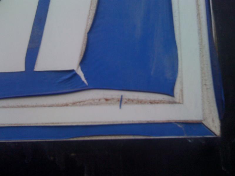

During late '07 and early '08 we rolled out a rebrand across 20 stores regionally. I recently got a call from the client (very politely) checking if what she was seeing on two of the signs was meant to be happening... I checked it out and nearly fainted.
The signs were put together using Oracal 751C King Blue 049 and Light Red 032 on Dibond brand ACM. The red is fine but the blue on this sign and one other sign at that store has pulled up and curled in on itself and turned to flaky brittle filth. Has anyone seen anything like this? The sign in the photo is 3050x3050mm, with a vertical join in the sheets and a horizontal one in the vinyl. All the joins were overlapped 5mm.
I'm doubly buggered because there are another two signs identical but for size at the same site, and the vinyl is still good on them. Not to mention the potential of another 80 signs ranging from 1000x1000mm to 8000x6000mm going bad...

you better get your Oracal rep to see them PDQ!!!
I remember originally Oracle 751 series was not a real cast product, but they changed that at least 5 years back.
What is the vinyl applied to? could a contaminate have gotten onto the substrate?

The vinyl is sold as Premium Cast Vinyl 7-10 Year. It is applied to Dibond brand aluminium composite sheet (part of the Alucobond family). All flat wet application with a small amount of plain (quality) detergent.
The suppliers are looking into it and have been on to it which was a relief. No word on an outcome yet though so we'll wait and see.
At some point in late 07 there was a colour change in the vinyl. We were buying 50m logs of 1220 wide vinyl and had a lot of offcuts which were rendered unusable by the colour variation. The official line was that the vinyl was changed due to a "formulation optimisation" but it was within their tolerance. It wasn't within mine, but the supplier made good on my estimate of lost offcuts...

I am going to add that the vertical seam in the substrate had something to do with the split in the blue vinyl because it seems to follow that seam down the middle. Also you mentioned a wet application which also adds to the problem.
The dirt started collecting around the edges even before it started shrinking, so the water was not completely gone under the vinyl where it got to the edge and sat. And never adhered properly.
The other 2 signs at that location.? Facing which way or under overhangs?

I know from our workflow patterns that the sign would have sat in the shop for between a few days and a week prior to installation so it should have dried sufficiently. The specs on the vinyl recommend wet application using a small amount of detergent. Even suggest a brand of detergent.
The other signs are external facing N/E and S/E so not so much exposure to full sun.
The bits that get me are where the vinyl has just pulled apart on itself and why no damage to the red???
I read in some forums a while back about similar issues with blue vinyl but from memory it was another brand. So far no other stores ion the rollout have reported problems, so fingers crossed...

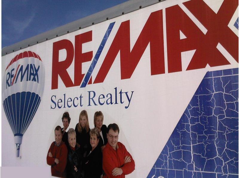

Surely you remember this?
This is also "king" blue & red, from the same manufacturer. Mine was on for 2.5 years before it went to chit in a hurry. I'm pretty sure this was done in May of 07.
Your problem has nothing to do with a wet application, or which way it facing......simply, they had a bad batch of this particular blue. Other than this one instance, I've never had a problem with "O", and still use quite a bit of it today.....but I do shy away from their blues.
EDIT..... Mine was "classic" blue, not king.

Do Oracal make the same King Blue colour in another grade of vinyl?
It's not unheard of for suppliers to switch grades depending on what they have in stock or what they want to shift. If King Blue comes in various grades then I'd be suspicious.
If it is the right grade then Oracal have a serious problem... the damage on your photos is exactly what happens to calendered- the film shrinks like made cracking and splitting as it battles with the adhesive.
Whatever the issue Oracal is at fault.
Wet app on branded Dibond is no problem. Vertical seam overlap on dibond is no problem (dibond has a thermal expansion factor smaller than any other sign substrate).
From what you've said you paid to dollar for one of the best sheet substrates and followed best practice by specifying and using what you believed to be a high performance cast- I can't see anything negligent in your processes.
