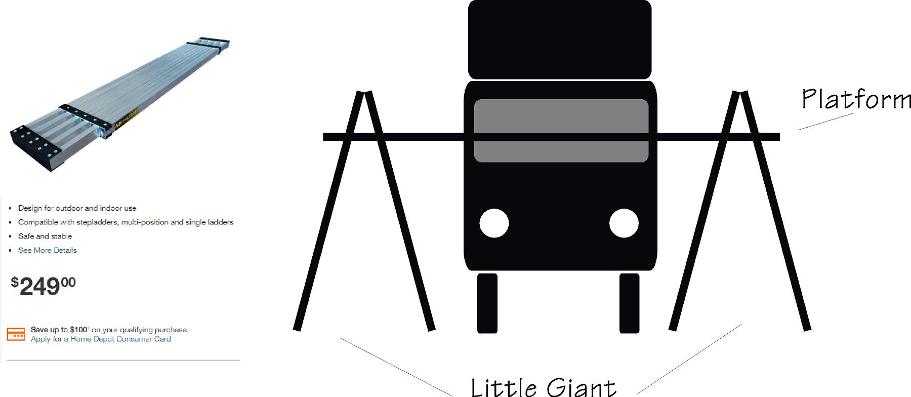

This is how we do it - see pic

We use a walkboard like that and ladders to do the sides of box trucks and semis. We use it on some other installation jobs like putting Gemini letters up on inside walls of stores and offices. Definitely not a one-time use item.
