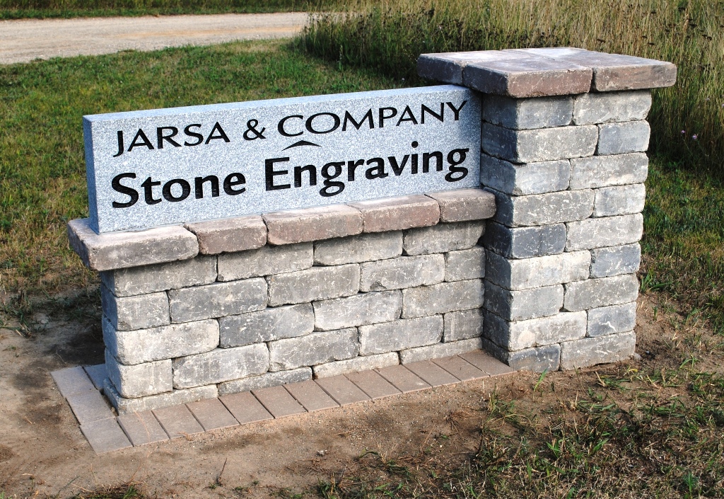

A bronze that large will still need a monument to attach it to.
Contact your local monument shop. It would be the most economical to sandblast it in granite. It'll be there for centuries and will require very little, if any, maintenance depending on how they cut the letters.
This is eleven years old and still looks like it did from day one (it's double sided). I did all my own work, but I believe I only had around $600 in materials back in 2012. Since it won't be here for centuries, I set it on a compacted earth foundation, and laid the blocks with construction adhesive. The granite measures 16" x 48" x 4" thick.

Looking good!
