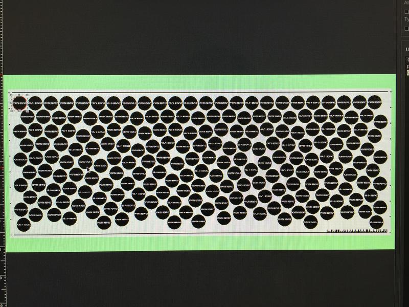

theres the file, with all the marks.

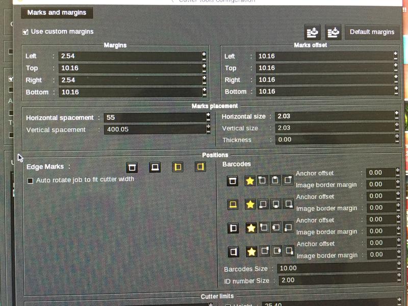

the settings for the marks.
All this done before the job is sent to RIP/print
Once printed the cut file is generated, the cut file is created with the marks, right? but then when is sent to the cutter this happens:

I kinda "over marked" this job, cause last job had the same problem, it missed a couple of marks but still did the cutting all right. So this time I put a lot of marks to see if it was a one time thing or a regular problem with the upgrade.

The parameters of the markers are not "written" in the barcode, the barcode stands for the name of the cutting file. As long as no error message appears after the barcode is read, the plotter finds a cut file belonging to the print. As long as the plotter correctly start scanning markers the OPOS-commands are set in the file. If the plotter do not search for the markers in the correct position, caldera have written wrong parameters into that file.
Try to reduce the number of markers and resize the job to a larger size. I had a similar problem one time with Caldera and jobs shorter than 50cm. Try to reset the OPOS-Settings in caldera to the defaults

Your registration marks are too close to the edge of the media. The stock setting for the Summa won't read marks wider than the outer main pinch rollers. There are 2 solutions for this. The easiest is to adjust your job in the rip so you have margins of at least 1.5" on both sides. The other option is to change the setting in the summa front panel to enable extended cutting (I forget what menu it is in and the exact wording of the setting).
